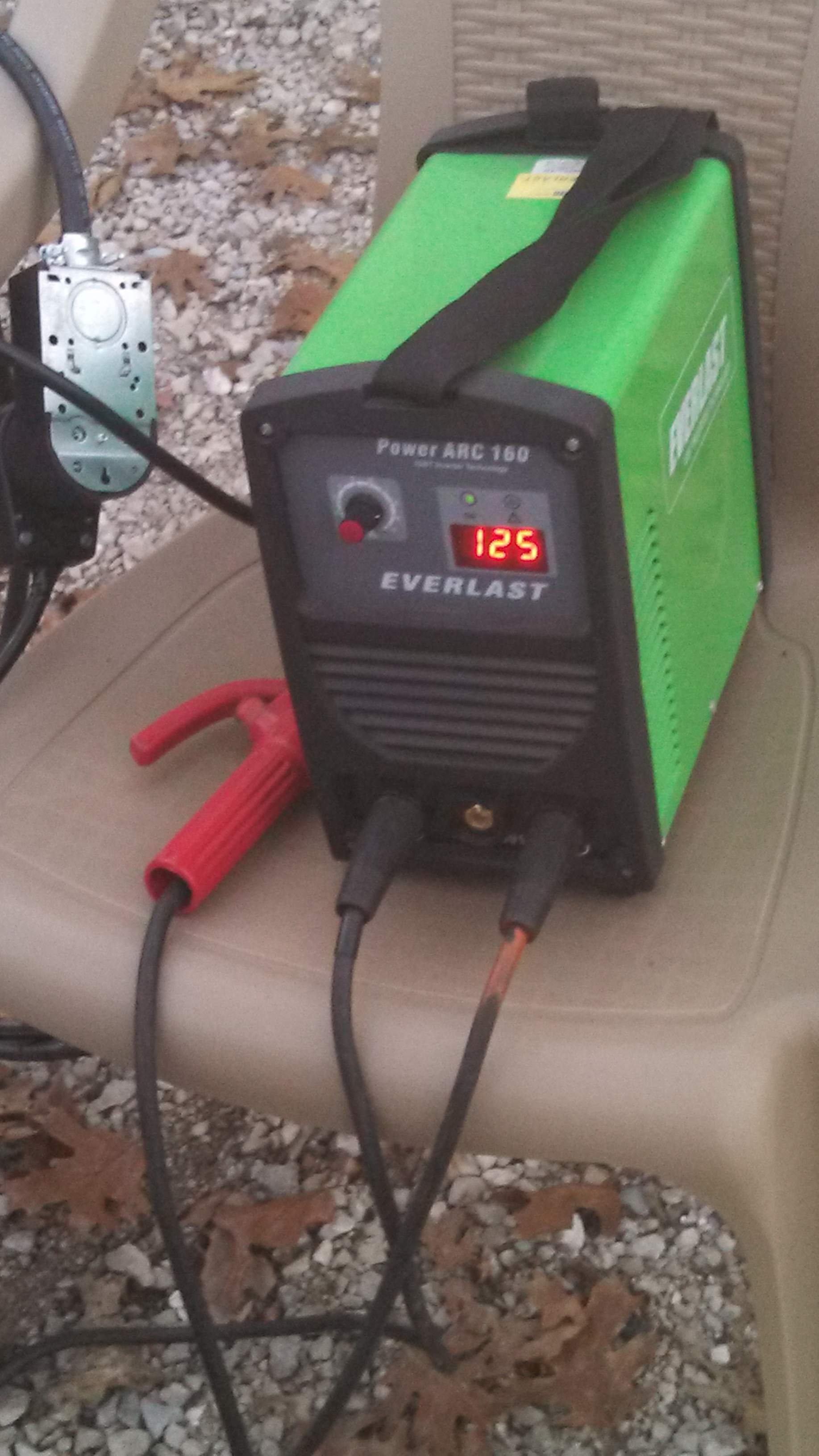

Can't help you much with you MIG, I have less than 10 minutes on a MIG, my experience is with Stick and TIG. My little Everlast 160 does really well. It has paid for itself many times over. And makes beautiful welds with 7018. One of the best purchases I ever made.

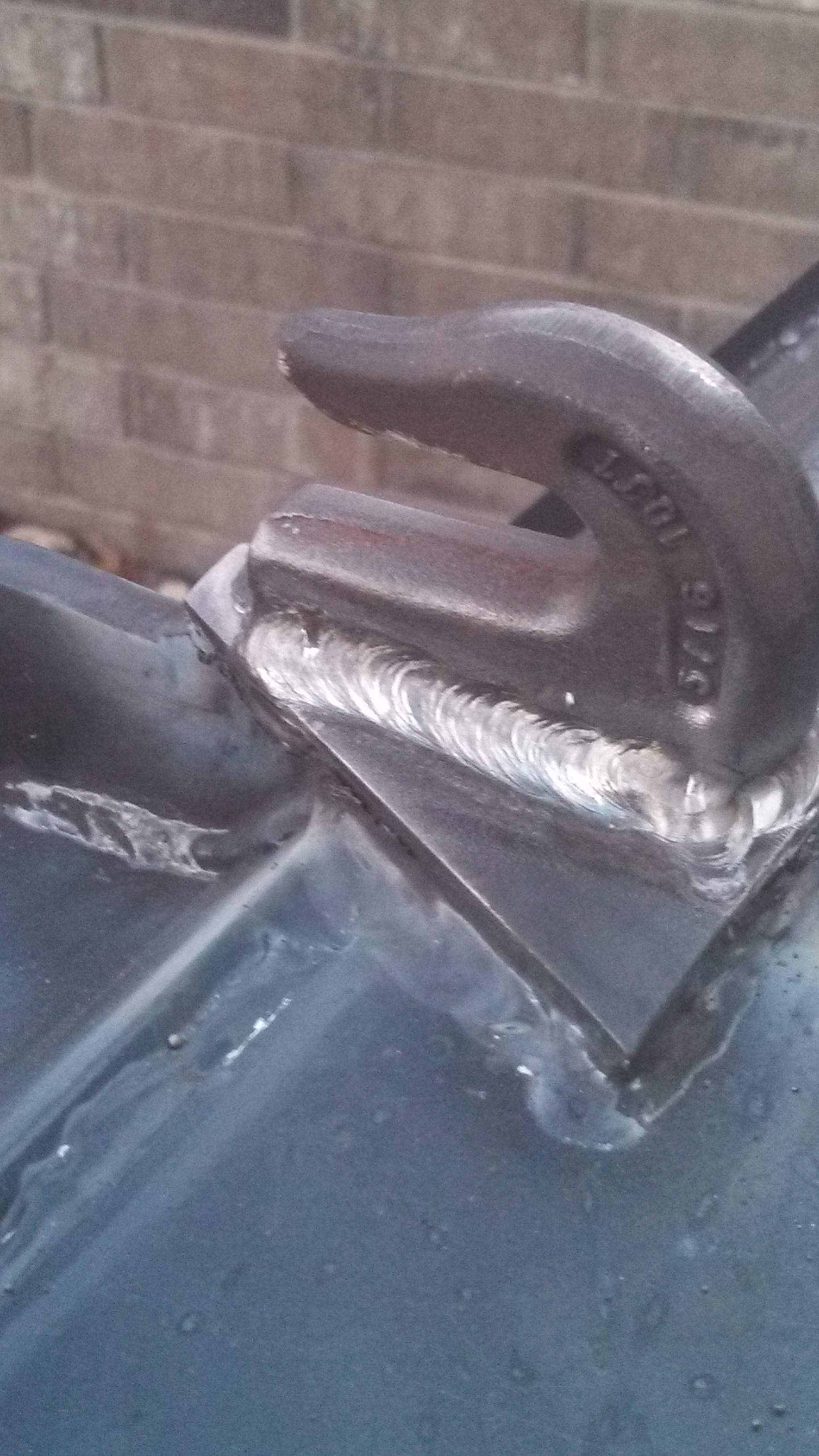

Unfortunately, I had thrown a coat of paint on it to hide the evidence.
One possible problem may have been surface contamination. The angle iron had been painted, and I thought when my friend welded together the frame for me, the paint had been burned off and I wire brushed it.
BUT, in general, even when stick AC welding, I ALWAYS tend to use too much filler. You need to stay in one spot for good penetration, but then the filler accumulates, no? Am I missing something?

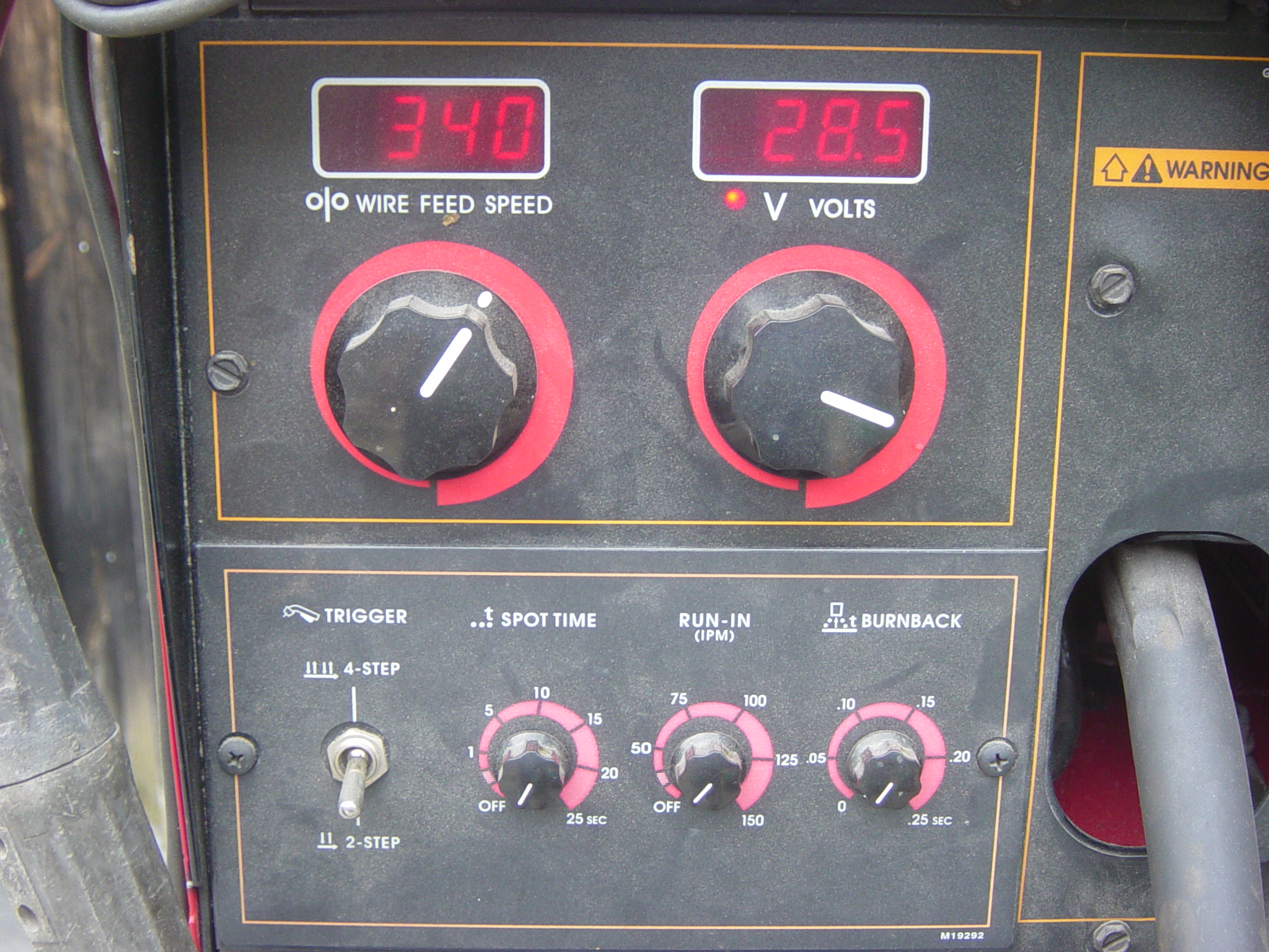

Interesting youtube video, although I know most of that stuff. When I turn my gas up too high, I get black soot all over my work. He curiously didn't get that on his demonstration or explanation.
   / I can Weld, I can't weld, I can Weld, This is getting very frustrating. #15
That voltage at 28.5 you are on the verge of going into spray transfer i bet it spatters like crazy too. Im assuming you are using C25 argon CO2 mix, if so i'd roll that voltage down to around 20 give or take a half a volt and then set the wire feed at 230 or so and fine tune the feed until you get the bead you want. if your feed is too high you'll feel it stubbing into the puddle, if its too slow it will sputter and pop. Just my two cents but there are a bunch of online setting calculators that you can get that are very useful. Miller has a bunch you can load onto your phone that will put you into the ballpark if you know your material and wire type and shielding gas and then its just a matter of experience to find the sweet spot for your machine. Remember if you're running a flux core wire you want to go to electrode negative polarity and if you are running solid wire with shielding gas you want it electrode positive.

Thanks. It just seems to me that at lower settings the machine just doesn't have enough heat for penetration. Not for 3/16 steel.

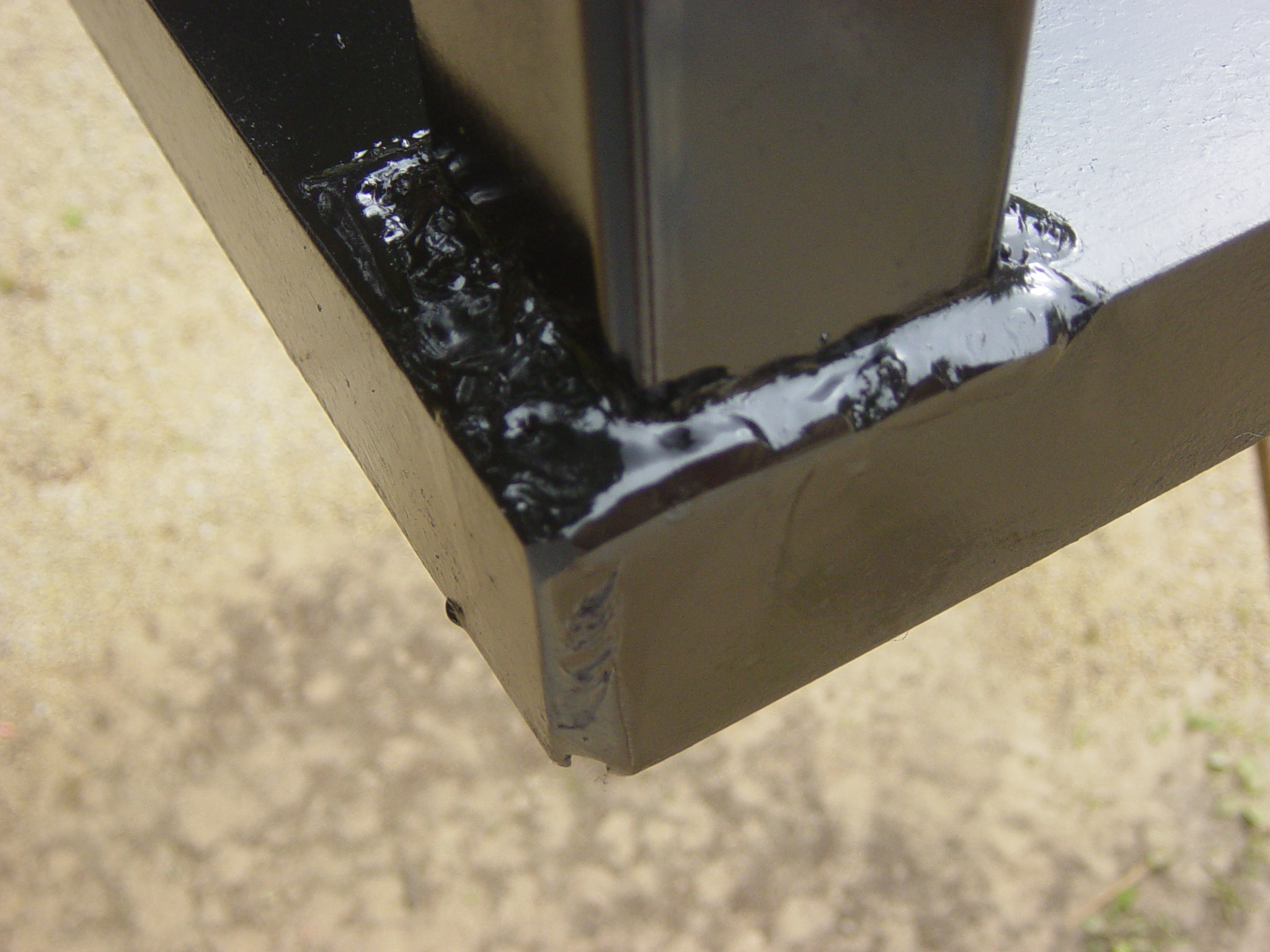

View attachment 617951View attachment 617952
I could never stand to wear boxers. lol Those hybrid things aren't too bad.
Voltage controls bead profile, not penetration.
Wire feed speed is your amperage and controls penetration (depth of fusion).
For a given wire feed speed, more volts flattens and widens the bead. But does not increase penetration.
But, volts too high gives erratic arc, excess spatter.
Volts too low and wire stubs into base metal and gives tall ropey looking bead.
Correct volts will be between.
Yeah... Got reminded of that other day, was really hot and I was tired and not thinking really well and was getting a ropy bead and finally realized I need more voltage, cranked selector switch one step higher, and guess what, weld was a lot better....
Anybody can argue against preparation, but I find it really helps and machine parameters, yes proper setup there helps too.... Lastly what the weld is really about is skill of person behind the MIG gun (or stick) ...
Several thing that improve weld is seeing what arc is actually doing, if that means cheater lenses in hood so be it (I have a 1 diopter and 2 diopter doubled up) and lot of ambient light on area where welding (headlight on helmet).... And some will laugh but on something like a butt weld, highlight weld line with paint stick....
