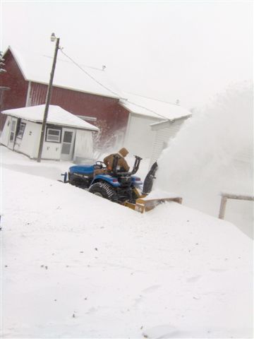

I have no problem at all plowing or blowing snow with turfs. It is used on the yard because that 72" belly mower works great. I have a 5' tiller I use, no problem. If you are driving over stumps and rocks, the r4's are good because they are tough. Search the net for people cutting sipes in their r4 tires to help on packed snow and ice. snowblower1.jpg

Those old diamond turfs is exactly what was on my Cub when I bought it. And from your picture I can tell your turfs gotta be magic! Haha! I'm sorry for comparing the two. But don't mow with a tractor anymore. I blaze across my yard at 12mph on my Exmark mower. So turf tires are a no for sure.
Thanks for the reading. The one thing I was worried about with R4 tires, was performance in the snow. Sipping R4 tires for the snow might be the way to go.
