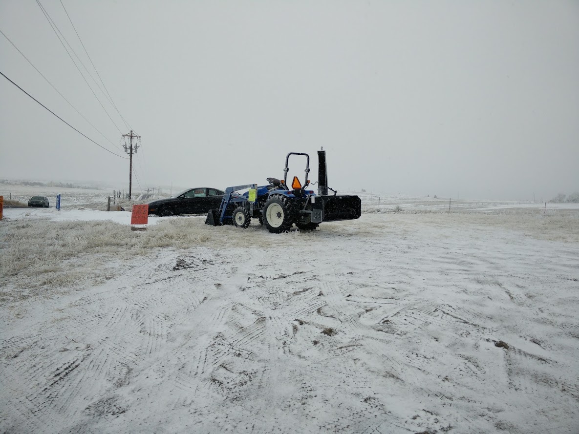

Well, my plans of finding a cheap blower this summer were derailed on Thanksgiving. On the way to a friends place I found a nice 61" sitting in a field with a for sale sign. The guy didn't want to fire up the tractor while it was this cold, but we agreed on $800, which is better than I've seen in the past year at least keeping an eye on Craigslist. Might have to put a few inches of wings on it or something if I do get the wheel spacers, but it was to good of a deal to turn down. Will be picking it up either today or this weekend. Currently 14f out so I'm not too motivated, as likely is the guy that is selling it.

$800 for a working 61" blower sounds good. The picture is from a distance but it looks good. I bought one for less but I had a lot of rust to cleanup and then paint.
Good find. My only question would be why he wouldn't keep it.
