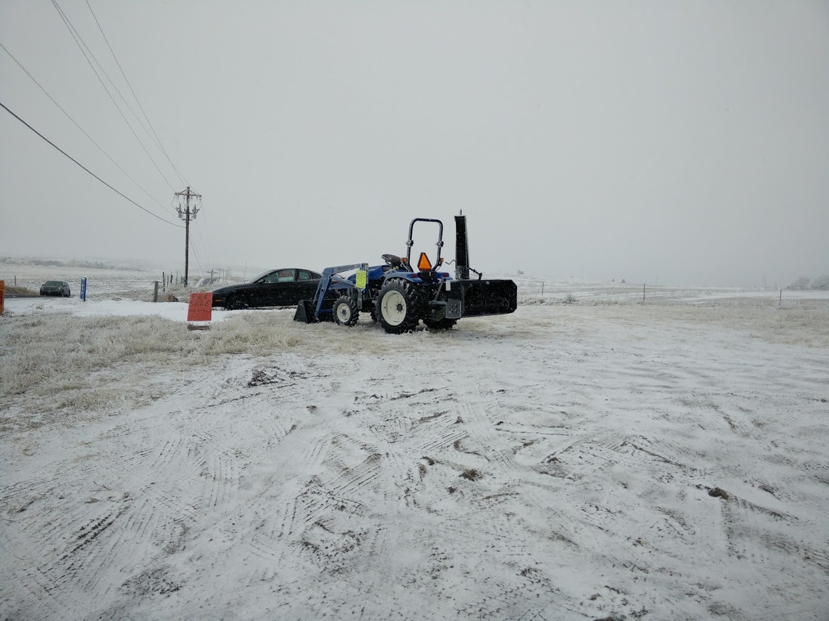

Well, my plans of finding a cheap blower this summer were derailed on Thanksgiving. On the way to a friends place I found a nice 61" sitting in a field with a for sale sign. The guy didn't want to fire up the tractor while it was this cold, but we agreed on $800, which is better than I've seen in the past year at least keeping an eye on Craigslist. Might have to put a few inches of wings on it or something if I do get the wheel spacers, but it was to good of a deal to turn down. Will be picking it up either today or this weekend. Currently 14f out so I'm not too motivated, as likely is the guy that is selling it.

Blower is now torn apart. Welded on plates to the side of the toplink & cit out the bar under the hole so my quick hitch top hook would fit. A little heat & a sledge hammer persuaded the outside of the clevis hitch for the lift pins to shrink 1/2" so my quick hitch will fit outside. Just need to fond some 3/8" x 2" bar stock to add another pair of ears outside the quick hitch.
Toplink to lift link height was fine, just needed it a fair bit wider to be quick hitch compliant. 1 evening into it so far & another to go. So not to bad for a fun little project.

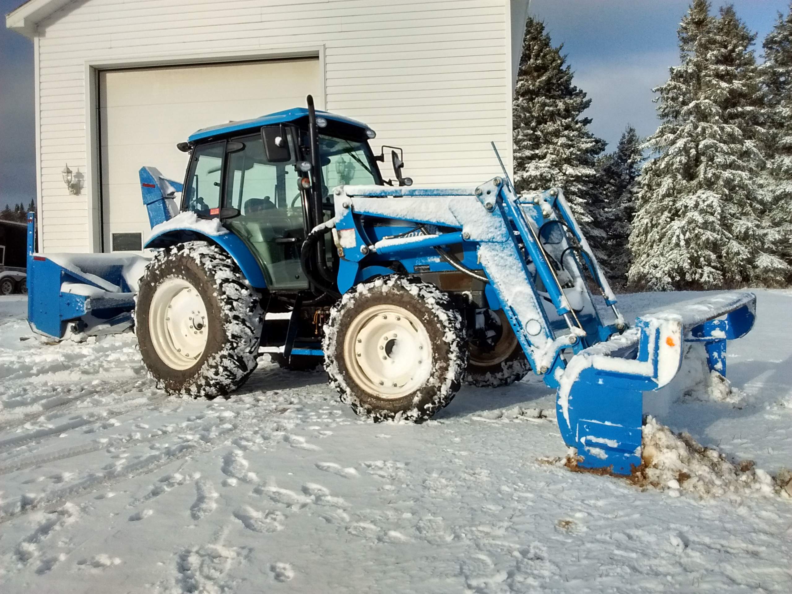

My tirechain.com 2 link Vbars for the fronts came in & got mounted after my first attempt at plowing today. They increased my plowing capacity at least 30% & I can now turn while plowing with a decent pile infront. I'm now noticeably power limited. Used the blower a bit & it kicked *** (other than getting dusted bad when I had to blow into the wind), but mostly plowed. Very happy with this setup... Except for the fact I don't have a cab. :p
I know the chains will put a bit more strain on the front axle, but I don't think it's that bad or is likely to cause problems. While they do add a lot of traction I still have a lot less traction than trying to dig up a bucket full of dirt at a pile, which I'm betting puts a lot more load & stress on the front axle. Probably not pursuing wheel spacers for my rear tires at this point.
