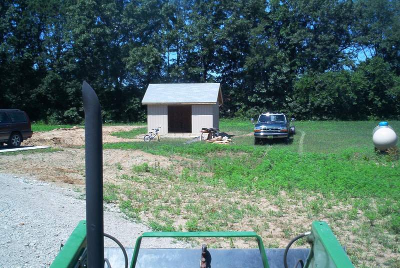

</font><font color="blue" class="small">( .... Shingling is next but that will have to wait a week or two /forums/images/graemlins/smile.gif )</font>

Hey, thanks for the encouragement Bill. I had intended to get the tarpaper up tonight but got into a side project instead (see photos forum). I've got the tarpaper and drip edge so hopefully tomorrow night. No rain in the immediate forecast but our next couple of weekends are already booked solid.
I've heard that the drip edge goes under the tarpaper at the lower edges but on top along the rakes. Does this make sense? I also read about using a starter strip of shingles along the rakes in addition to the lower eave. How did you handle those details? /forums/images/graemlins/smile.gif

Yes, that is the way I did it. You want any water that might get under the shingles to run over top of the drip edge, not under it.
The starter course of shingles is simply a row of shingles with the tabs cut off. These are nailed down at the roof edge, through the drip edge. The exposed shingles then have something to stick to. under the tabs there is some stuff that causes the tabs to stick to the shingle below, if I remember right.
When you first put the drip edge under the tar paper, you don't use many nails, because you will be nailing that first row of shingles [with the tabs cut off] through the drip edge, and those nails will hold the drip edge secure.
Actually, the side drip edges are held on by nails at the ends of the shingles as well, so you only need a couple nails in those pieces as well at the start.
I did not use any shingles under the exposed ones, except for the lower edge. The wrapping on the bundles of shingles tells you how they recommend to do it. I just followed those instructions.
Hope this helps!
