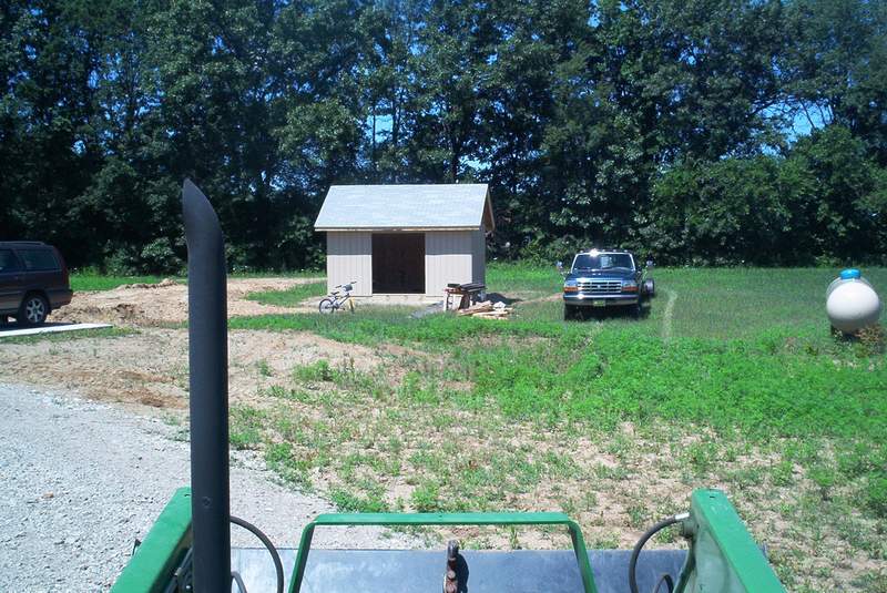

I've been working away at the barn, but not as diligent as Spencer and Henro in the picture taking department. I got the shingles finished and the siding up this weekend. I used SmartPanel siding as opposed to straight T111. This stuff is about the same but it came pre-primed with a 30 year warranty. Only a couple of dollars more per sheet.
Here's a shot from my tractor. Yet to finish the sliding doors, trim and paint. Someday, it will need a cupola and a rooster weathervane, but that may just have to wait /forums/images/graemlins/smile.gif

Looks good, Rob...

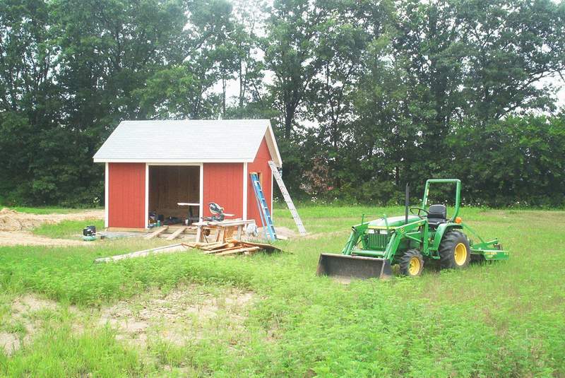

Once again, my skills as a photo-journalist lag well behind Spencer and Henro, but at least I remembered a couple. Here is the barn painted and ready for doors. Had to have the tractor in the shot since this is a tractor board, right /forums/images/graemlins/smile.gif

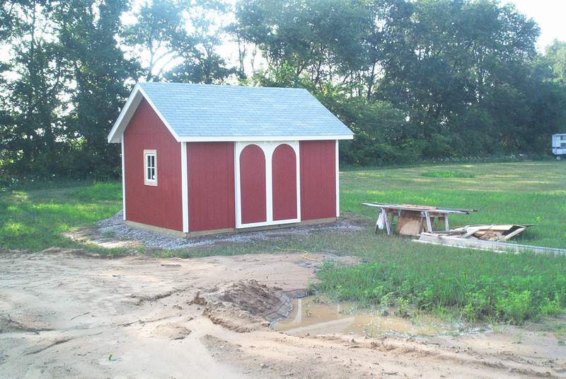

And here is the finished product. It is loosely patterned after a barn not far from us dating to the late 1800s. Of course, ours is much smaller but it will be just the ticket to de-clutter the garage. Too small for my 790 but the lawn tractor will fit well.
The sliding doors proved to be a bigger challenge than what I planned. The hardware mounts to the door face but with the trim our doors are thicker than what they designed for. I had to shim the track out from the wall an equal thickness. The doors slide nicely but I still need to come up with a latch/lock system of some sort. Also need to put plywood in the loft area and a ladder for the kids. I promised them a loft and they haven't forgotten that /forums/images/graemlins/smile.gif

Very, very, very nice!!!! /forums/images/graemlins/cool.gif /forums/images/graemlins/cool.gif

My, My RobS...
Finished already?
Man, do I wish I could say "I feel like RobS junior... /forums/images/graemlins/smile.gif"
Unfortunatley...still got a bit to do yet... /forums/images/graemlins/blush.gif
Glad to see it came together so well.
