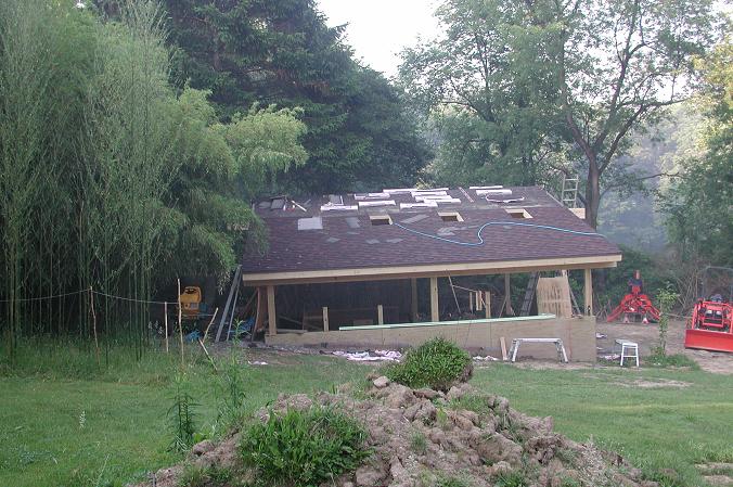

I think this shot was taken on the morning of the third day. On the second and third days I stayed off the roof from about 2 to 7 pm...did other things...too miserable under the clear blue sky and 90 degree hot sun temps...
Holes for the lower four skylights are cut out and the first is in place dew covered...

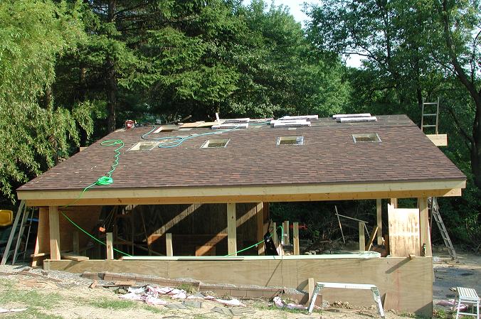

Towards the end of the third day. The day ended with the holes for the top four skylights cut out but none of the skylights in place yet.
This side of the shed faces almost due North, so you can get an idea of the time by the slope of the sun beams on the wall inside the shed...coming in throught the skylights

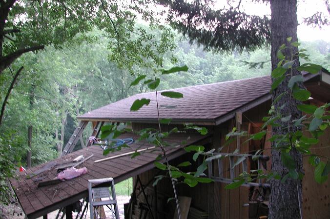

The 8x16 foot section of the original roof on the back. I was going to shingle over it, but just knew that if I did I would regret it, as there were be a hump at the transion between new and old.
I wanted to avoid the work of ripping off the shingles and disposing of them...but in the end I saw no way to do a good job and leave them on...glad I bought one of those shovels for ripping shingls off. Still took a while, but it was in the shade and pretty easy with that shovel!

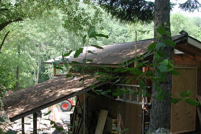

Looks better already. Glad I had an extra roll of tar paper.
At this point I was sure I had made the right decision...
