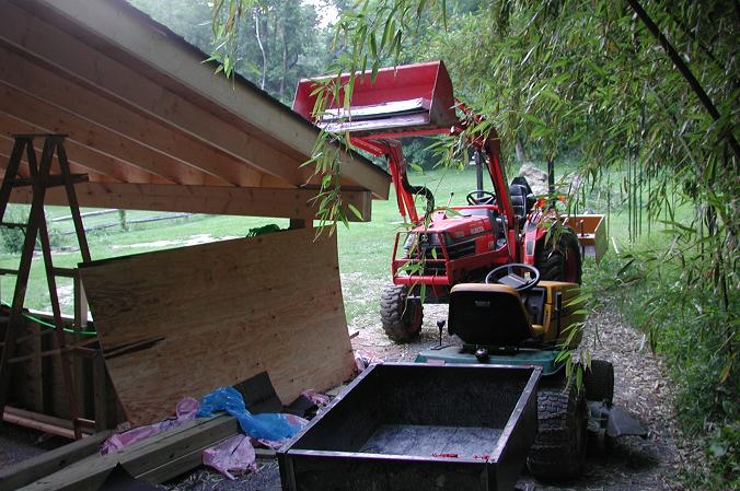

What goes up easy comes down easy...2 bundles extra of shingles.
Except for picking them up on the far end of the roof, and carrying them over to the loader bucket!
Believe me, at the end of a 13+ non stop day, they felt at least four times as heavy as they did when my brother and I shared the load...

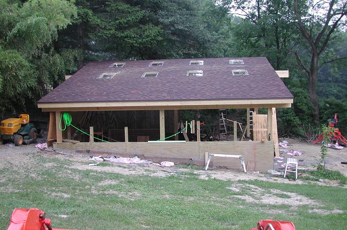

The finished roof. Just in tiime...rained last night.
Well, the 30 lb tar paper was keeping the rain out anyway, but it is always a great feeling to get a roof on!

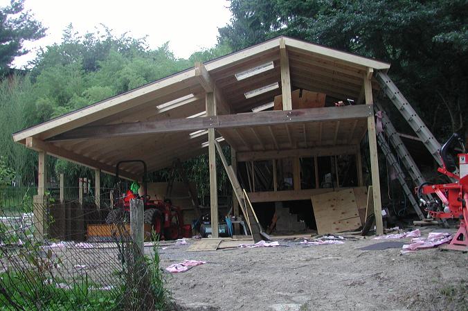

#183
Final shot at the end of the day yesterday showing the position of the skylights.
Four are over the open area where the tractor and stuff will be, and the high four ones are over the part that will have windowless walls and doors, and be a secure, lockable area.
From this point there will be many small jobs to do...I'll post a picture now and then if there is anything of interest or some "major" progress occurs...
Today is a declared day of rest...guess I'll take a break and clean up some of the trash I threw off the roof!

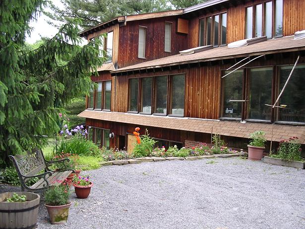

<font color="blue"> Bill, I reckon that's about the biggest sundial I've ever seen. </font>
Bird...That's funny. But there is one bigger...our house faces due South, and I set the angles using the shadow of a vertical post at solar noon. So the sun through the skylights does give a pretty exact time indication...or course, where we are located solar noon is about 30 minutes different from local time...
I cover the three skylights over the living room with something every Summer to keep the heat down. In winter they let the "Winter heat" in on sunny days.

Never quite understood why skylights are a good idea.... "you want to put a hole in my what?" -- not in my buildings or my cars .. just someplace to leak i figger. and the heat load they cause here in Tex is outrageous!
I did look at "solar tubes" with a little interest - but it's still an unwanted hole in my roof.

<font color="blue"> Never quite understood why skylights are a good idea.... </font>
mikim,
Depends on how much you like bright spaces. A skylight can make an amazing difference. In my case I like bright spaces. So...even in my home, which has a lot of large south-facing windows, we have three 4x4 skylights over the living room.
In the summer I cover them to keep the heat down, and it feels dark for a while until we readjust to the lower, but still bright light level.
I am with you on the holes in the roof idea though...I built my own skylights in the house and they don't leak...but I don't think good store bought ones will leak either...
On the shed I am happy that I put them in too...but that is just me.
