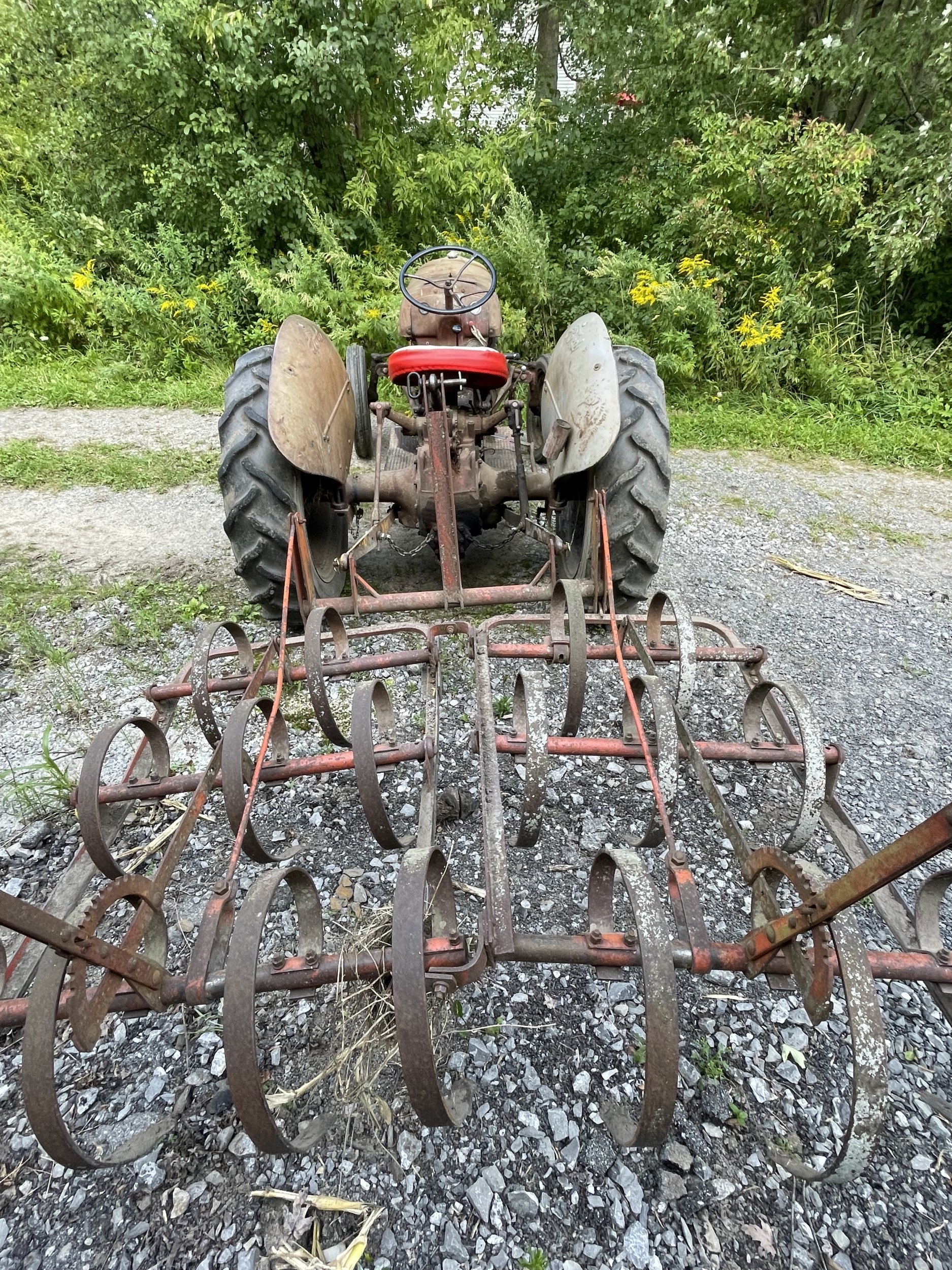

If I were to add them up, I suppose I’d have a dozen or so, category 1 3-point implements. I have (2) tractors with 3-point hitches, one mid sized and one large. Keeping the implements on level ground makes changes relatively easy, especially with the mid sized tractor.
My mid sized tractor is a 1951 Ford 8n, which is the most refined form of the tractor that first brought the 3-point hitch to the masses, back in 1939. That thing is so damned easy to change implements on, that I find myself using it for most tasks that require changes. The tractor is very easily rolled by hand on level ground, by reaching up and grabbing a rear tire lug, so I just got to get “close” when changing implements.
It seems to me that all make/models of tractors developed since then have been a step backwards in terms of ease of changing 3-point implements. It’s almost like Henry Ford and Harry Ferguson teamed up, to make the perfect design back in the 1930’s, and folks have been screwing it up ever since. I usually keep a hammer on a bracket on the rear fenders of both 3-point tractors, and that helps get the pins in and out.
A PTO hookup adds additional complexity to the changes. The only PTO driven 3-point inplement I have now is my Bush-hog and that stays on my larger tractor about 75 % of the time. I only take it off in the winter, when it gets exchanged for a rear snowplow, and in late spring when it comes off, so I can use that tractor on a pull-type disk.
(Ive yet to see any 3-point disk that I’ve thought was worth more than its weight in scrap metal).
