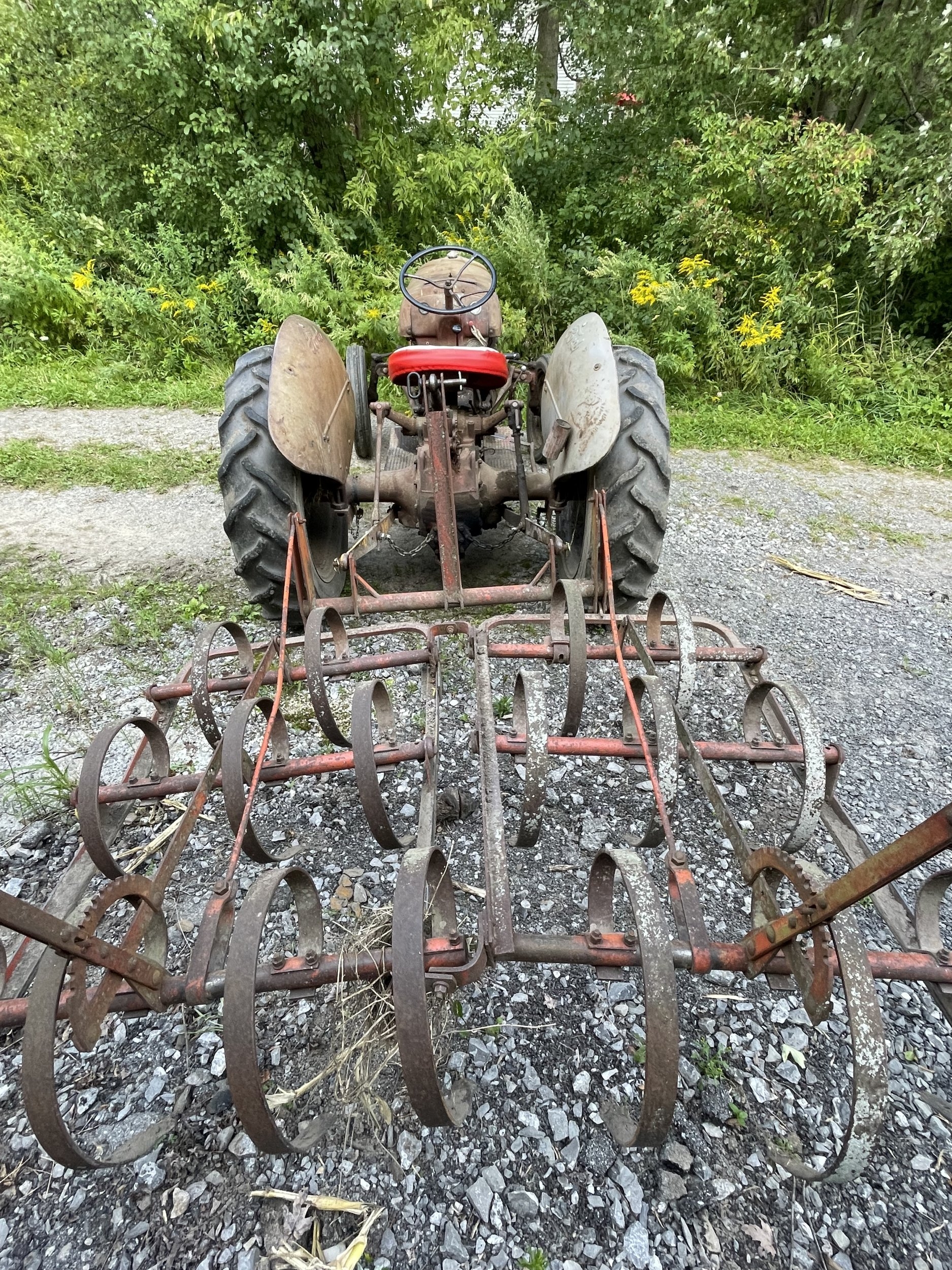

If I were to add them up, I suppose I’d have a dozen or so, category 1 3-point implements. I have (2) tractors with 3-point hitches, one mid sized and one large. Keeping the implements on level ground makes changes relatively easy, especially with the mid sized tractor.
My mid sized tractor is a 1951 Ford 8n, which is the most refined form of the tractor that first brought the 3-point hitch to the masses, back in 1939. That thing is so damned easy to change implements on, that I find myself using it for most tasks that require changes. The tractor is very easily rolled by hand on level ground, by reaching up and grabbing a rear tire lug, so I just got to get “close” when changing implements.
It seems to me that all make/models of tractors developed since then have been a step backwards in terms of ease of changing 3-point implements. It’s almost like Henry Ford and Harry Ferguson teamed up, to make the perfect design back in the 1930’s, and folks have been screwing it up ever since. I usually keep a hammer on a bracket on the rear fenders of both 3-point tractors, and that helps get the pins in and out.
A PTO hookup adds additional complexity to the changes. The only PTO driven 3-point inplement I have now is my Bush-hog and that stays on my larger tractor about 75 % of the time. I only take it off in the winter, when it gets exchanged for a rear snowplow, and in late spring when it comes off, so I can use that tractor on a pull-type disk.
(Ive yet to see any 3-point disk that I’ve thought was worth more than its weight in scrap metal).

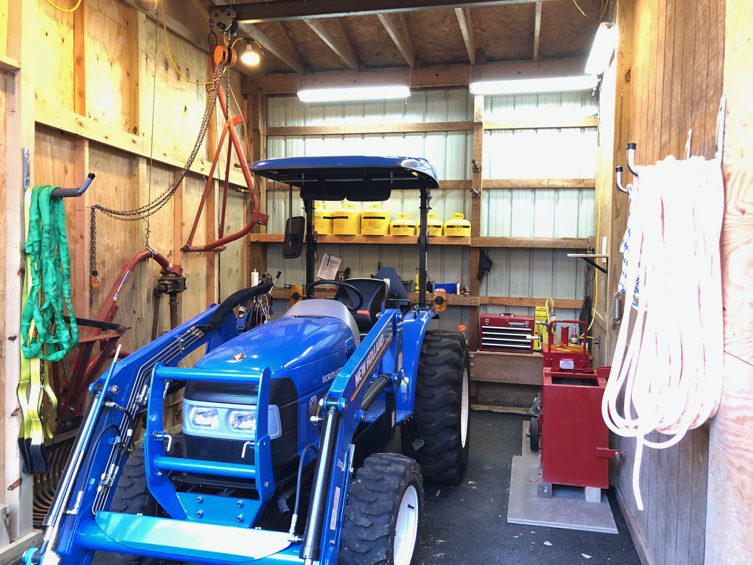

All mine are category 1, but my back isn't even cat 0 anymore. Maybe if they were titanium I could wrestle them, but the only titanium I have to work with is holding my head on my neck.
So, I keep all my implements in the barn where the tractor is, and I have a trolley on an I beam with a chain hoist. Some of the implements I had to add an eye bolt or eye nut so that they could hang from the hoist in a reasonable mounting posture. Even my boom pole, which probably only weighs 60 lbs, I handle this way, and stow with blocks and rope holding it up against the wall. It's rare I lift more than 20 lbs. Oh, sure, in the halcyon days of youth, I did, but not any more!
If you don't mind, would you post a picture of this setup? It's not something I'm about to copy, but the idea sounds really inventive.
   / I feel stupid #18
Here is an overview. The I beam is partly visible at the top edge, with the orange chain hoist. My auger hanging from a stationary cable, my boom pole hanging from blocks and tackle, and my landscape rake just leaning on the wall, are all visible on the left. My counterweight is on the right.
The I beam only allows side to side movement. The tractor, of course, moves forwards and backwards, to give me the other dimension of alignment. The heaviest attachments live directly under the ends of the I beam, and the lighter ones are close so I can move them around using the hoist plus little ratcheting chain hoists.
   / I feel stupid #19
Here's a detail of the counterweight, my heaviest attachment, off the tractor but ready to be mounted. I've hooked the eye nut with the hoist, and have added a spring. Without the spring, the trolley lurches as I try to move the assembly sideways, and it's a little scary. Without any deliberate springiness in the system, the tension on the chain gets very big. The static lift capacity is more than enough, but these shocks may be a different story. The spring takes away the shocks.
Note also a little of the adapter plate for mounting 3PT implements on my FEL, peeking out from the top right corner. It's not terribly heavy, and I can manage it with the chain hoist even though it is not directly under the I beam.
