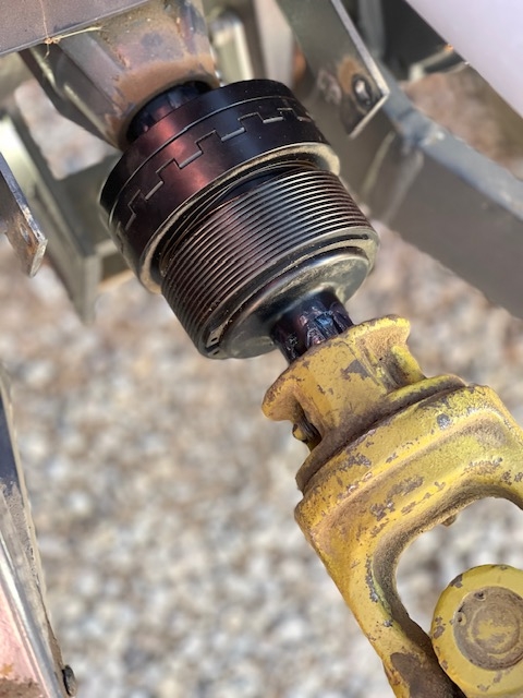

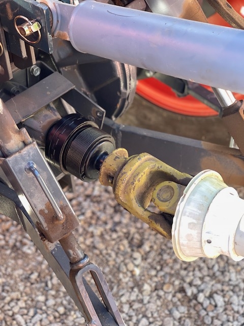

I wrap a chain under the PTO shaft before I disconnect it. It holds the shaft up out of the dirt and when I go to reconnect the shaft is always close to the right height minimizing the effort needed to couple. I also use a PTO quick connect coupler. A bit pricey but worth it IMHO
