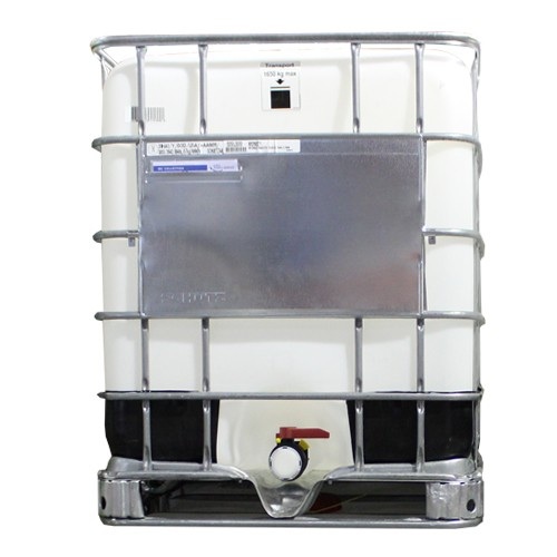

image.jpgI don't see any reason why you couldn't carry four 250 gallon totes on a deck over trailer. 1000 gallons of water weighs 8,345 lbs. I would not hesitate to haul that in 4 totes on a deck over trailer. Now if your talking a single tank that's a different story because liquid crawlers up the sides and surges from back to front and back again. If the water is for human consumption then you can not use a baffled tank. If you are purchasing a trailer for multiple use then 4 food grade poly tanks makes perfect sense. This should eliminate most of the effects of liquid surge and simplify the ability to remove the tanks to use the trailer for different applications. Depending on the tractor you could even off load a full tote, it would certainly be no problem for a fork lift at just over 2000 lbs a tote.
These totes are $240 each new but this is how I would transport food grade water in a domestic setting on a deck over trailer.
http://www.airseacontainers.com/275-gallon-poly-plastic-tote-food-grade.html#page=page-1
