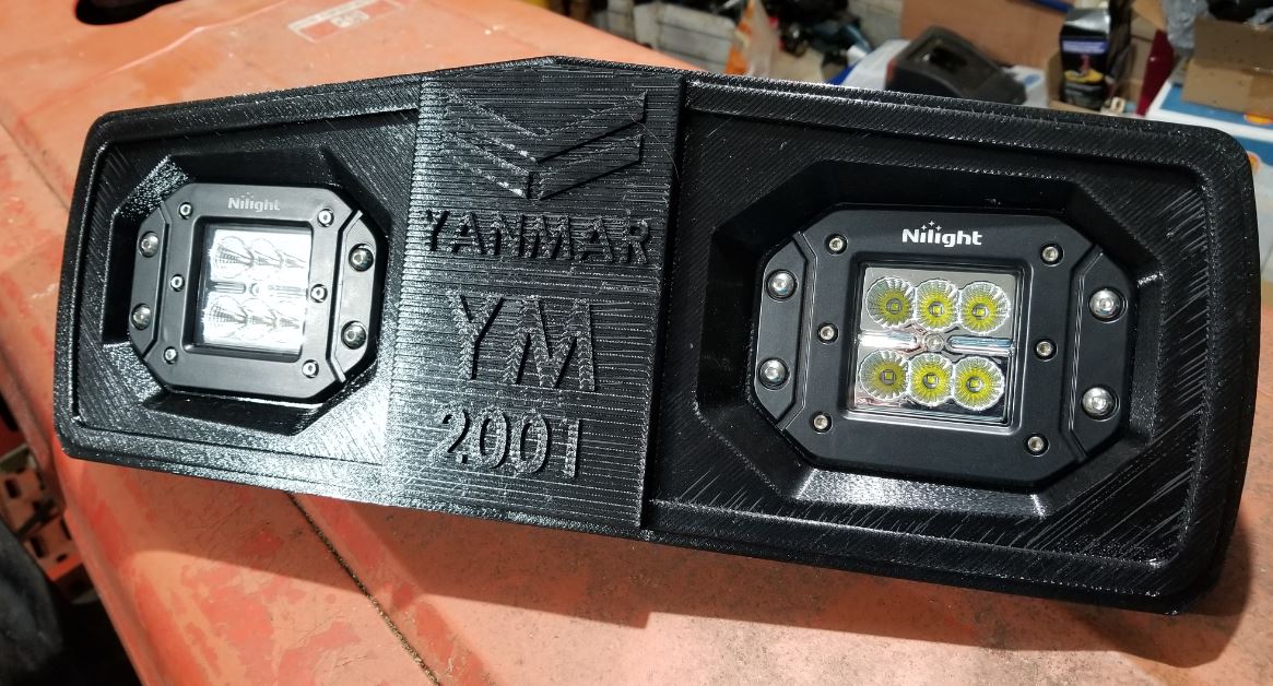

My lights have never worked, so I have a plan to repair the wiring and change a few things around. I feel that turn signals are not needed so I will be changing them to hazard lights. I have already removed my broken turn signal switch and 3D printed an adapter for a pull style switch.
I also plan on 3D printing a headlight shroud for holding a set of flush mount LED lights. The preview of it is below. I still have to split it into 3 pieces so that I can fit it on my 3D printer.
I am also installing an LED work light for the rear.

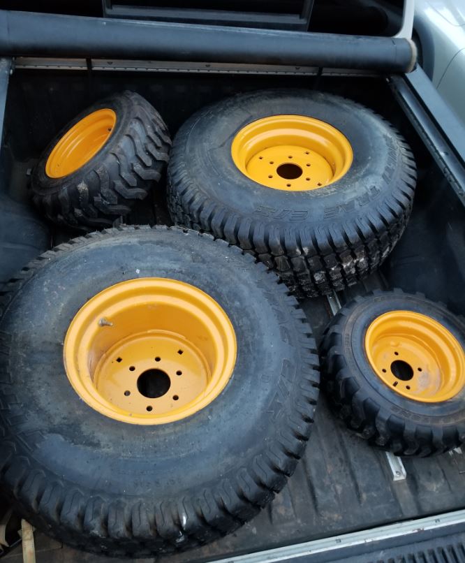

I seat stubborn beads using a ~2-1/2" wide heavy-duty (10k# rated?) ratchet load strap wrapped around the center of the tread ... crank it down, squash the center of the tread, the bead spreads to contact the (lubed) rim all around, remove the valve-stem core, use a standard 30-gallon compressor with clamp-on valve-chuck to seat it from a distance. Deflate and remove the strap.
Lotsa uses for that ratchet-strap between the rare tire-changes ;)
Hey duane - nice looking tractor (and tires/wheels)! Congrats!
I tried that method as well. It works great for car tires but does not work well for these turf tires. The tires compress and buckle without pushing the bead against the rim. I think one of the main problems is that the rims do not have a good lead in on one side like most car rims do. That lead in is usually used to help hold one bead while you pull the tire the other direction to seal against the other bead.
And thank you.

Must admit I like the yellow wheels you found, mine's gonna be sporting that combination soon - yellow is my default 'personal fleet' color but I'm (barely) resisting the urge to shoot the whole tractor yellow, so 2-tone red/yellow it will be.
/ I finally got a Yanmar (YM2001)
#46
I am not sure that I am sold on the yellow wheels. I will probably keep them yellow because I do not feel like painting them. I was told that they are Yanmar wheels so I am pretty sure they are Cub Cadet Yanmar wheels.

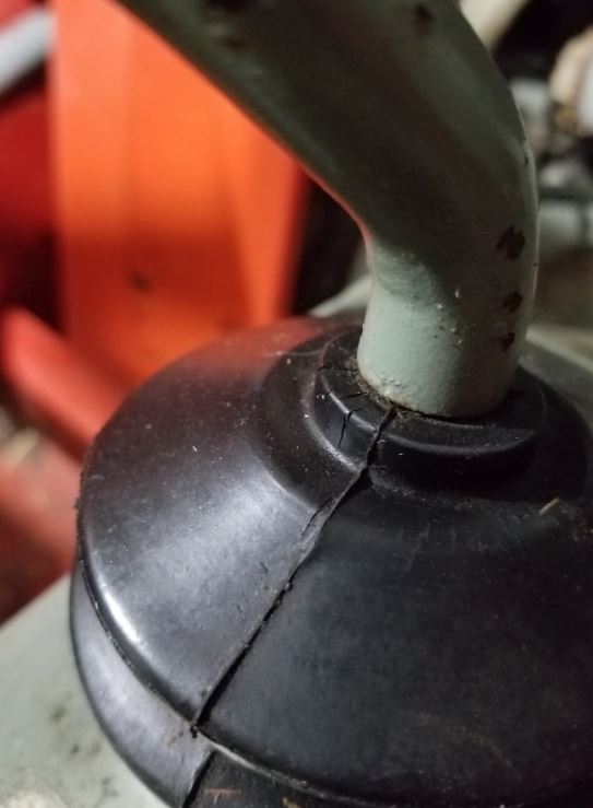

How do you guys keep the shifter boots from cracking? My first set of replacements lasted 6 months before they had cracks and allowed moisture into the transmission. I have been putting Aerospace 303 protectant on the second set, and it has been helping, but there are still cracks forming after a year. These are not stored in the sun.
I do have my tractor covered, but it is more of a lean-to so moisture can blow in in strong winds.
I have an idea that I am working on using some of my 3D printing skills and will show it in a bit.

Here is a picture of one of my current ones. I looked back and I did order these from Hoye as well. I ordered them in September 2017. You can see the crack along the top starting to form. These with protectant on them have lasted much longer than the first ones.

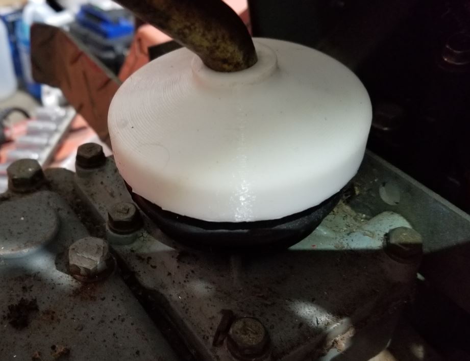

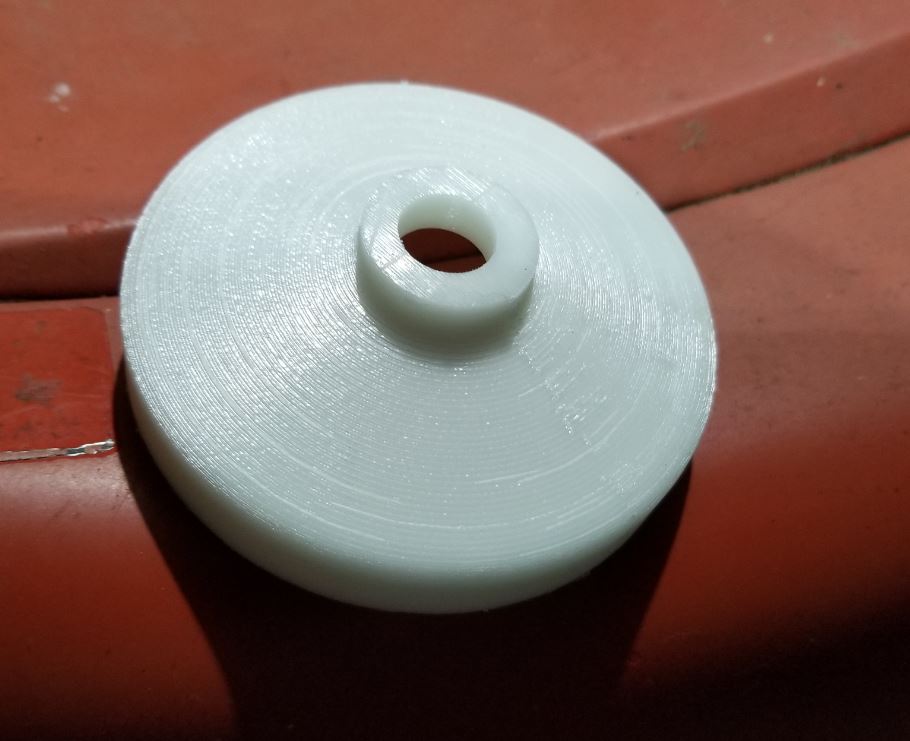

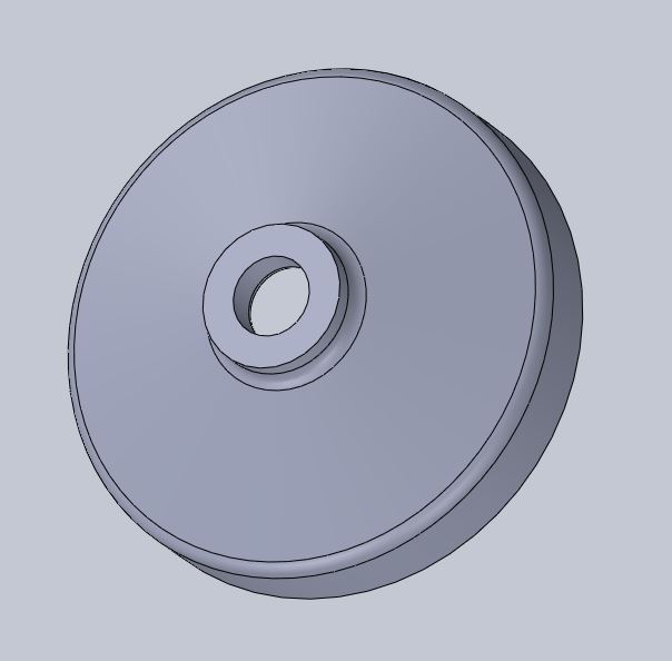

I an using some different information that I cobbled together from the internet to make silicone molds for a cover for the boots. It started from making a silicone boot for my hot end for my 3D printer. Instructions for making the mold was on thingiverse. I also learned more about intristing uses for silicone here:
How to Make Your Own Sugru Substitute: 15 Steps (with Pictures)
I used this information to make 3D printed molds for different items at work and now a few for my tractor. On the first item that I made (hot end boot), I did not use the cornstarch and it took quite a while to set up and required mold release (Vaseline). With the cornstarch the silicone does not stick to much anymore and does not require mold release. It also sets up firm enough to remove from the mold in 30 minutes or so.
The silicone that I use is claimed to be weatherproof so it should last a long time.
I have also made a similar boot to put on the steering shaft to try to keep moisture from entering the steering box.

TEASER
I hooked these up briefly and they are super bright!
