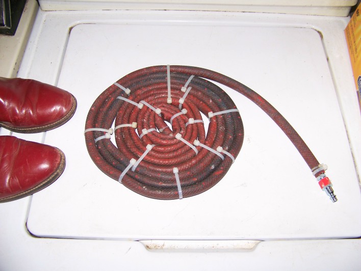

I have made an air diffuser out of scrap airhose. It is about 10 feet long and coiled and ty wrapped. Numerous #40 drill bit holes are in it. I will secure this in a weighted bucket and lower it to the bottom of the pond. The homemade air diffuser is saving me $50 and up. I made one of these years ago, at work, and still use it in hot, confined spaces of the aircraft for cooling.
I plan on running it at about 5 psi from my barn's air compressor. So I will bury the line for about 170 feet, run it up through my overflow pipe (which goes under my driveway and dam) and down to a depth of 11.5 feet.
My question is should I bury 170 feet of regular air hose inside 1 inch poly pipe (http://www.tractorsupply.com/home-i...lene-flexible-coil-pipe-1-in-x-100-ft-3151664 Tractor Supply Company) from Tractor Supply, or just run 1/2 inch poly pipe (rated to 100 psi) and just pressurize just the 1/2 inch pipe?

My vote is poly only. I think poly and a hose (Pollyanna hose ;)) is overdoing it.

Jim,
I agree. Keep it simple.

Use 1" poly & you can add the hose later if you like...
Defective,
That is a darn good idea. I do have doubts of running air hose in already buried pipe. It might be too hard to do. I will go to TSC and check out their poly pipe connections to see if is easy to go from 1 inch poly pipe to air hose connections. I will just have to play around with it.
First I gotta play with the air diffuser in the pond this Saturday.
hugs, Brandi

Is the possibility of oil mist contamination in the air from the compressor going to be a problem?
