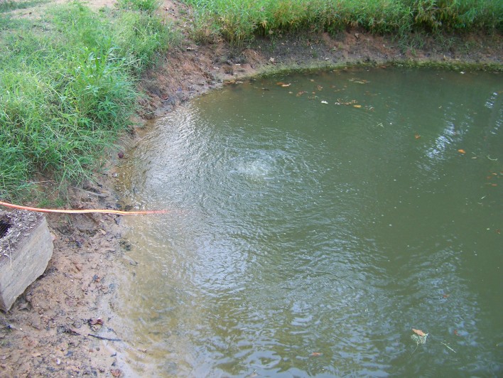

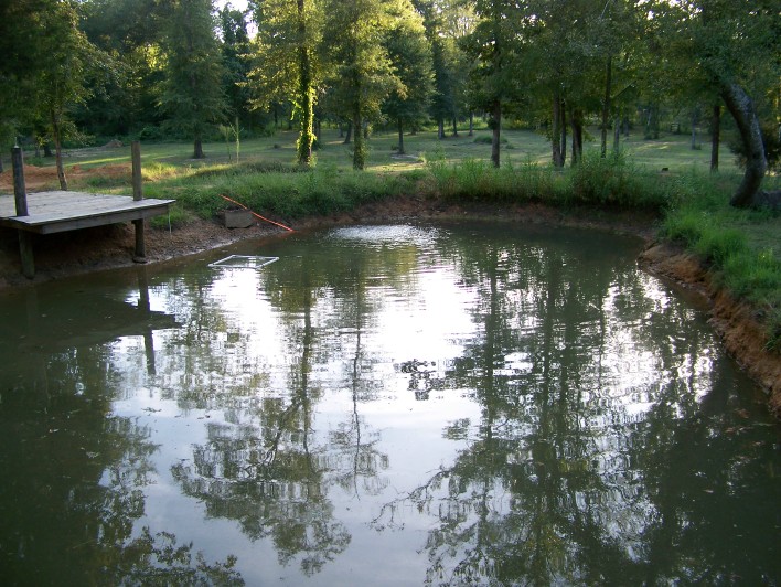

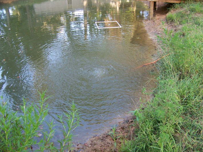

Luke and Terry helped me get them in the pond. Later, Luke ran airhoses out to the pond from the barn and we dropped the homemade:thumbsup: air diffuser tywrapped to a stone laden bucket down to the bottom. I bought a low pressure regulator to cut the air pressure down to about 5 PSI, but the needle now sits on about 0 or 1 psi. I set the pressure by trial and error by watching the bubbles. The 60 gallon tank on the air compressor takes about an hour before the compressor motor kicks on.
As the photos show the bubbles really move the water. I like the last photo best.:)

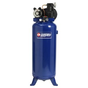

My compressor is a 60 gallon 240 volt Campbell Hausfeld. It is brand new. Do you think it is putting enough oil in 250 feet of airhose to hurt the fish?

Does it have motor separate that has a belt driving a pulley on the compressor? I think that may be one that does have pistons and there would be some oil, more as it gets older. I doubt that if it is relatively new that there is a significant amount. You can get oil and water separators that remove the oil and water from the air (folks that paint cars need clean air, any oil or water in their compressed air would ruin the paint job).
I doubt that you need one, but if you see any oil film around the bubbles, it may be some oil in your air....
You just put them on the output of the compressor before it goes to the pond.
