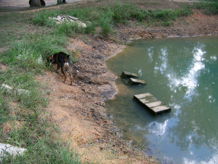

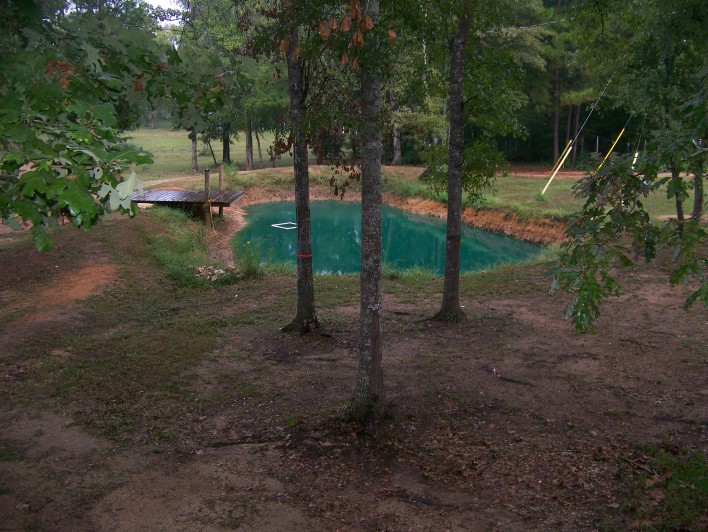

I got the Tractor Supply Co. air diffuser (air stone) in the pond on Saturday. Boy does it work way better than an air hose coiled up with holes in it.:thumbsup: The pond is down about 3 feet:( and I hope to get the shallow end cleaned out and resloped before the next hard rain.:) Booger got snake bit in the photo below, yet is in excellant spirits.:mad:
