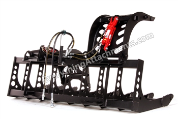

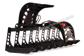

Check out this grapple. It is made from 80,000 lbs yield strength steel and it lightweight. I have one that I won in contest that is a kit that I have to assembly. I am very impressed with the quality of it.
That is one of the meanest grapples I've seen. Why would you need guards on the cylinders? Are you going to be pushing brush with the lids closed? It looks like they're well protected to me.
   / I got the deal of the day on a factory 3rd function kit for my L3240 #22
That grapple needs guards on the cylinders
You'll notice below that the lids on our Wicked Grapples are designed to protect the cylinders very well from underneath.
   / I got the deal of the day on a factory 3rd function kit for my L3240 #23
The cylinders are tough but it's the little hose fittings on the cyls. that are veunerable. With a log/brush grapple, they are generally in some tough & unpredictable working situations.
   / I got the deal of the day on a factory 3rd function kit for my L3240 #24
Boy that is a fact about hose fittings that I learned after getting our first backhoe a few years ago. I finally started buy TWO every time I broke ONE. That keeps me working more and fewer special trips to NAPA. I am sure in dirt work they will last 50 years but using both ends like it was a dozer clearing trees the limbs seem to aim for the hose fittings.

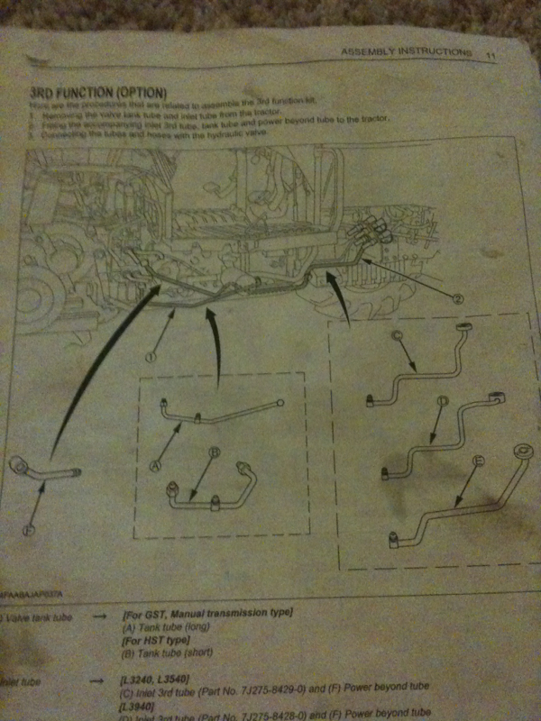

Well I finally got around to installing the kit, or attempting it. I got started and found out that I have an inlet tube missing. It is part #7J275-84290. Maybe someone has one laying around, if any of you guys have installed the third function kit on anything bigger than a l3540 you might have the extra tube. The kit I got fits the L3240-L3540, L3940 and L4240-L5740 tractors. I guess its all the same except for the tube that attaches to the bottom of the hyd. pump. I'd gladly pay for it if someone has one. I just don't want to pay Kubota $100 plus for a new one.
Thanks, Rob
#28
It's the top tube, letter C in the diagram.
