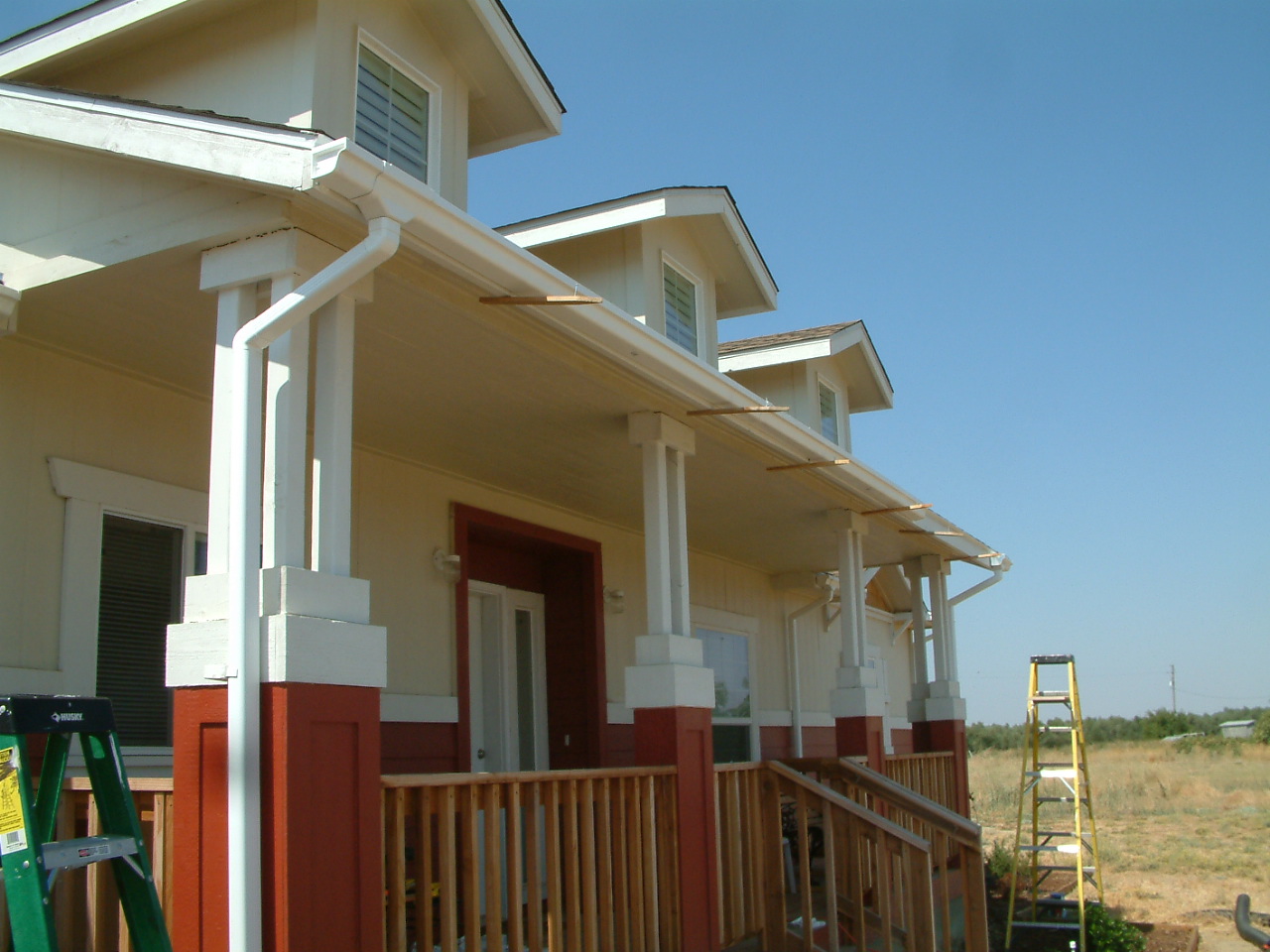

I have the inexpensive vinyl guttering from Home Depot on my place.
I had to use the plastic drip edging since the shingle overhang is too short.
Without the edging water would get between the rear of the gutter and the fascia board.
Had a few days of rain this week. No leaks between the vinyl sections (yet).
I guess I had better start looking for some good gutter adhesive just in case.
