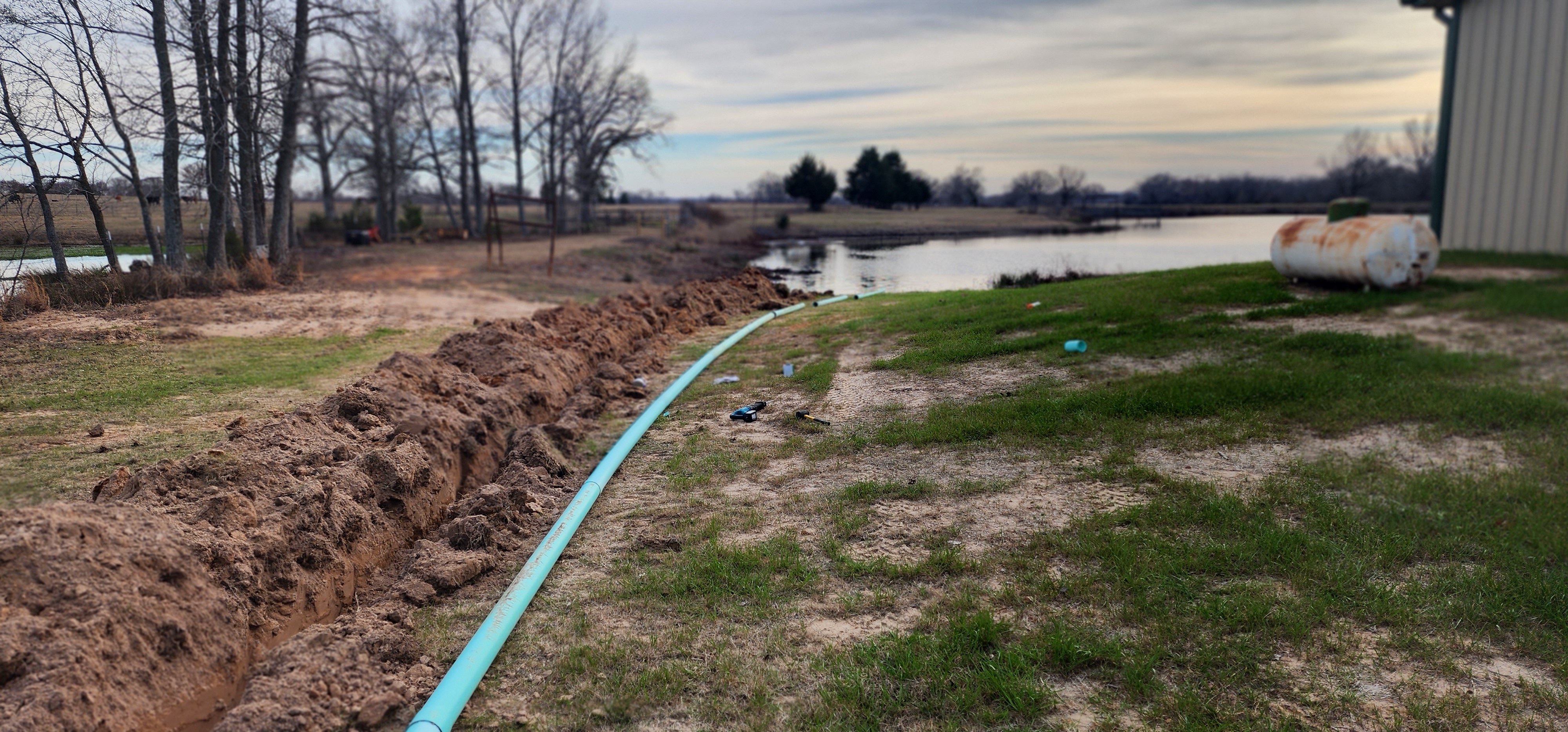

They have asked for an estimate to cut down all vegetation from the spring along the 300+/- feet of creek bed, and clearing the creek bed of all obstructions (making it run more gooder than it does now)
/ Offered another unusual project #88
Obviously to improve flow and capture rate of water before it settles into the ground. But they should also have a plan for maintaining that vegetation otherwise it will grow back.

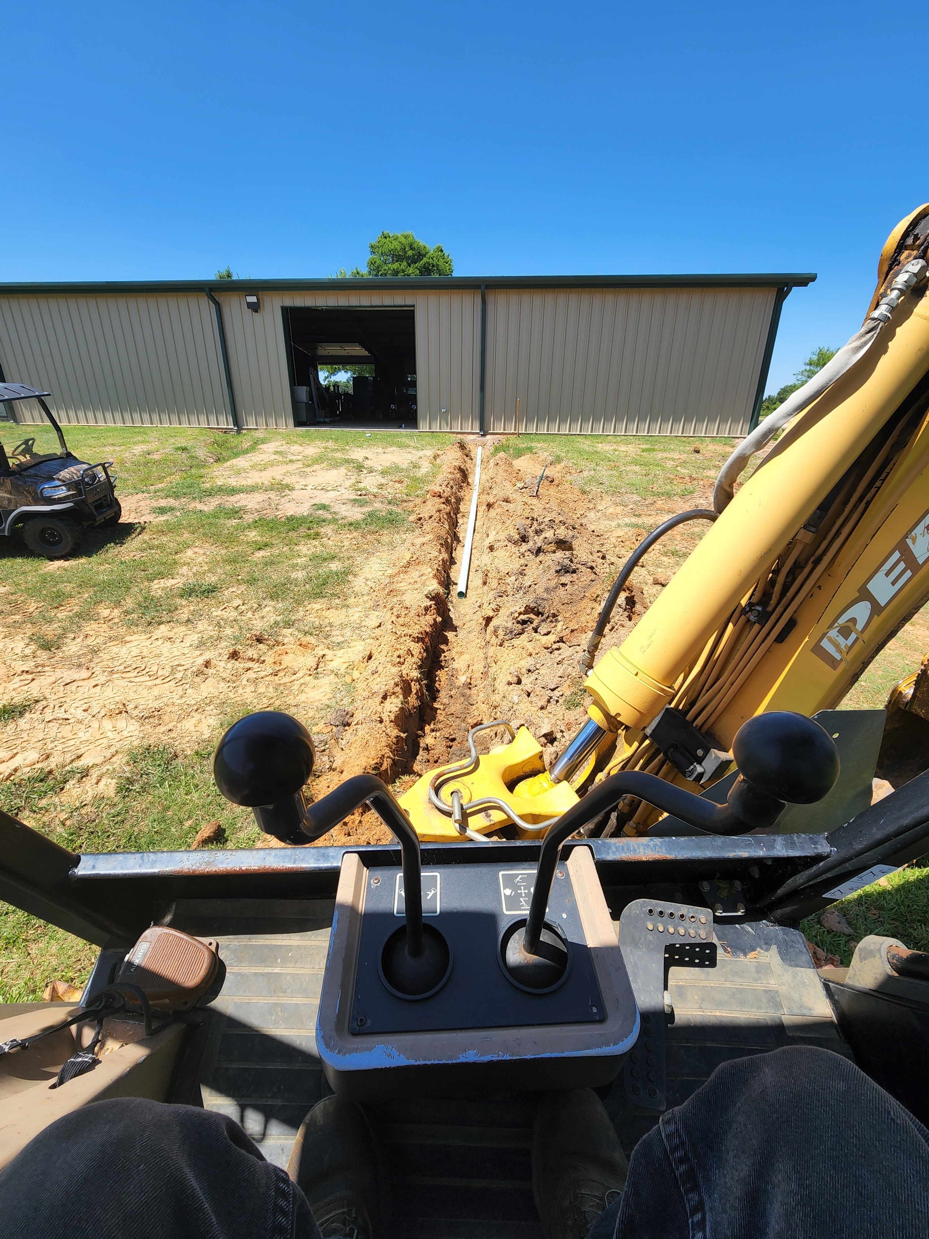

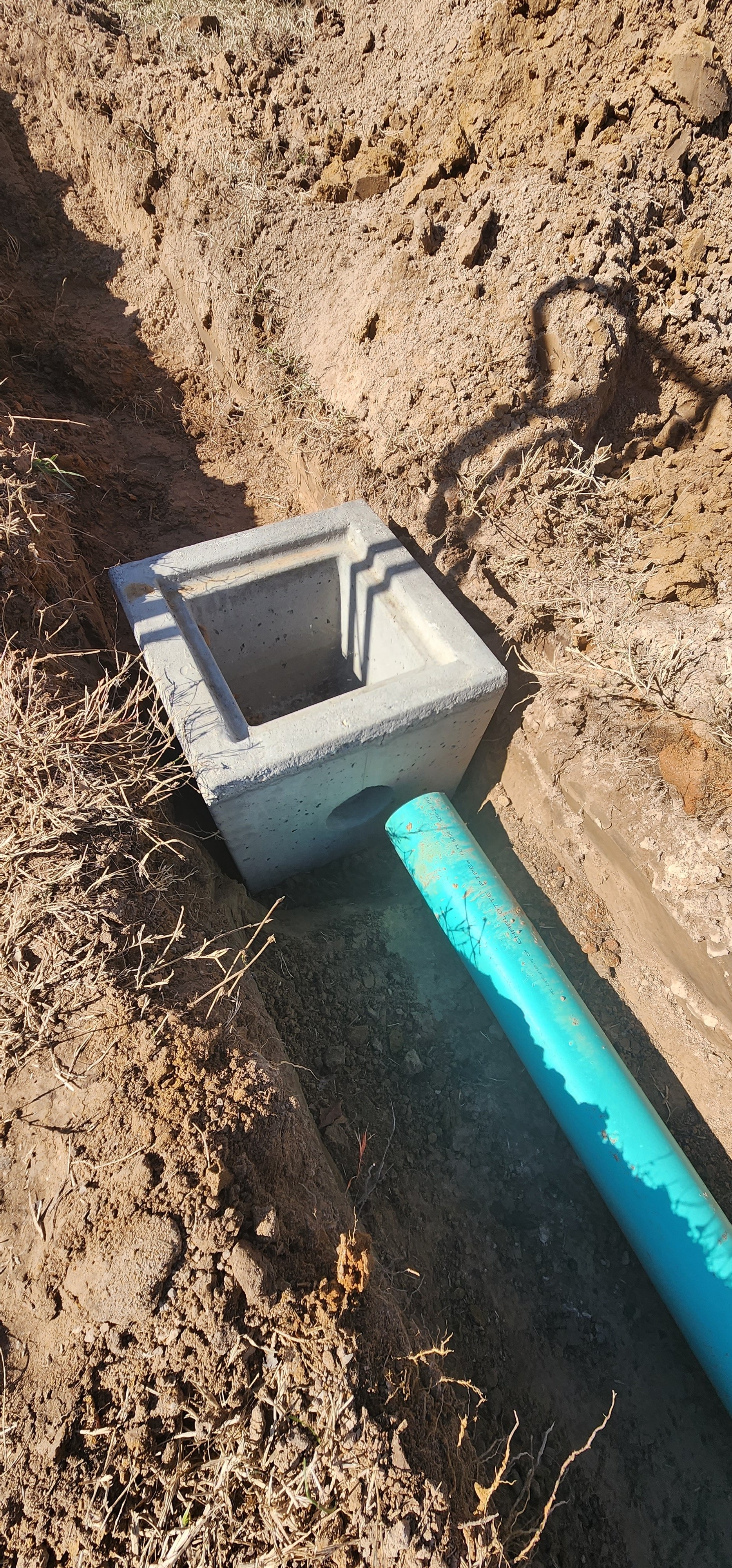

It’s a go, gents.
Phase 1 gets underway next week.
We will cut all the vegetation out of the stream bed from the spring to the pond and remove loose material blocking the path of the water.
In addition, have also been asked to prepare gutter/downspout bids for the back roof panels along with an estimate to trench in PCV to connect the downspouts and run them to the pond should the spring not provide enough water.
Have to get phase 1 done before hay hits at the end of May.
