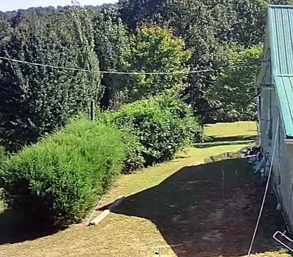

The problem area is in the shadow of the house. That shadow hides the slope away from the house in this picture. The lack of grass is because I just dug this area up for the end of a 100' trench. It'll take a while for the grass to come back this time of year.
The shrubs to the left are Cedars. They're not doing a whole lot as far as I can tell. I've kept them trimmed to about 6' tall until this year when they got away from me. I'm planning on taking them out this Winter and moving them. Then maybe I can work on some other drainage away from the house.
Just to the left of the Cedars is the beginning of a steep hill that drops about 20-25' over about a 60' run.

I think tile, just perforated plastic pipe, a couple of feet deep running left to right in your pic would help a lot. 3 or 4 runs woukd work, they wouldn’t have to be very long, just over the hill past the bushes. A little gravel around the pipe might help.

The pic helped me understand what his problem was. Poor drainage it looks like. Unless there is a leak not found yet.

Not certain yet, but it appears to be due to the dew. Still working on the whole shed roof/porch type thing, so I only have some of the metal roof up so far. The roughly 12' area that's covered is staying much more dry. The area that is not covered is wet to the point of being muddy every morning.
Once I get done with the porch type covering, I'll till and re-seed the areas that have been torn up by digging and other work. I'll try to grade a little more slope away from the porch area also. I call it a porch, but really it's just a shed roof type thing to keep rain off the electric work I'm doing for the generator and away from the side of the house.
