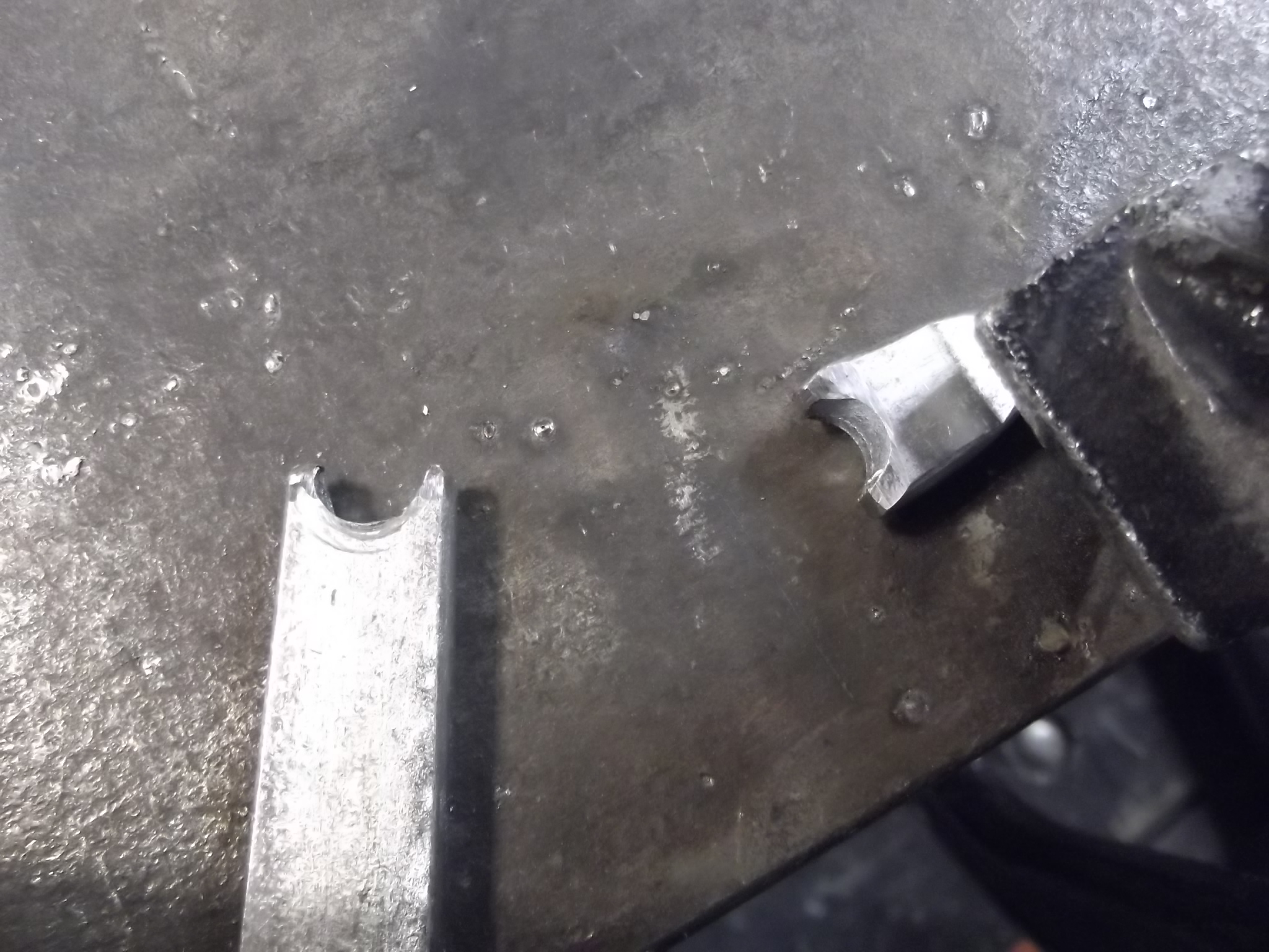

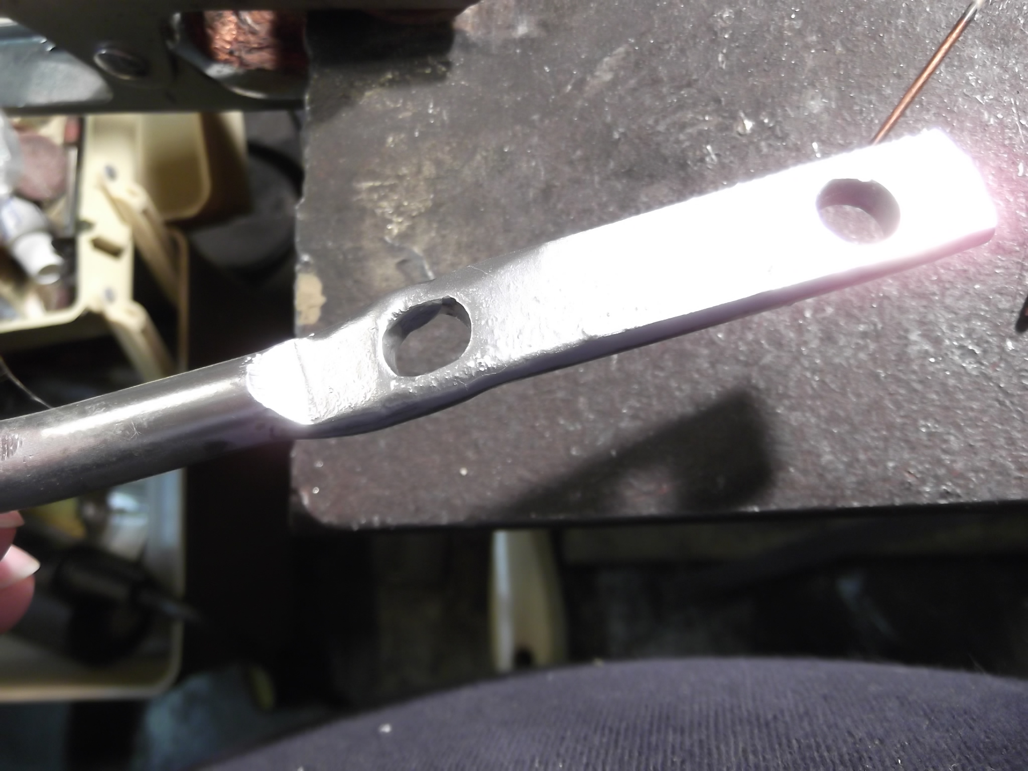

I am not knocking in any way any of the other welders or ideas presented here, but I have had good luck with my little Everlast PA160 amp stick welder. Yes a Chinese inverter welder I purchased well over 5 years ago for $269. I have done all sorts of welding and fabrication with it thru the years. I can also do scratch start TIG with it with a simple TIG torch I picked up for less than $100. This welder has easily paid for itself, and a buddy and I plan to use it soon to repair a radio tower he acquired on the cheap in the next few days. Below is a picture of the little welder and some examples of a few things I have repaired or fabricated with it. I would say I have my moneys worth out of this little stick/TIG machine

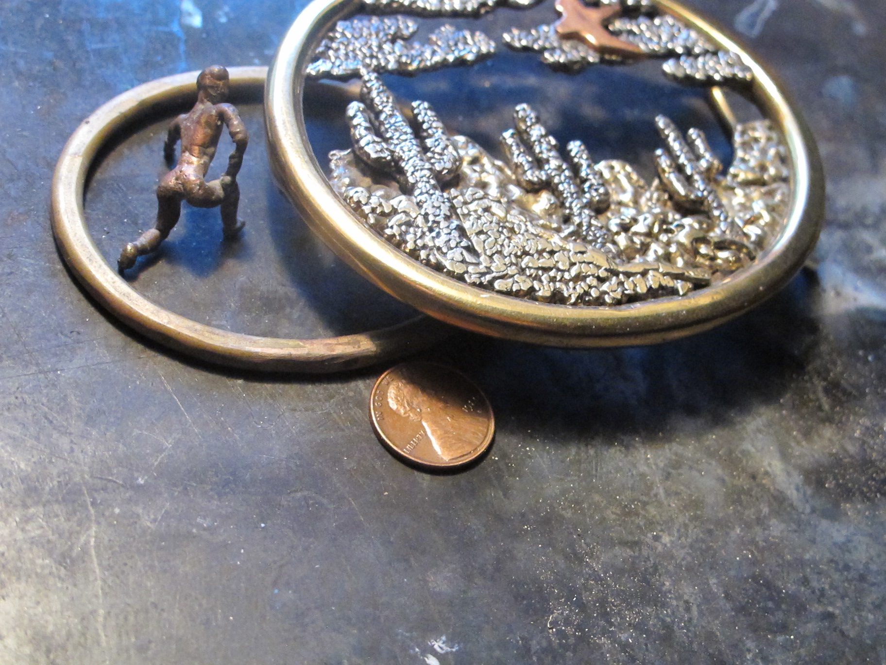

James, that is beautiful welding on everything you show. And very nice work on those copper alloy? rings...
Newbies take note: those are photos from a real master welder.
But I've also got to say that that just because the master welder can do a scratch start TIG fusion weld in stainless the thickness of your thumb nail without blowing things apart.... and all the while using nothing but a cheap Chinese box..... doesn't make necessarily make it the best machine for the beginner. The beginner profits from the most stable arc possible. And while anyone might get lucky and find stability in a cheaper box, super stable arc is one of the things we tend to find in the more expensive welders.
My advice, start with a good known-brand MIG. Get that one evening lesson. Avoid low end 110 volt machines if you possibley can; go 220V. And avoid the kind of wire feeds that rely on flux-coated wire only. As you get better you will very quickly prefer to use solid wire and inert gas for shielding. The millermatic does all this well.
Of course there is always the torch. Don't forget the torch. It's trickier, but versatile.
An oxy-acetylene torch can do many kinds of exotic metal work.
Here is some tiny torch welding in non-ferrous metal. All welded; no solder.

Well, Scotty, I am a far cry from a master welder. When I go fishing I have been called the Master-Baiter. But that is about it :)
The Everlast was my first DC stick machine. I did have an old Lincoln AC buzzbox which I have since traded off. The little Everlast that I can throw over my shoulder with its included shoulder strap does all that I need to do. I have a few hours on an Oxy/Ace torch, which might have helped a little on my TIG work, but mostly it was all just trial and error. Lots of error I might add. In truth, I only post my better work. I hardly ever show my "crap work". :)
For every chain I have made, or copper crush washer I have fabbed up with TIG, I could show you a dozen things I have blown holes in! :eek:
