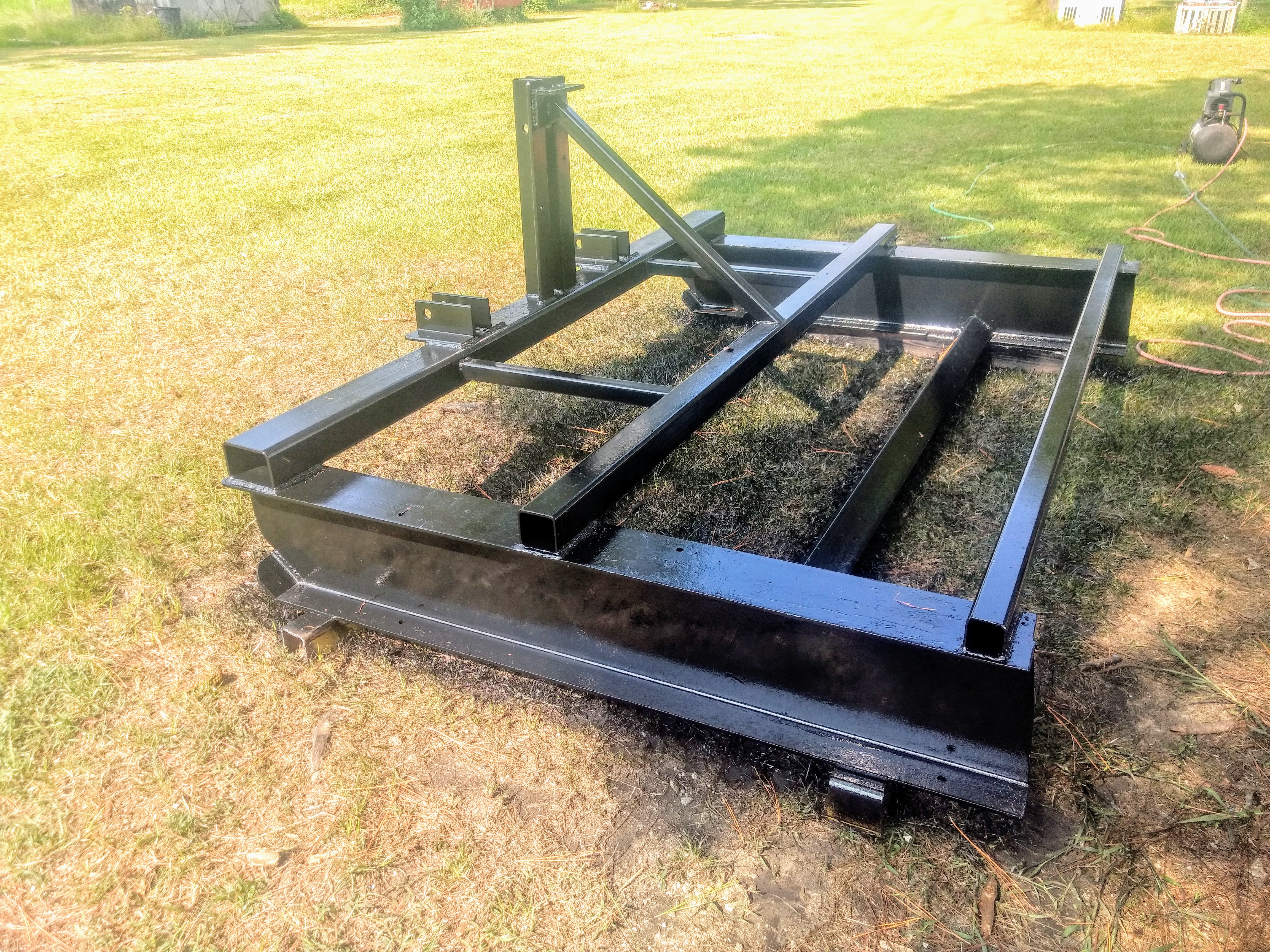

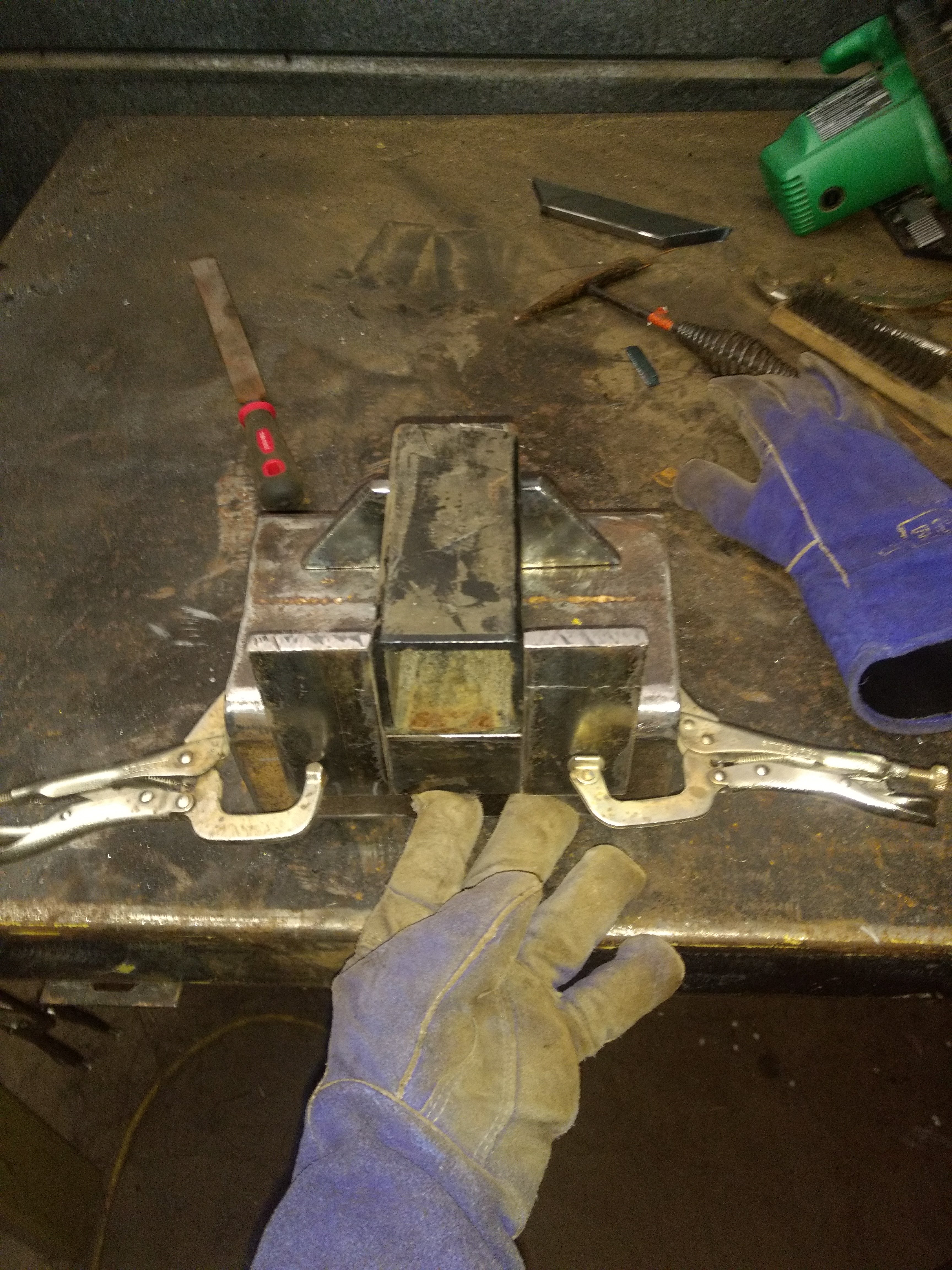

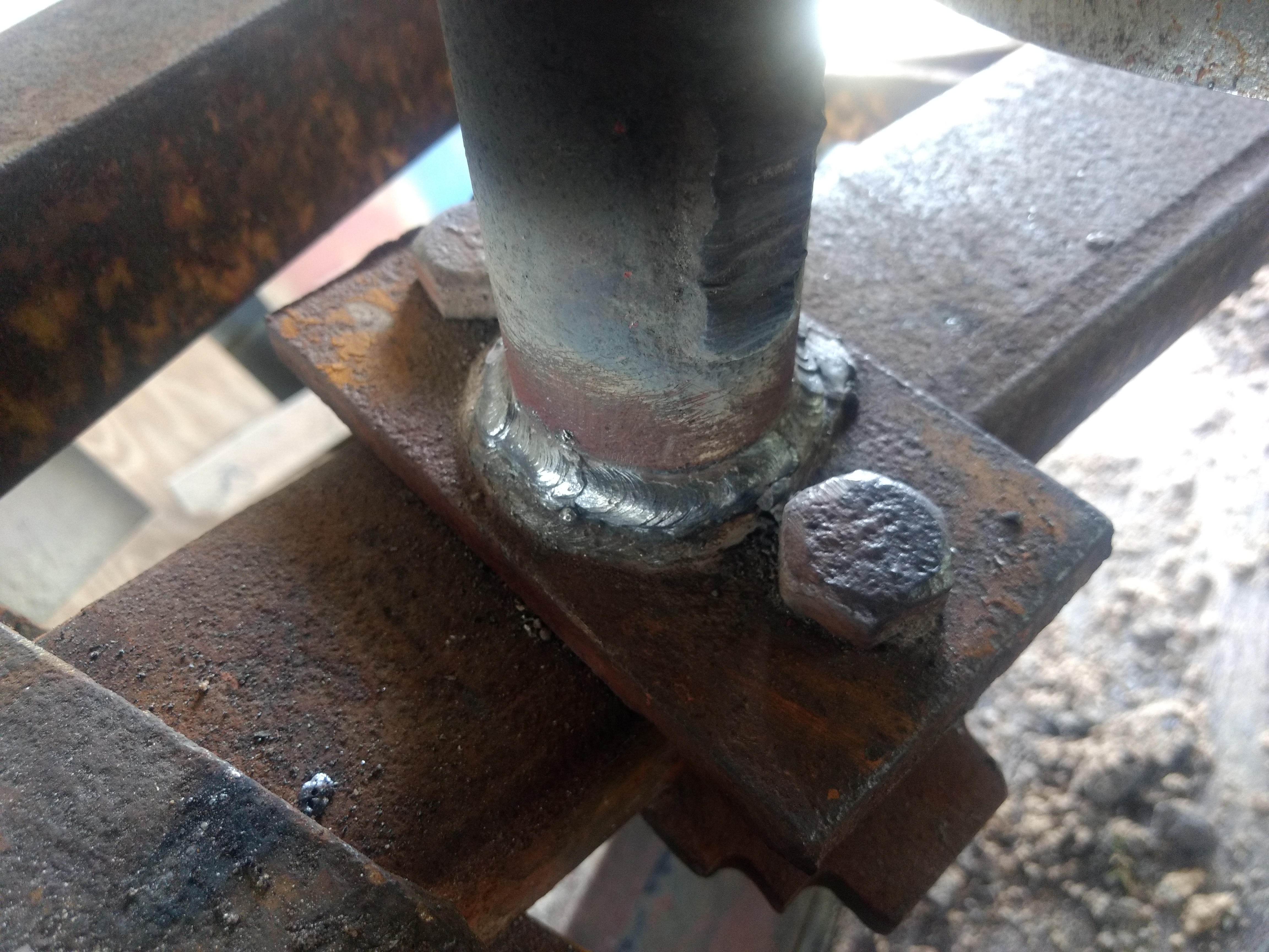

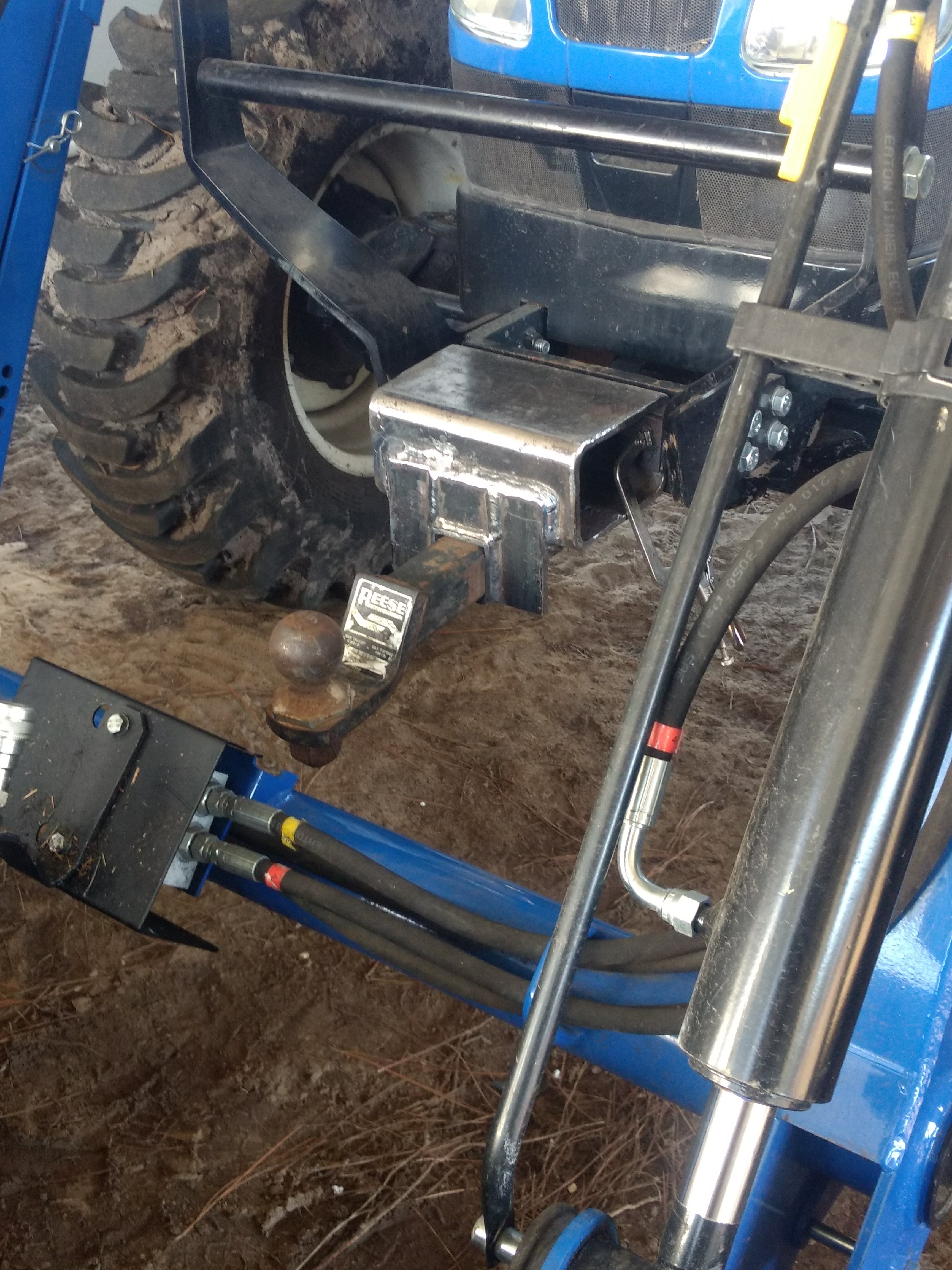

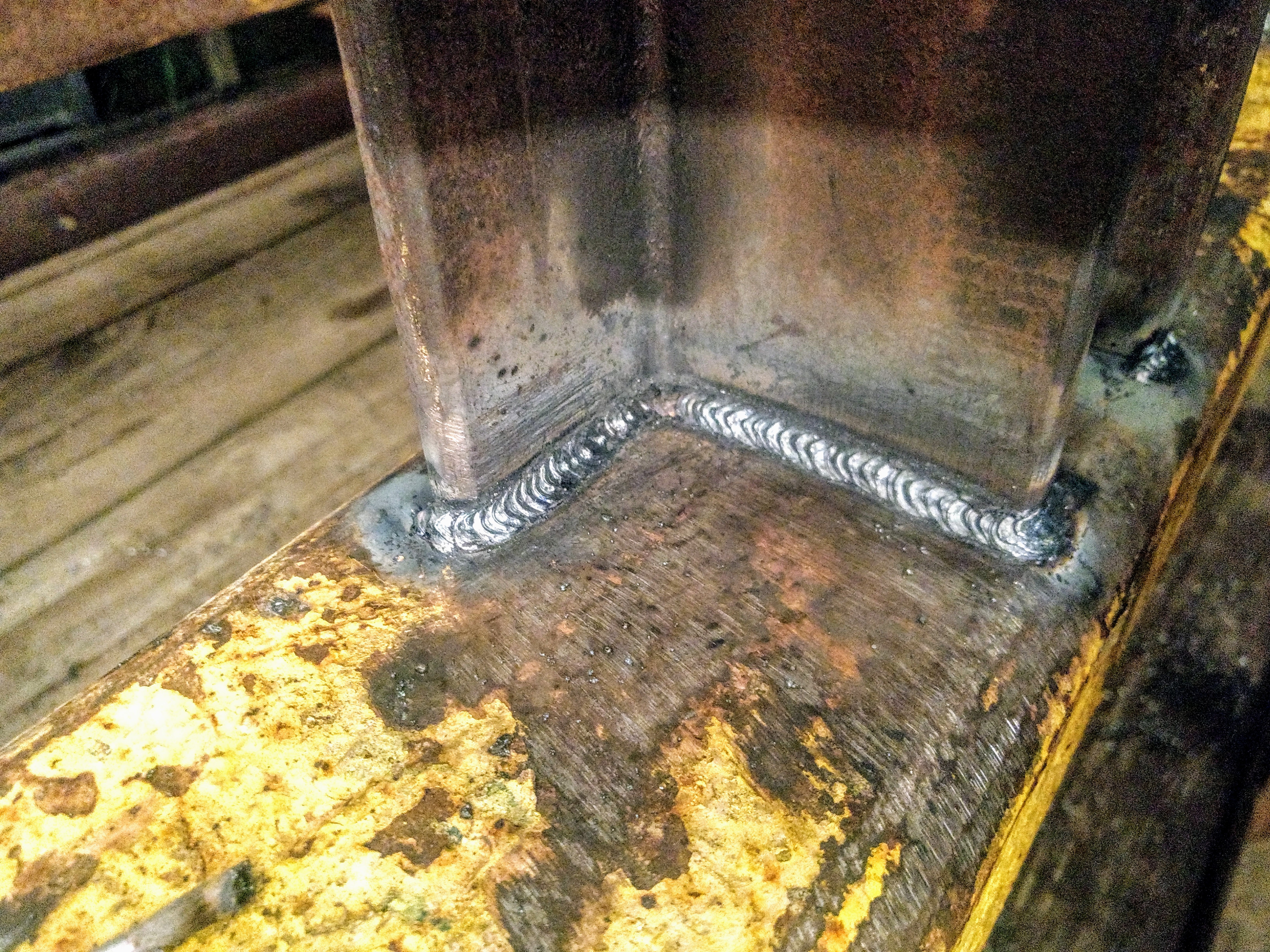

Like you I needed a welder to start repairing my own stuff. I didn't plan to weld much other than normal steel, no aluminum or sheet metal. Never stuck an arc in my life and wanted quality and price in one unit for a stick welder. Not a easy thing, but after some recommendations on here I bought a Everlast PowerArc 200 ST. Starting learning to weld, repairing my broken stuff, then some projects along the way. It's not a Miller I'm sure, but it's done everything I ask of it and makes a complete newbie like me look like I half way can weld. Mig will be more versatile and I plan to add one into the arsenal one day after my shop is built, but I do like the simplicity of grabbing a stick and running a bead.
Here is a few pictures of a few things I've done with it so far, it's more than paid for itself. Welding is probably the best thing I've ever learned to do around here & good luck in your choice. These guys here can definitely help you.

You have done some nice work.
