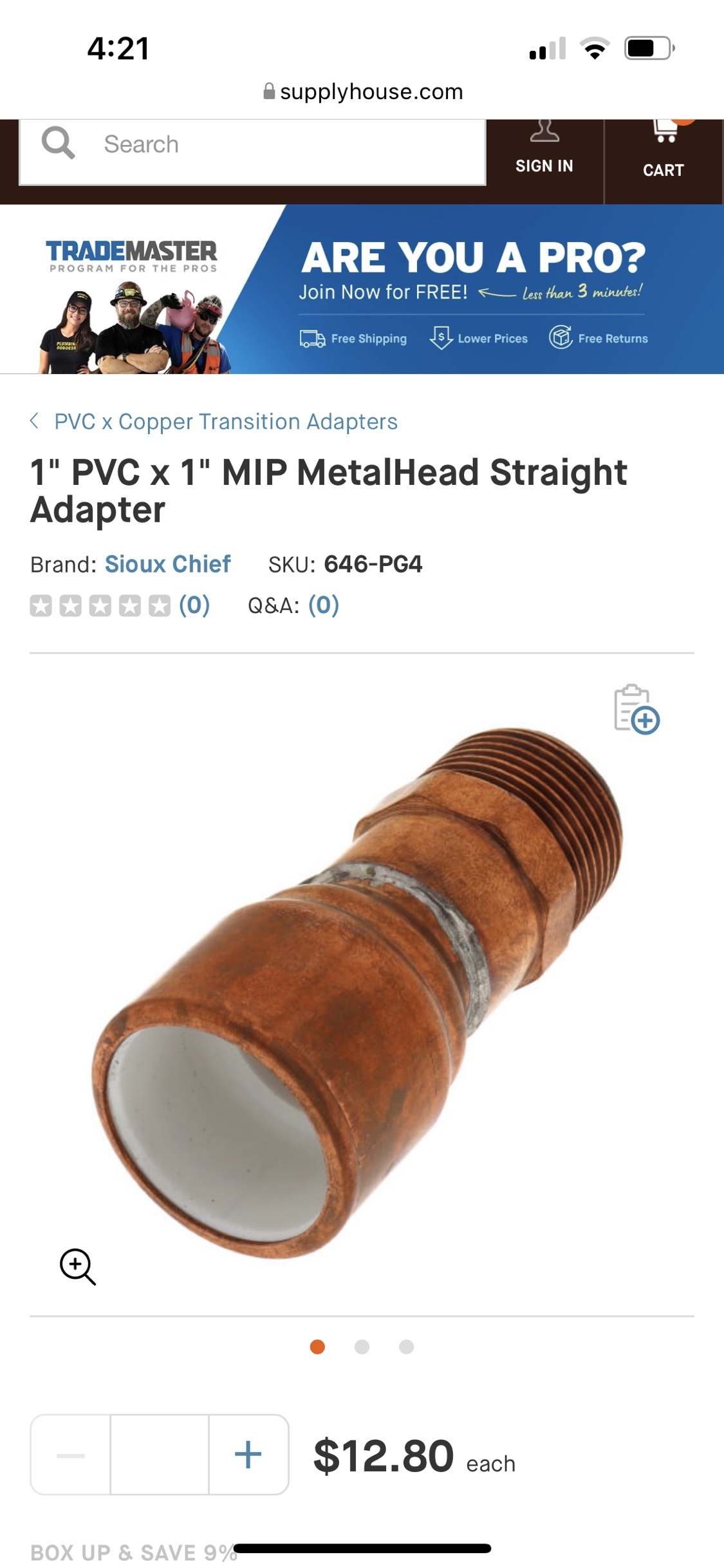

Hydrants should not be connected to PVC. The stress of valve operations will crack the PVC or joint. I just dug one out at my place. The last 5' minimum should run in rigid metal, like copper.
   / I have a water leak to or at my yard hydrant #33
A 5ft stick would be even better but I always use these fittings to join pvc to hydrants or meters and I’ve never had a problem with them.
