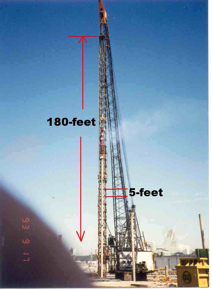

My idea for the capstan was to pickup the weight, (drop hammer) with a rope wrapped 2 or 3 times around the capstan, while pulling tension on the rope. When the weight reached the top of the beam, let go of the rope, and drop the weight.
Here is a picture of a larger scale of what I was thinking of building. In your neck of the woods this pile driving system is called a pogo stick. Other places they call them Bay City leads.

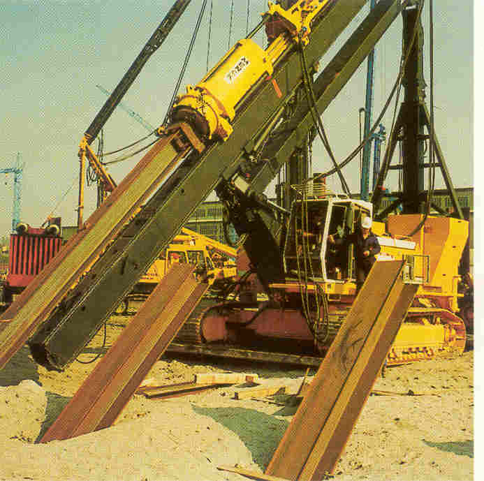

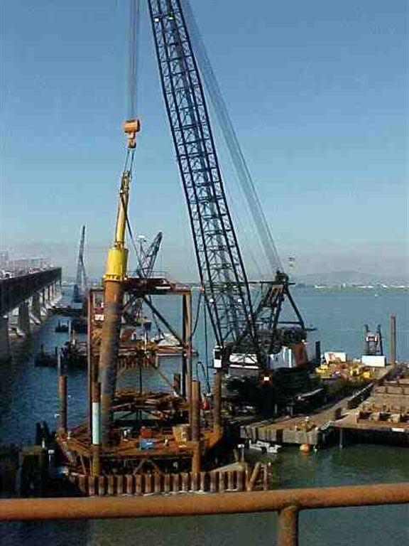

Thats what I did for a living.
Never got as far as putting pen to paper for a design, just thinking about how I would build one if my brother-n-law would have ever got off his azz. He bought 20-acres just west of Copperopolis and was worried about driving T-post in the shale. I suggested this system with a spud to break up the shale first. Went right over his head.:rolleyes:
