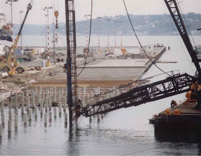

I for one would really like to see pictures! Never know, I might be talked into building one at some point. I just can't get my head around building one with a hydraulic ram, just can't figure out how they free fall:confused:. I have used hydraulic impact hammers in the past. But they are a different animal all together!
Hammer & Steel | American Dealer for Junttan Hydraulic Impact Hammers

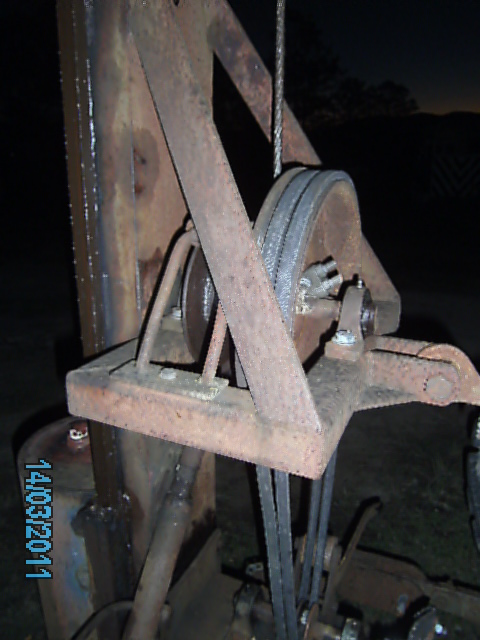

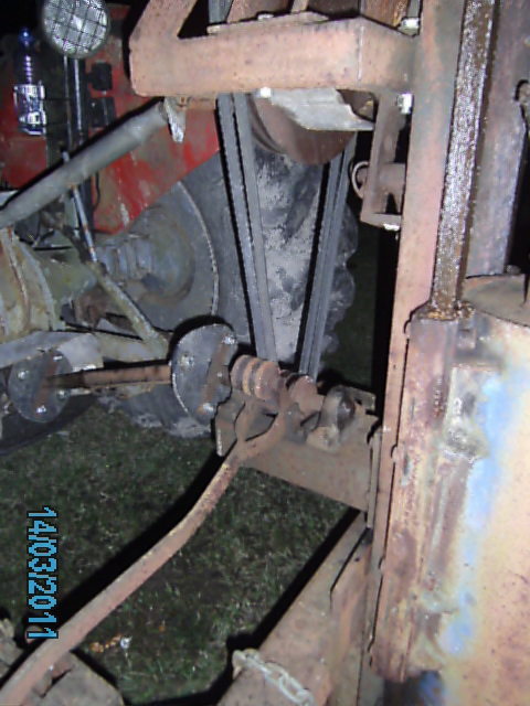

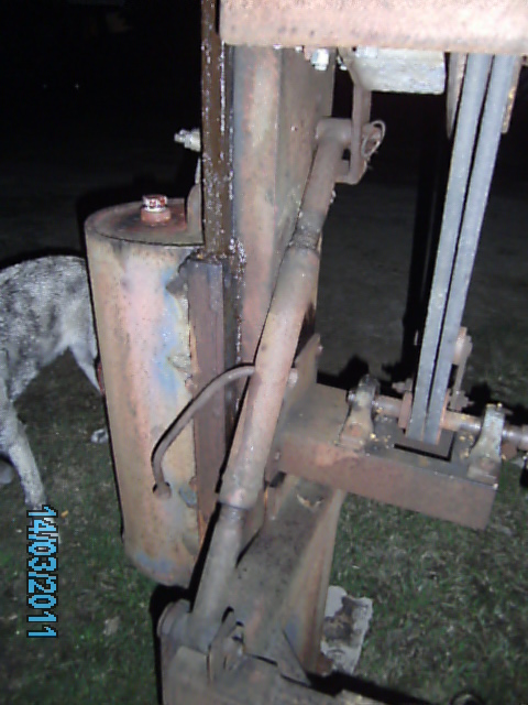

sorry it was dark by the time i remembered to get the pictures, basically the main frame is a heavy section c channel about 8"x2", with 2- 1"x1" solid bars for the hammer to slide on
cheers stuart
the cap on the top of the weight i put there to add lead weight extra 30lbs.JPGside angle adjustment back and forward is done of the top link for 3pl.JPGpost driver handle.JPGoverall picture.JPGcatch for hammer.JPGcable comes out of the wich drum around a bolt and clamped.JPG

So I take it as, you engage the PTO to raise the lump / weight, and then kick the PTO out of gear to drop the lump / weight?
I really like the idea of C-Channel and square stock welded to it for rails! Have to remember that trick! :thumbsup:

you engage the pto and leave it running, adjust the driver to vertical, to raise the hammer you lift the lever thats connected to the bottom pulley's, that takes up the tension on the belts, and raises the hammer to drop it relax the handle but just lift it as the hammer hits the post to stop an overrun on the winch, took me around 6 posts to get the timing, i was told the cable lasts about 1000 posts, mine is a bit ruff, i found it in a paddock were it sat for 10 years, it didnt take much to get it going, the winch drum collapsed, rust on the inside, it could do with some new bearings, very slight rumble, that can wait till the final paint goes on and back together, this is as basic as they get but easy to get parts or remake as needed, i did start out to build a hydraulic, but since i have got this one have been happy and will probabley set the smaller one up similar

OK! I think I get it now, the V-belts slip on the pulleys until you want to lift the lump / weight? When you want to lift the lump you engage that idler wheel / pulley to put tension on the V-belts?

yes thats it, if you have a look up the channel there is a hook type keeper to hold the hammer up, while you back up on a post or to put a post in, the channel is around 15 to 16 ft tall, and has 2 of those hook positions, it can fit a 10ft post into it, without raising the 3 point linkage and still have room for the hammer, the hammer is around 300 to 400lbs
