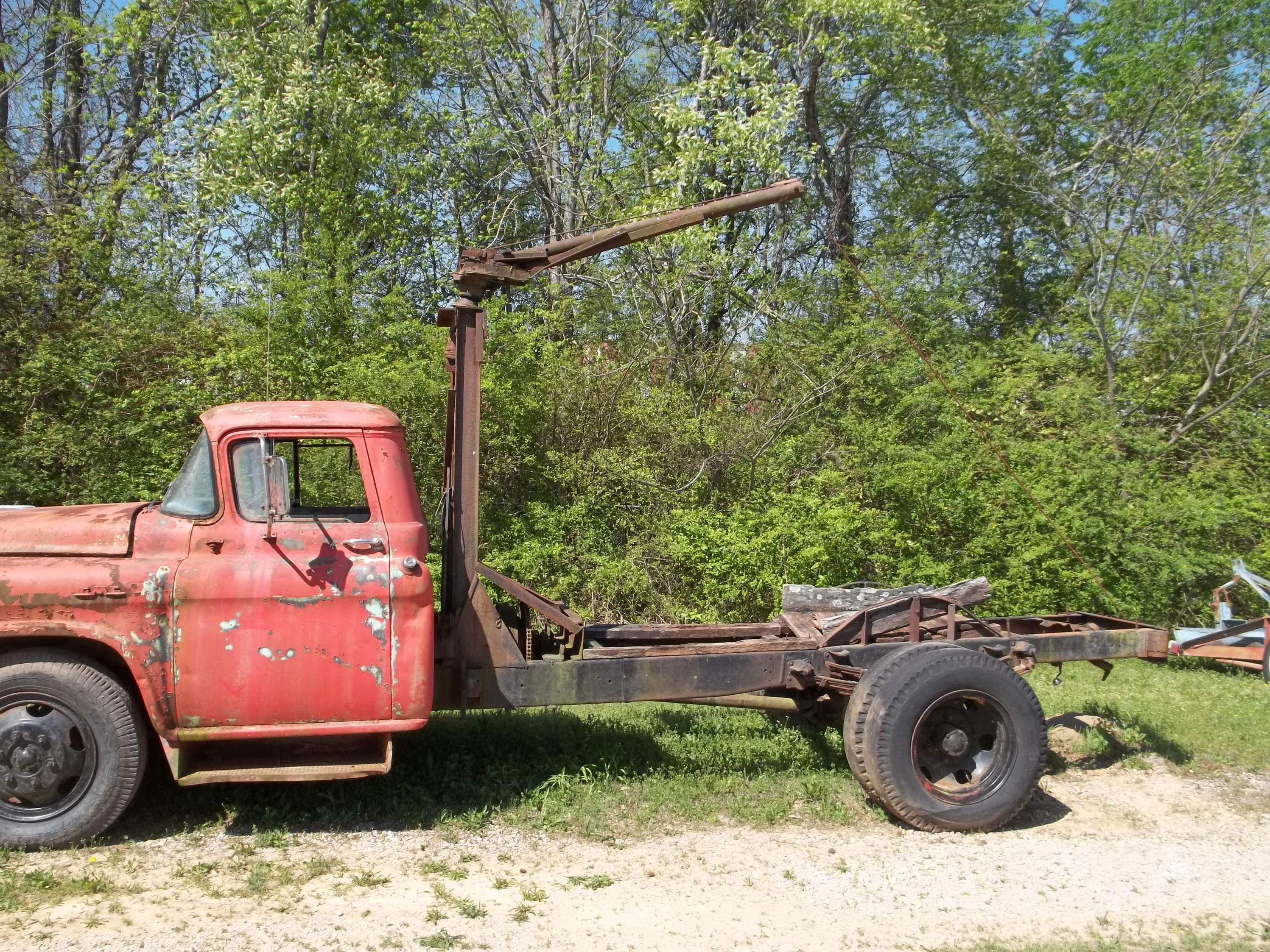

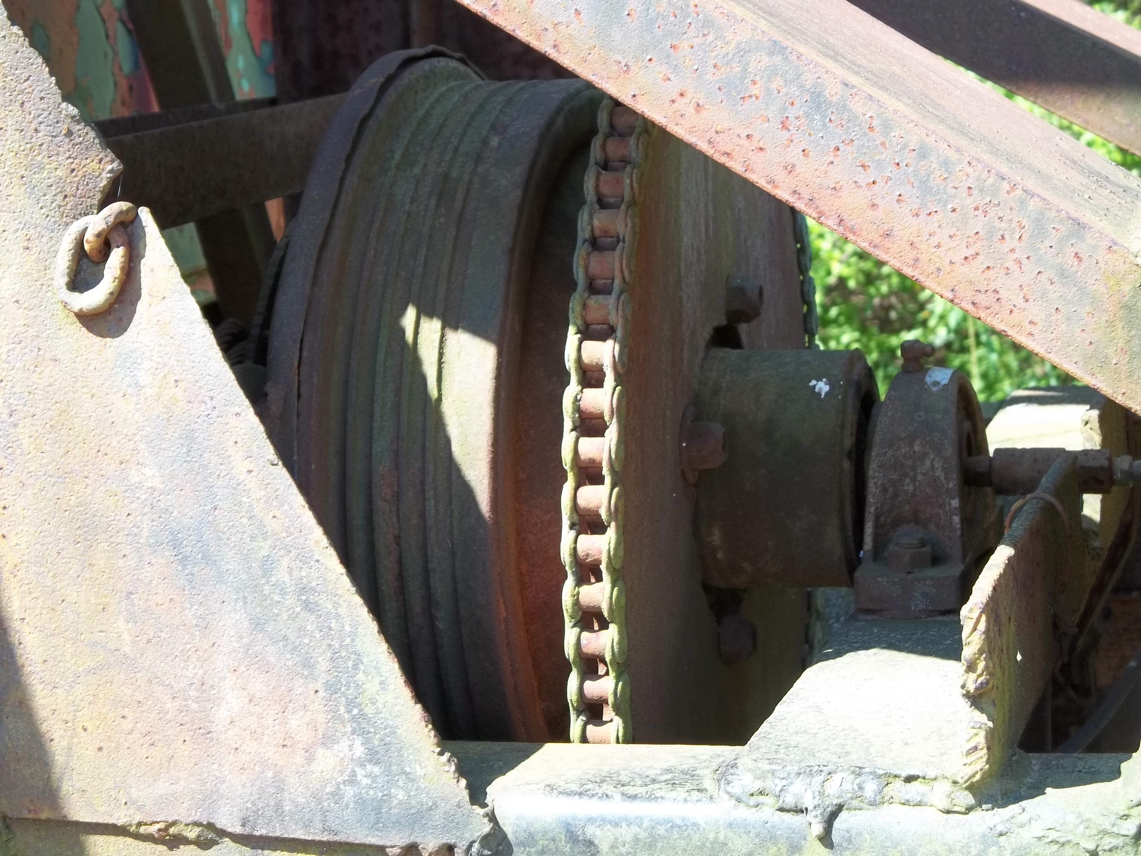

It is some mad max stuff lol. I guess they have been around since the fifties. Its a good cheap way to make a fast dropping winch. Also you can use one side of a floating rearend for a similar winch. I have a pic of that setup on here. His is an old stick wood loader they winch type on this one was more common on the side loaders as it offers no holding capability. Well this one did , not pictured it has a loop weded to the drum and a chain with a circle hook that was dropped into the loop. Most of these loaders used the car axle set up like I mentioned.

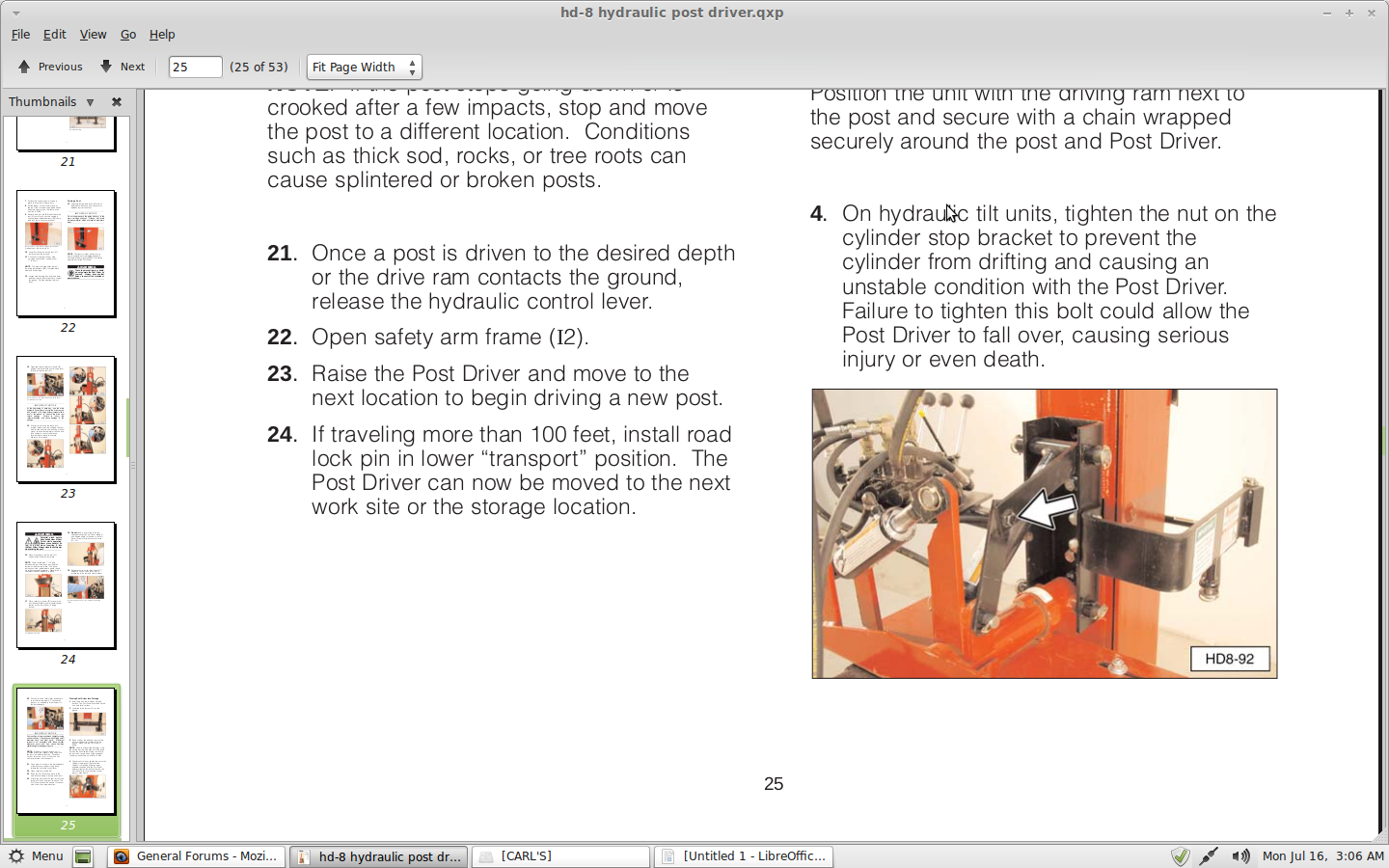

Look at a Shaver. They are impossible to beat in design.
I found one of their manuals on line. I really like their method for plumbing the driver. But I didn't see a good view of their trip system. It would be interesting to see how the weight is tripped to free fall from the hydraulic ram.

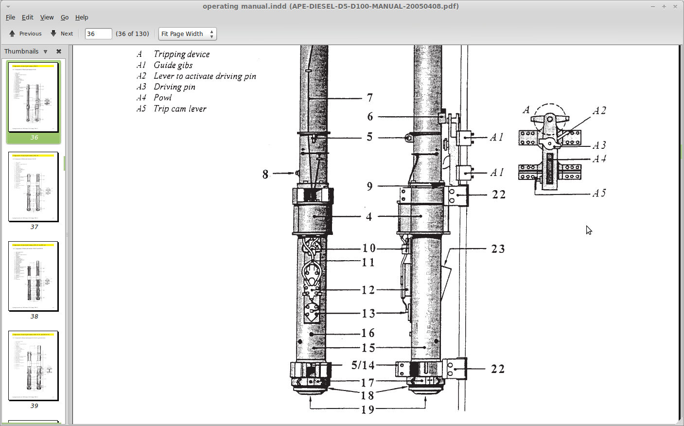

I found a manual for a Delmag hammer. This is the trip system I'm most familiar with.

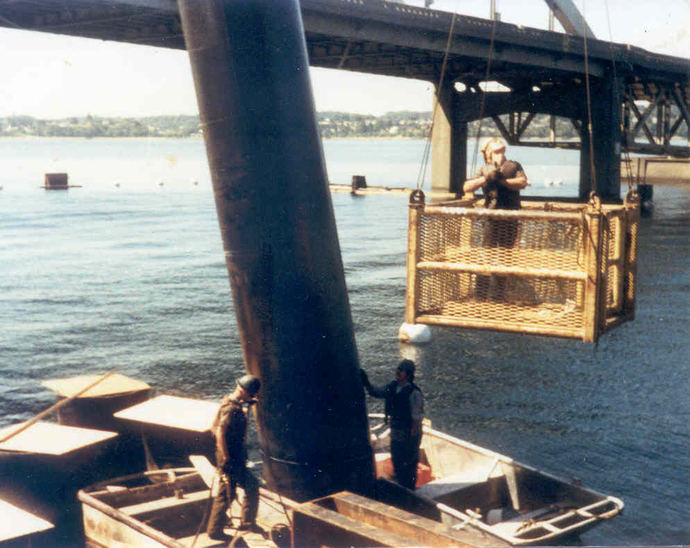

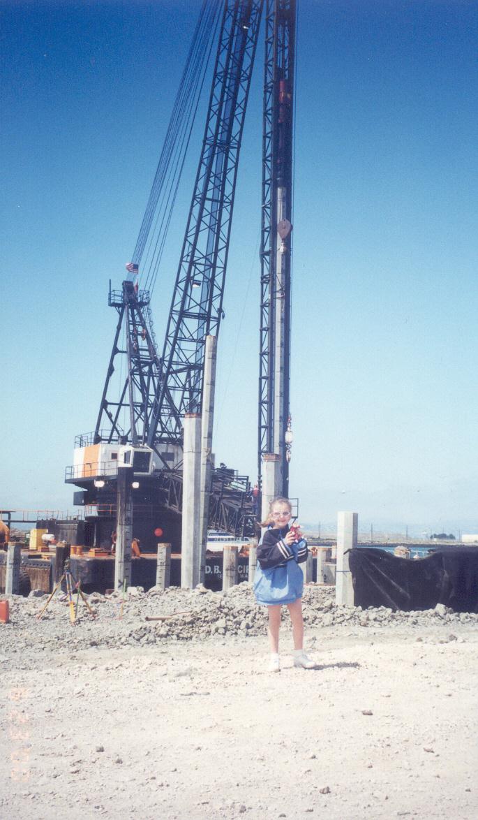

That is a very nice build! I'm not use to working with drivers of this scale. So I have a hard time believing these post drivers do not mushroom / splinter the tops of the wood post when the blow count goes up! Not that I've ever drove many wood pile, but drove literally 100s of thousands of concrete piles, and steel piles. In every system there is some kind of cushion. At the very least a striker plate that goes on top of the wood pile. The lump / weight of the hammer never impacts the top of the wood pile without a striker plate on top of the wood pile.
I don't seem to have any good close up pictures of the type of equipment I'm trying to describe.
Here is a picture of some 54-inch dia. pipe pile we drove for a bridge. 1750 blows per foot to get these pile to grade. There is a unit that goes under the hammer that looks like a big bowel, this unit is called a follower, inside the bowel is some type of cushion. Blue Ice is very popular, miecarta is another cushion that is used. On top of this cushion is usually a 4-inch thick plate, the bottom of the hammer sets on this 4-inch thick plate. Attached to the bottom of the follower is an adapter that holds onto what ever type of pile you are driving. Pipe pile you use what is called a wedding cake follower. Concrete pile, use a different type of follower.
The next picture is of some concrete pile we drove of a container ship dock. If you look close you can see the plywood cushion block still on top of some of the concrete pile. That is my granddaughter when she was a small girl, a grown woman now.:)
