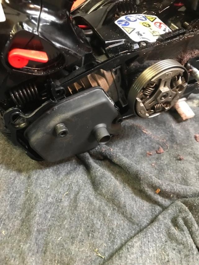

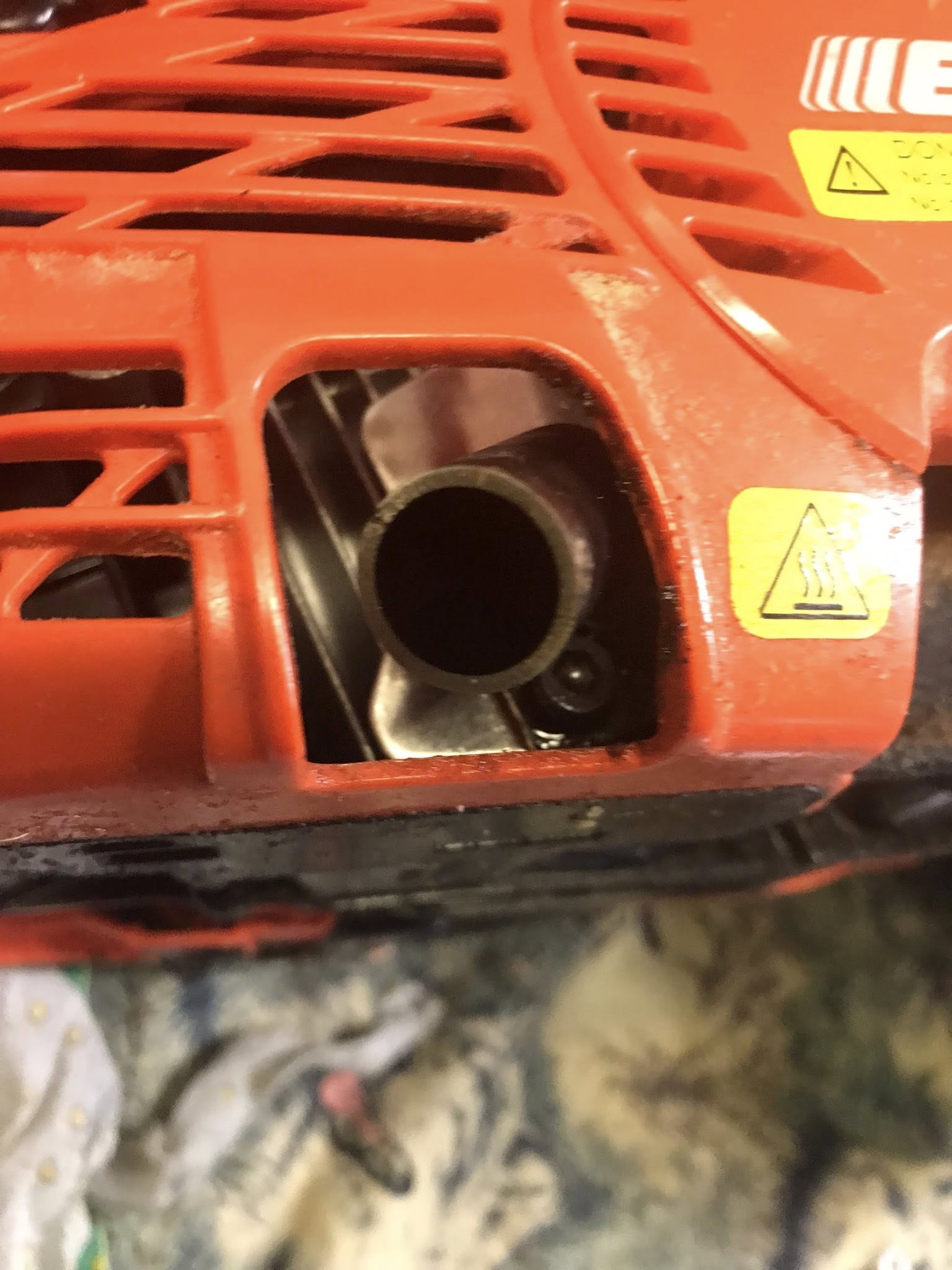

It's a hollow box. How much 'muffling' can it do?
Guess you dont have a clone 2511 yet either.
It is HOLLOW with a small pipe. So how much does it do? :ROFLMAO:
Lot better then that oem stuffed up pos muffler they put on to hold them back.
My good ole stihl's and husky's were hollow too. 🍻 ;)

Call it what it is, a hollow exhaust box. No muffling going on there.
Nope, don't have one......yet. Maybe the OEM muffler can be 'cleaned' out?
.......and save $50

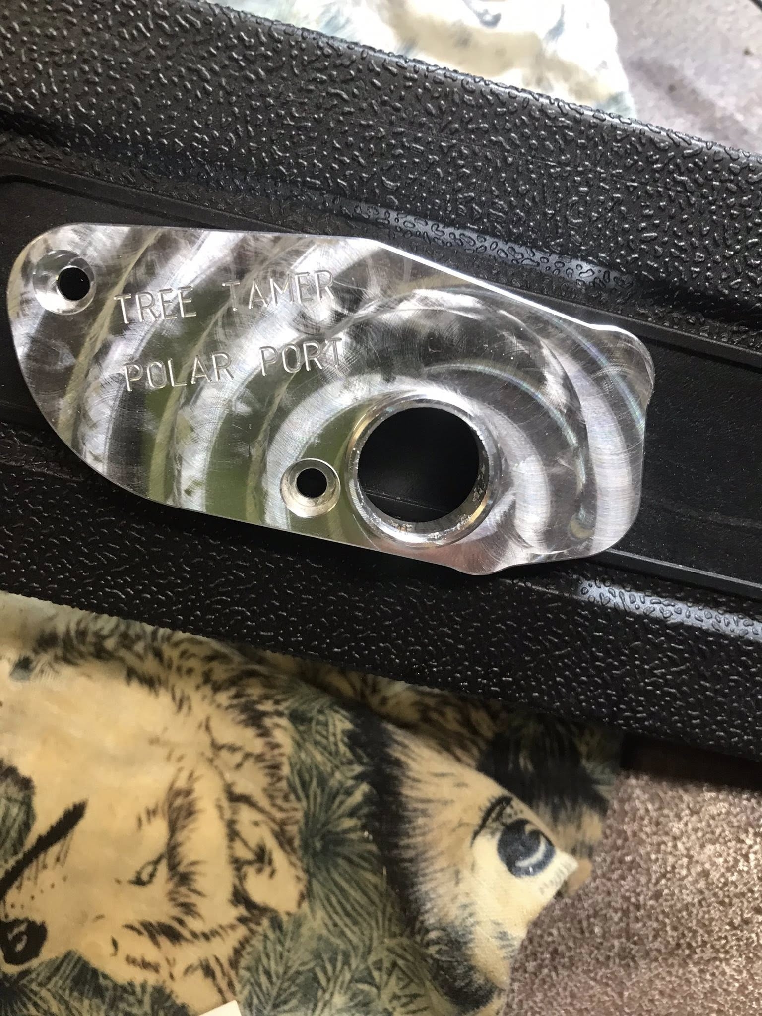

I bought the Egan, which is literally just a pipe. Also got the OEM mount for the air filter to secure it better.
Should be able to get it set up next Tuesday

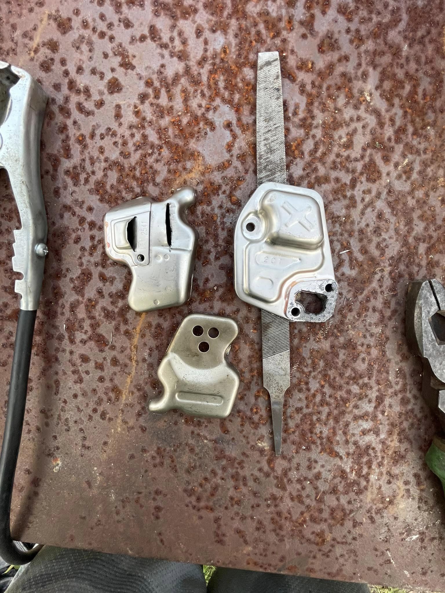

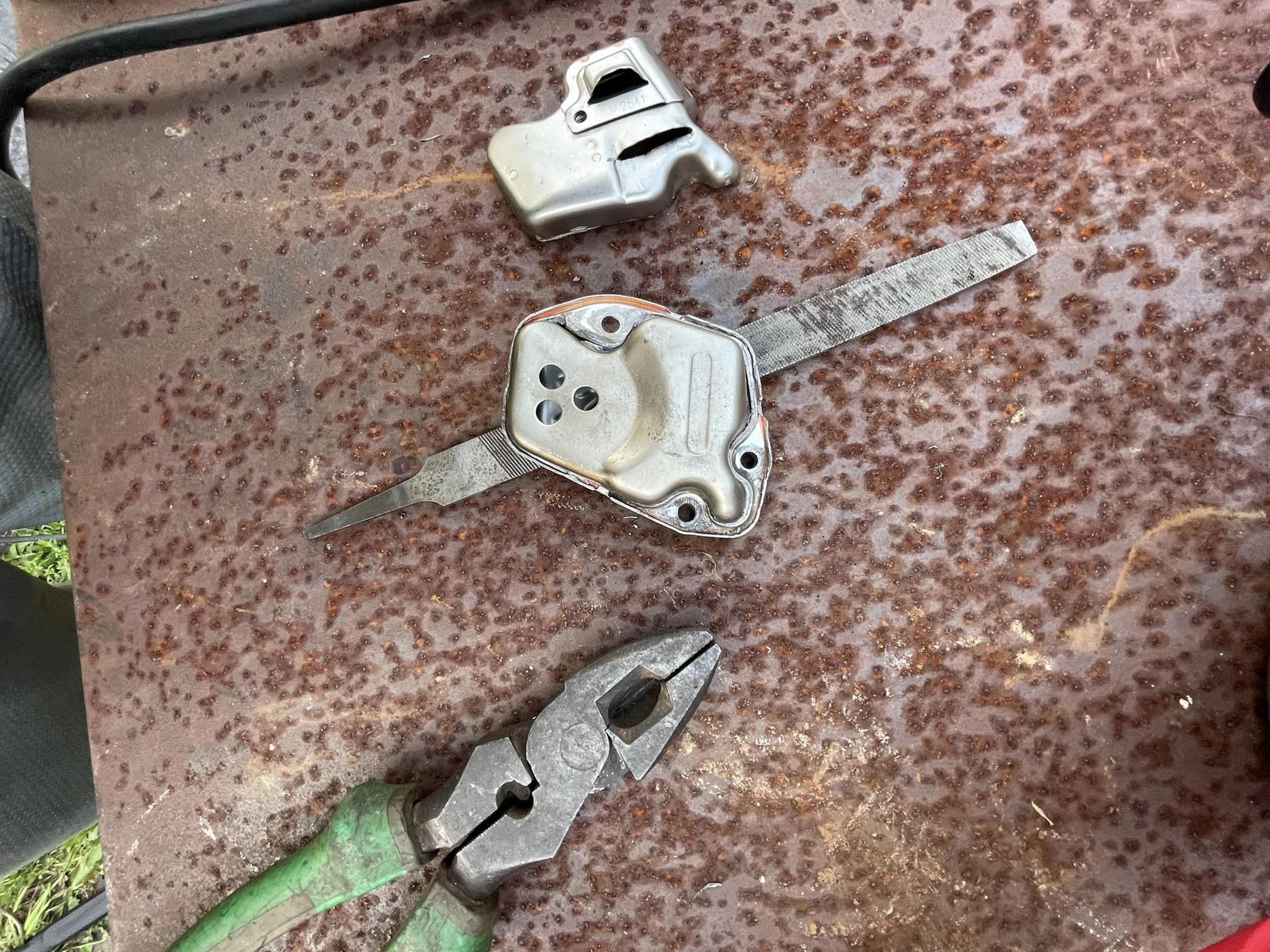

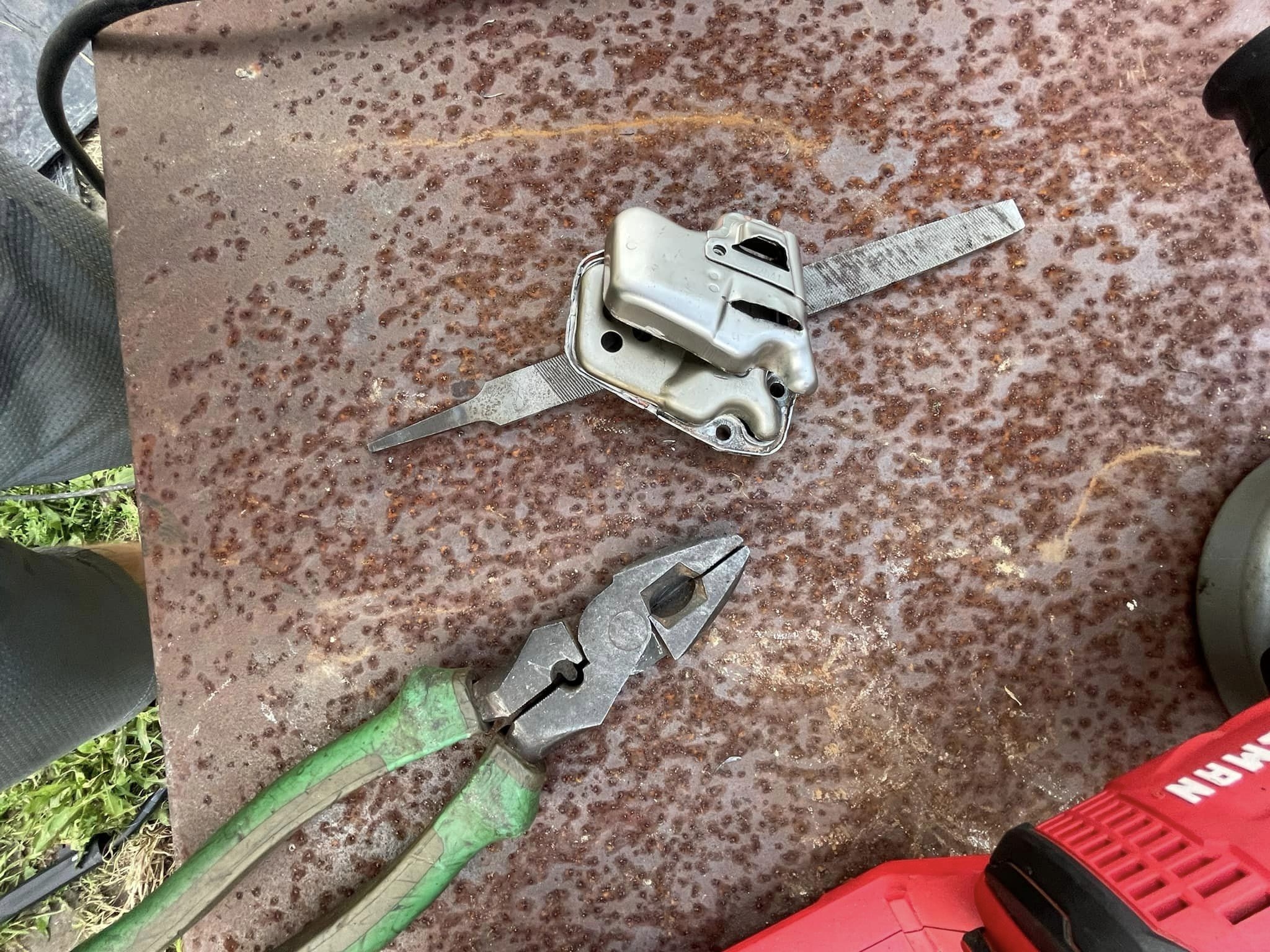

Sold as a muffler so calling it what it is sold as.
If dont like it just think it in your own mind. ;) :ROFLMAO:
The crap inside OEM. Least it isnt a cat muffler like some do.
Friend added extra exit to help too.

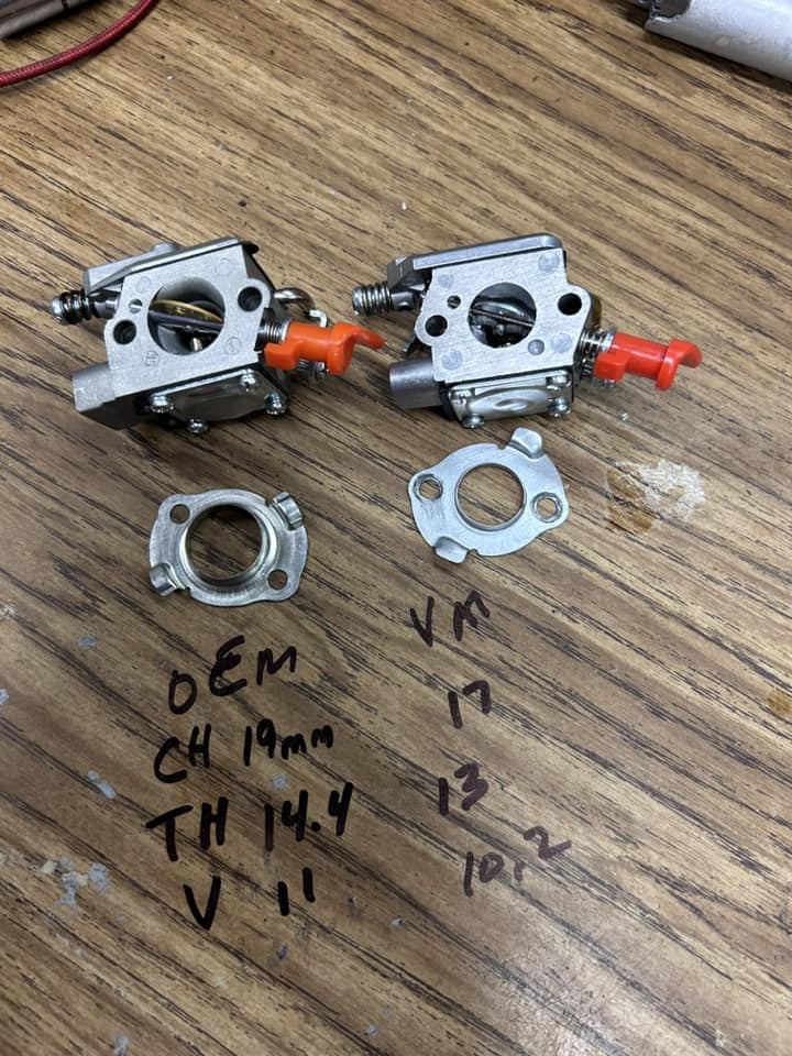

Wait a min is your air filter wrong side on your clone then? That part where air filter goes is 2 different sizes.
OEM is big with big filter.
CLONE comes with small and should have small filter.
Clone carbs smaller too.

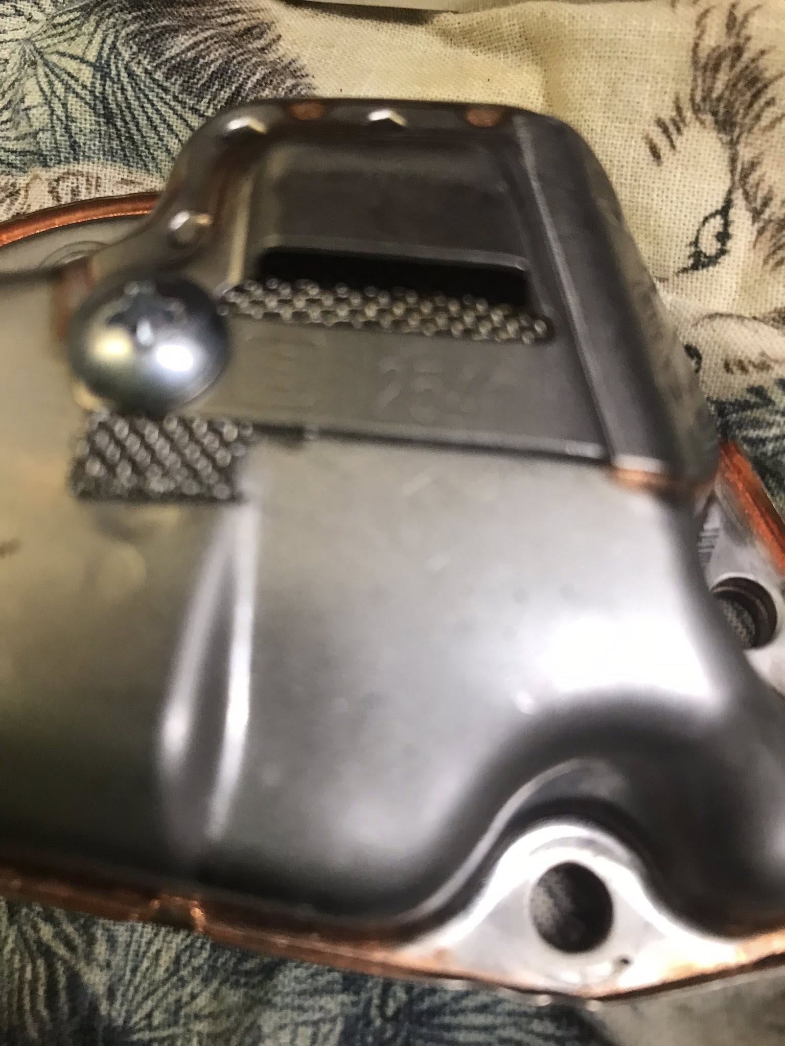

My oem 2511 muffler isnt worth my time to gut like shown above.

I showed measurements of both in my thread on junk saws.
I'm going to try timed cuts and compare everything I have on hand. I might even throw the stock stuffed up muffler in for laughs.

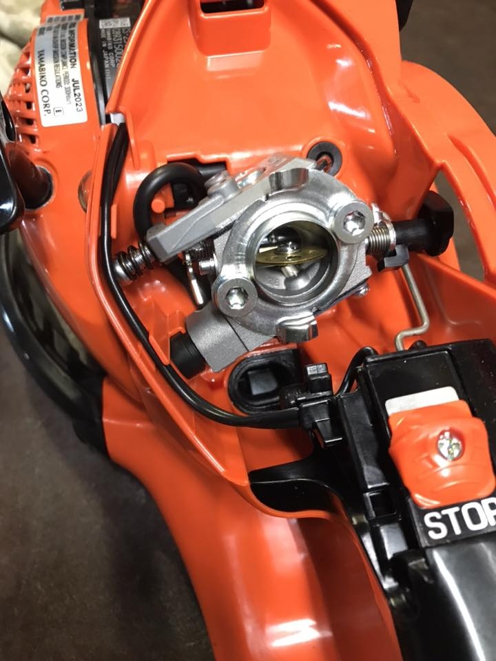

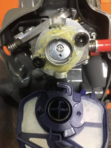

That was only when the mold was broke. The clone companies threw on oem sized which was wrong size.
I have not yet heard of wrong size filter on a Joncutter G2511 to date.
Plus the mold as since been fixed for the clone air filters.
Yours should be small and small.
But since you bought oem size you can now run the bigger oem size filter.
I grease both oem and clones. Big small both shown. Just hadnt greased oem then but was getting ready to.
Because most of us do not do BOOBtube BS. So much wrong info there.
All that info is in my group back when going on. If not there ask before buying.
