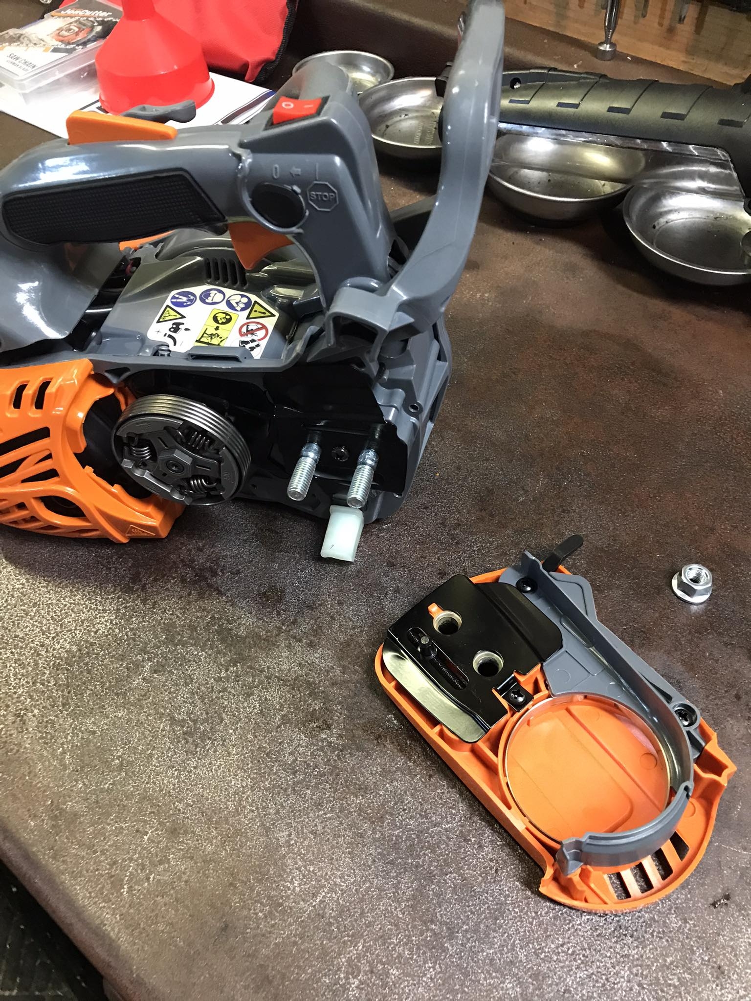

Well, you guys hooked another sucker. I ordered one to accompany my trusty CS-590 Timberwolf. I unboxed last night and tried to put the bar on but the brake mechanism seems faulty? Or is it just really stiff from the manufacturer? I can't get the clutch cover back on because the brake spring is too tight and I can't seem to move the little metal brake lever that stick out the top. Any ideas or should I just throw it back in the box and return it?
Sounds like you tripped the brake taking off or something. Never a issue on oem or clones.
See how band looks unlocked.
   / I just bought an Echo 2511t clone for $99. What was I thinking? #274

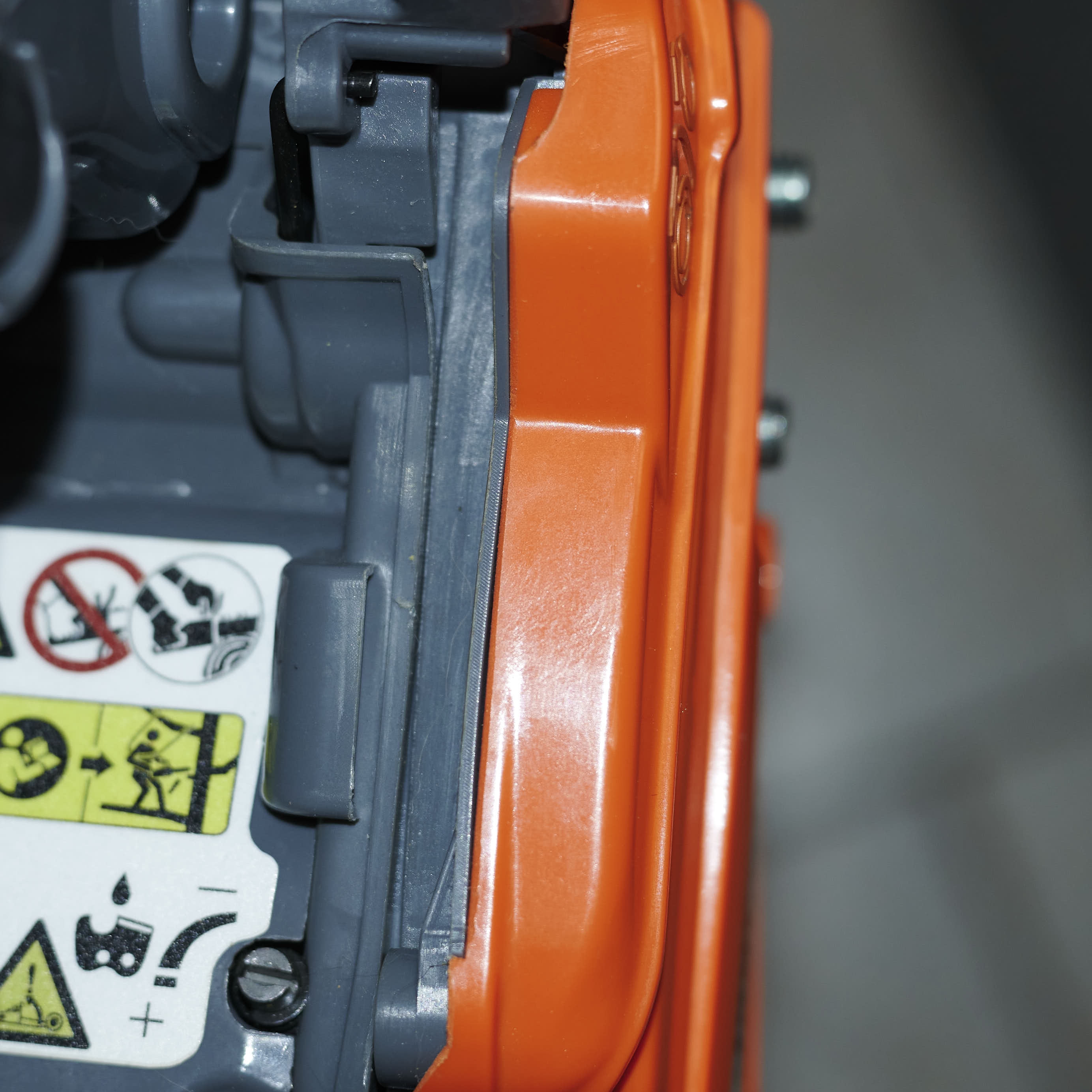

The Joncutter G2511 I bought from Az had the brake tripped when it came out of the box. No amount of leverage was going to reset the brake lever without breaking something. I took it off the saw and the mechanism that holds the brake piston or whatever you call it was misassembled. There are some pins that are supposed to ride in slots...they weren't in the slots causing the brake to be jammed up. I finally got it back together and it now works fine.
Check to see if your saw has a bulge between the chain cover and the piece of gray plastic that holds the brake actuator mechanism to the cover. It should be at least as flush looking as this one, but if there's a gap, it could be that the mechanism isn't assembled correctly.

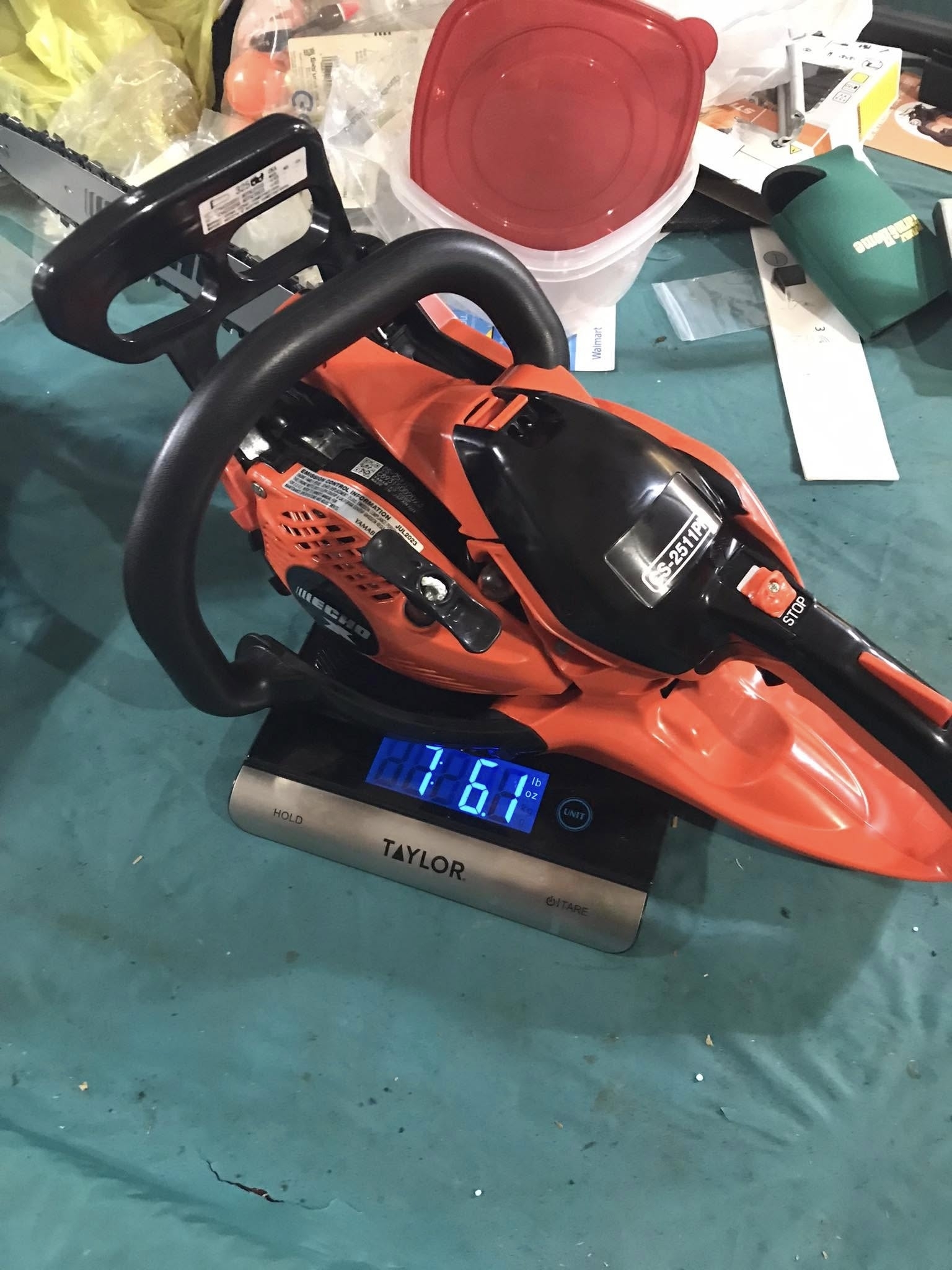

Once you went this way with these super light saws TH and rear.
It even makes the light 50cc saws feel bulky and even my 35cc top handle 200T clone. .
The little echo's have spoiled me. I only grab 50cc rear or 35cc G111 TH if over 12" anymore.
Man when they come out with clone rear handle I'll grab a few more. 1 for me and 1 for dad for gift.
Weight as used with b+c and tanks full. :ROFLMAO:
