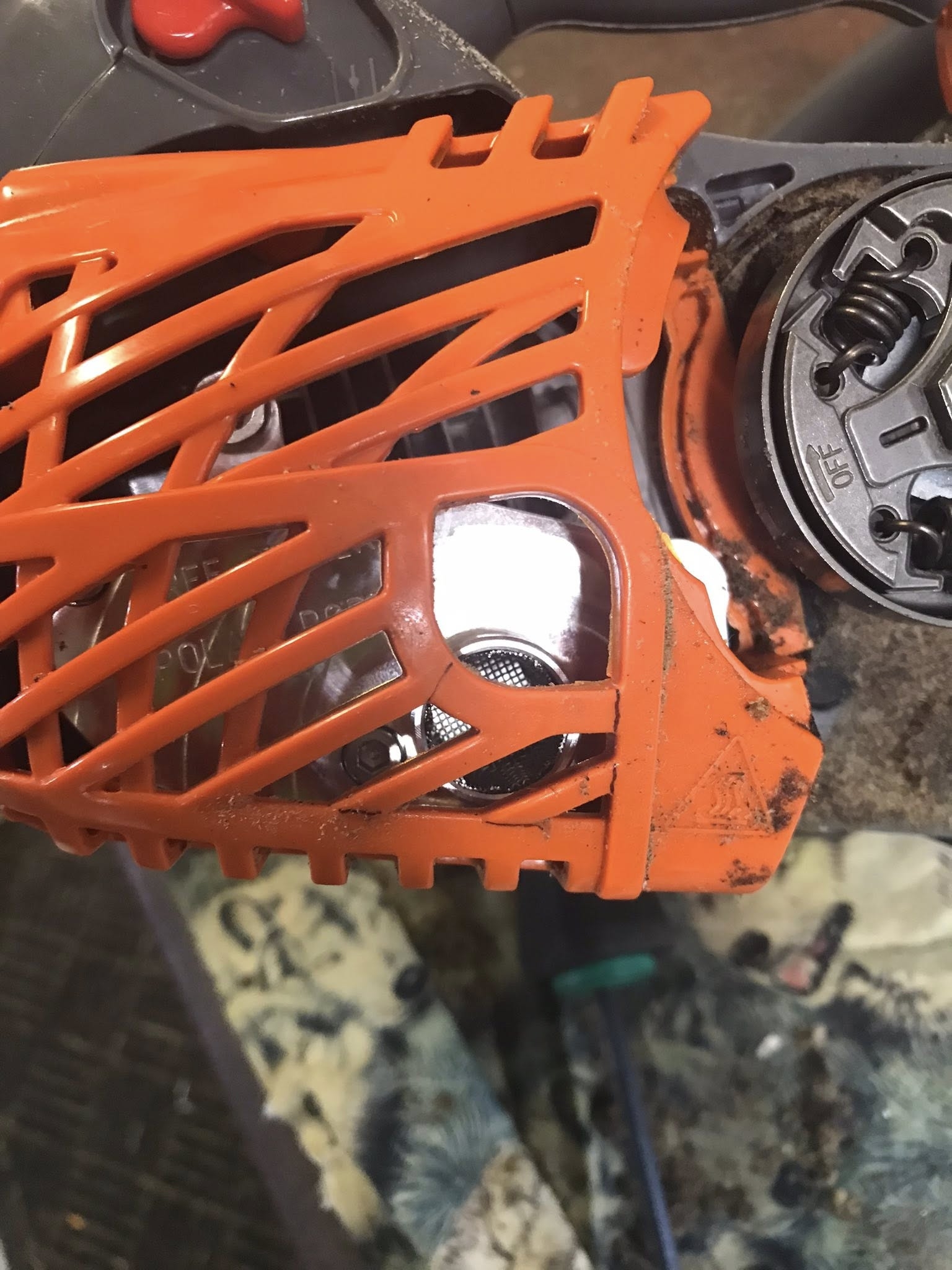

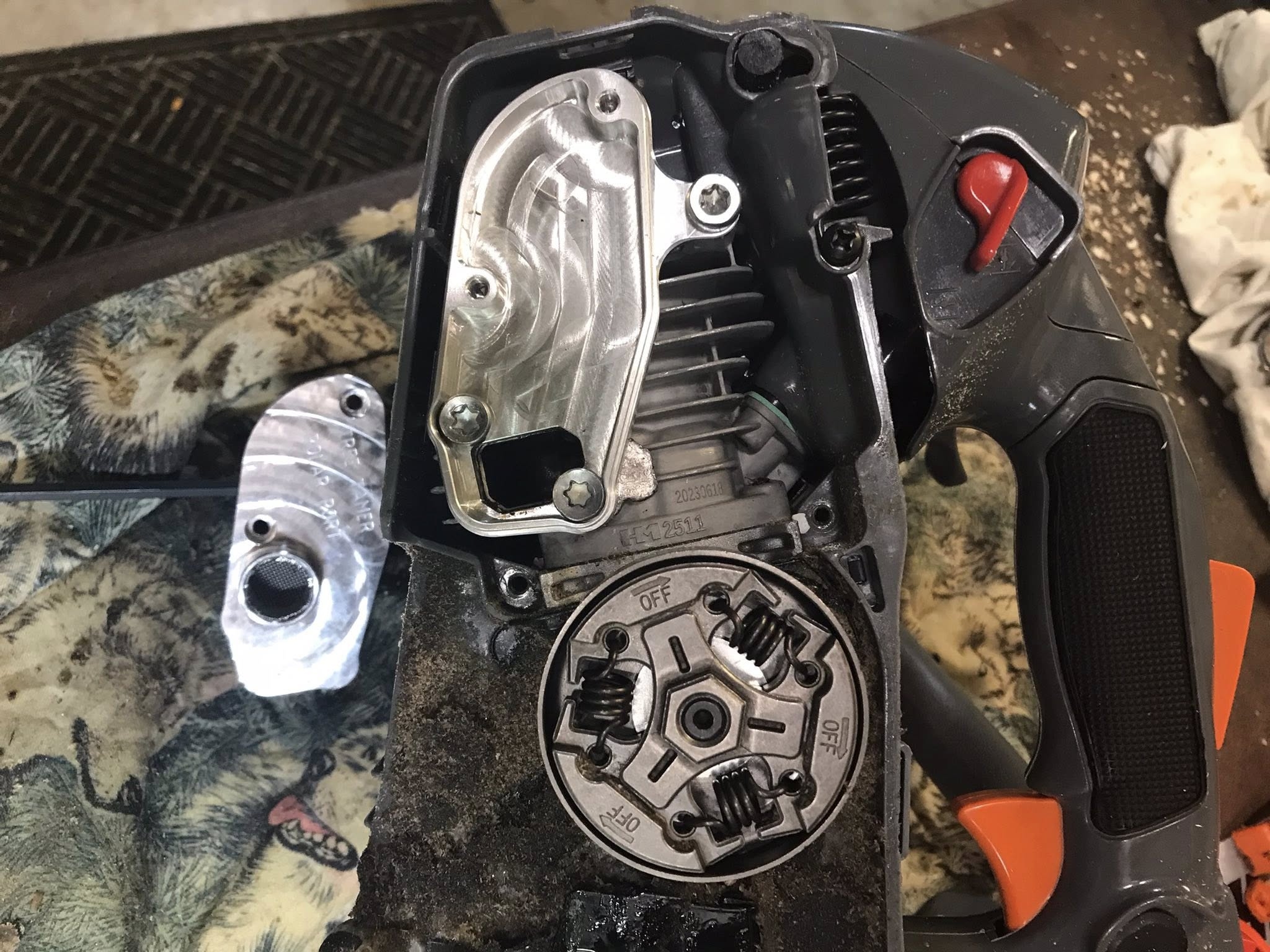

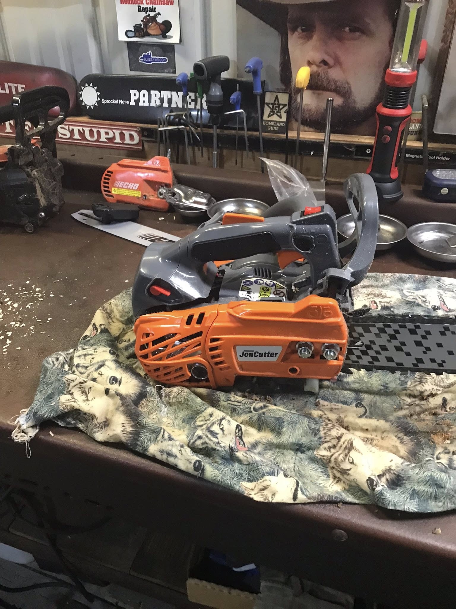

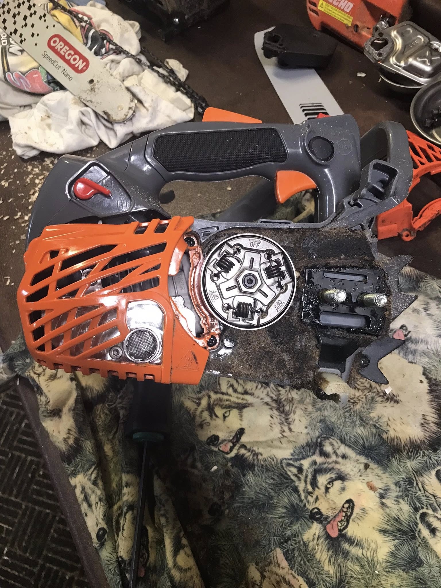

Instead of shaving the back mount on cnc mufflers to run on clone 2511. Like Scotty showed.
I decided to run 2 gaskets since no heat shield used on clones to make up that space.
PSS V2 on the Farmertec 2511.
Egan pipe going back on my oem.
   / I just bought an Echo 2511t clone for $99. What was I thinking? #267
Be warned for some reason the clone like the V2 over Egan.
Other guy is going to test it on his ported one to see.
OEM likes the Egan best.
   / I just bought an Echo 2511t clone for $99. What was I thinking? #268
Took out the slowest cuts of each of the clone cuts out and took the fastest cuts timed to compare.
IMHO Egan or a PSS V2 best for OEM or clones.
Stock clone pipe open muffler 13.41
PSS V2 10.70
Egan 11.16
