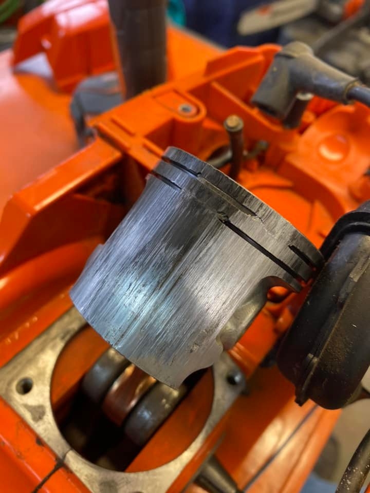

Husky has the Friday built saws too. Was alot of them too.
Stihl too. Friend just showed a new stihl the squish was off and hitting on one side. Needed lathe work to fix it.
One thing I can say. I have yet to see a piston installed backwards in a clone. Like oem has as shown below.
But have see clones with brake spring deal installed backwards.
