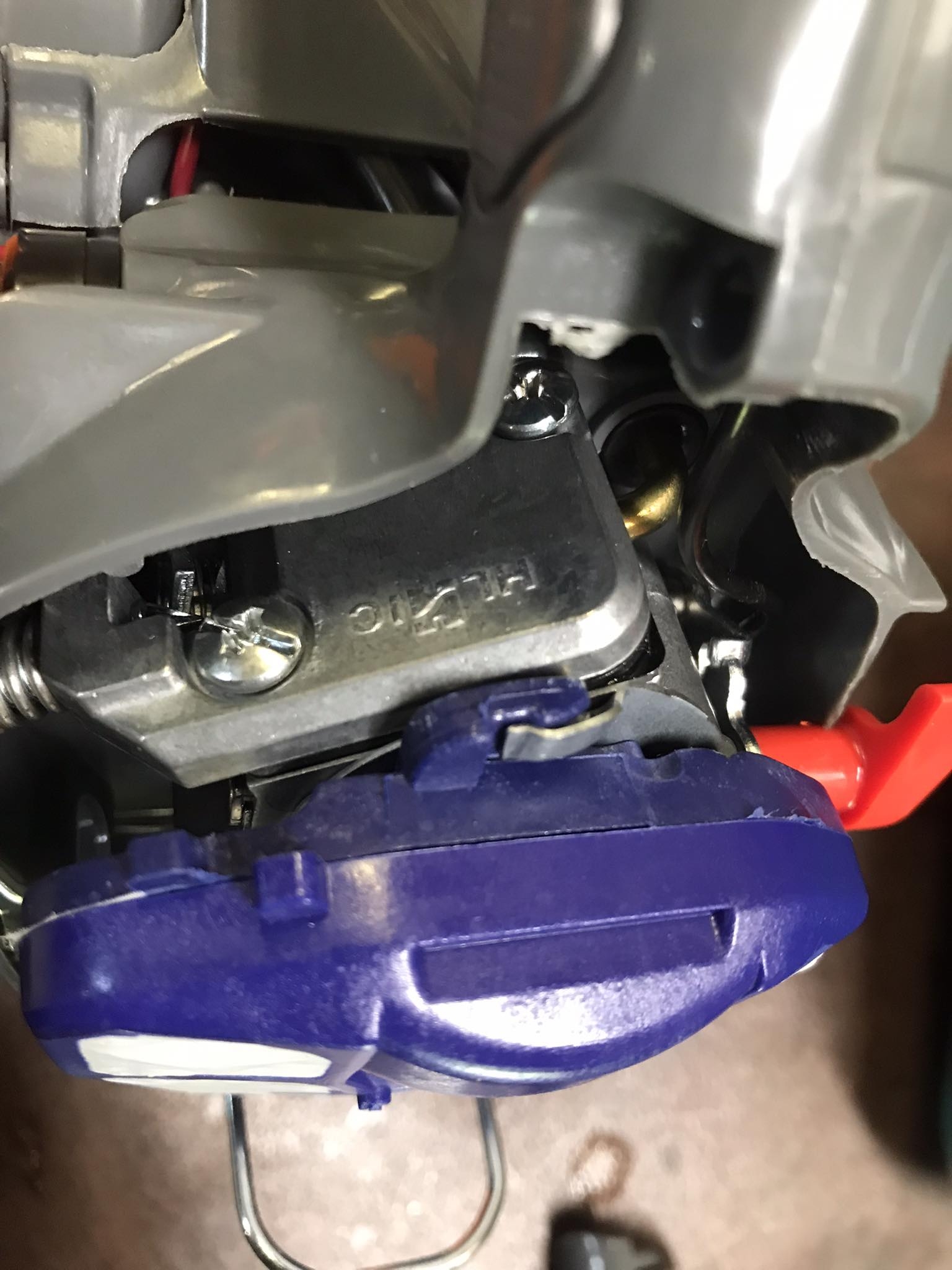

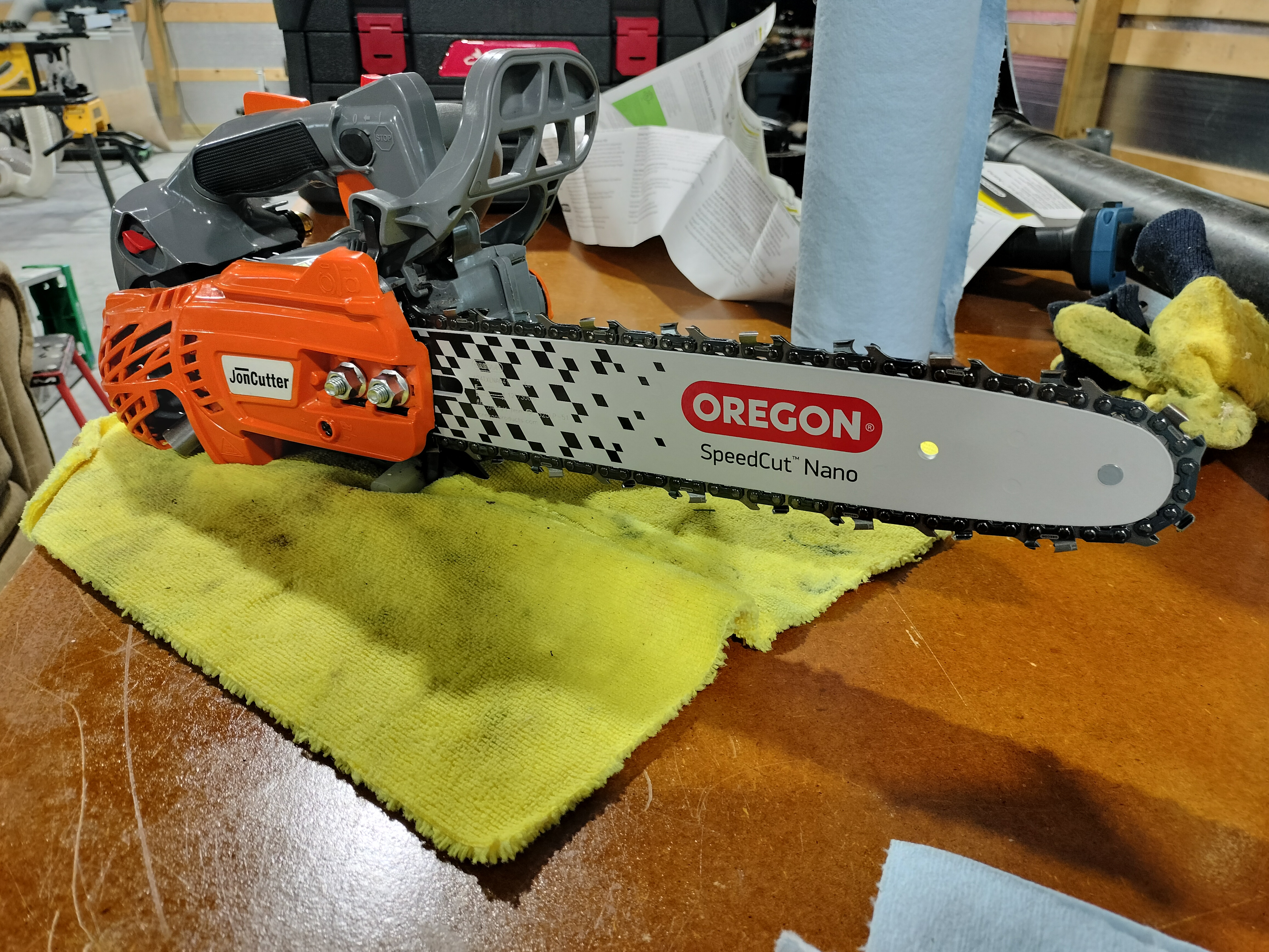

An issue has cropped up with the saw. Gas tank is empty after setting on shelf a few days. 1st time it happened, saw wouldn't crank, tank and primer bulb empty. Left half a tank in it friday, empty today. Use Red Armour and red oil around plastic at air filter and carb housing and at spark plug cover, run down plastic to bottom of saw. Doesn't seem to be leaking from tank as saw has no red oil at front of saw. Don't understand what would siphon fuel from tank to rear without running.
   / I just bought an Echo 2511t clone for $99. What was I thinking? #325
Check bar oil tank. I have heard of guys that have oem had this happen before. Usually after a drop etc though.
Dump it in something clear.
Have some other ideas if not in there.

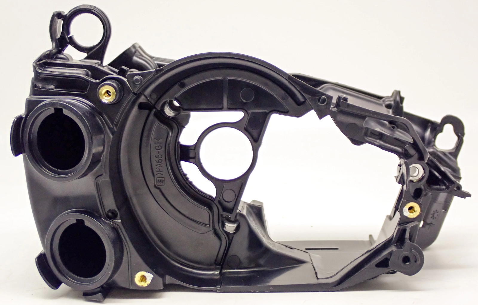

No fuel in oil that I see, bar oil correct level. Would be running out when cap removed as much fuel has disappeared. Grey plastic with decal beside oil adjustment has the red armour colored oil on it some and the 2 fuel lines that show there also have a red film. The plastic plug cover had noticeable oil drops and had run underneath to bottom of rear saw housing. Trying something different, put half a tank in fuel in and laid saw on side with caps in air. Was laying on bottom of case. See no red color on front of saw. Starts at decal and in air filter compartment and down to plug cover

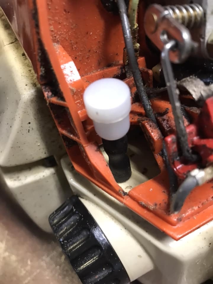

Decal in air filter area?
Pics are worth a 1000 words, show us something please.
Decal in center section. Lift up that piece and look under it.
   / I just bought an Echo 2511t clone for $99. What was I thinking? #328

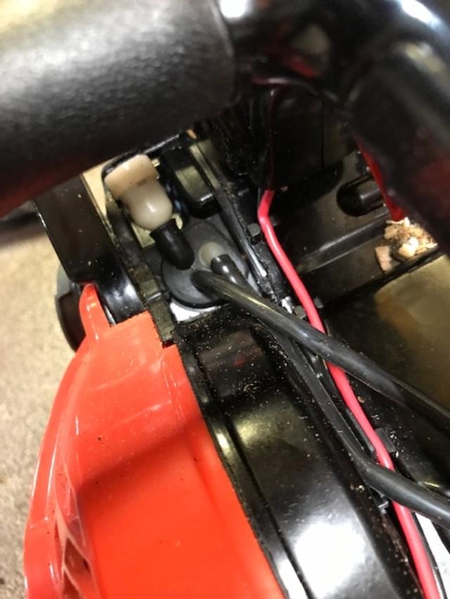

You will see your fuel lines and tank vent under there.
Here I popped one for ya.
Just follow your lines looking for leak.

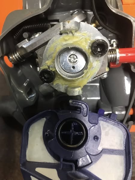

Decal in center section. Has oily residue starting at rear of decal to where fuel lines are visible. Even if a line is leaking, how can fuel be siphoned out of tank till empty just sitting on shelf not running?
   / I just bought an Echo 2511t clone for $99. What was I thinking? #330
I would start at checking or replacing tank vent and go from there. Easy peasy, get into trouble shooting mode.
Your not the first and wont be the last either, it happens oem and afm.
I use those echo style tank vents everywhere I can.
I've seen a fulcrum needle seat let mix by and flood into a cylinder before too. Hydro lock it.
