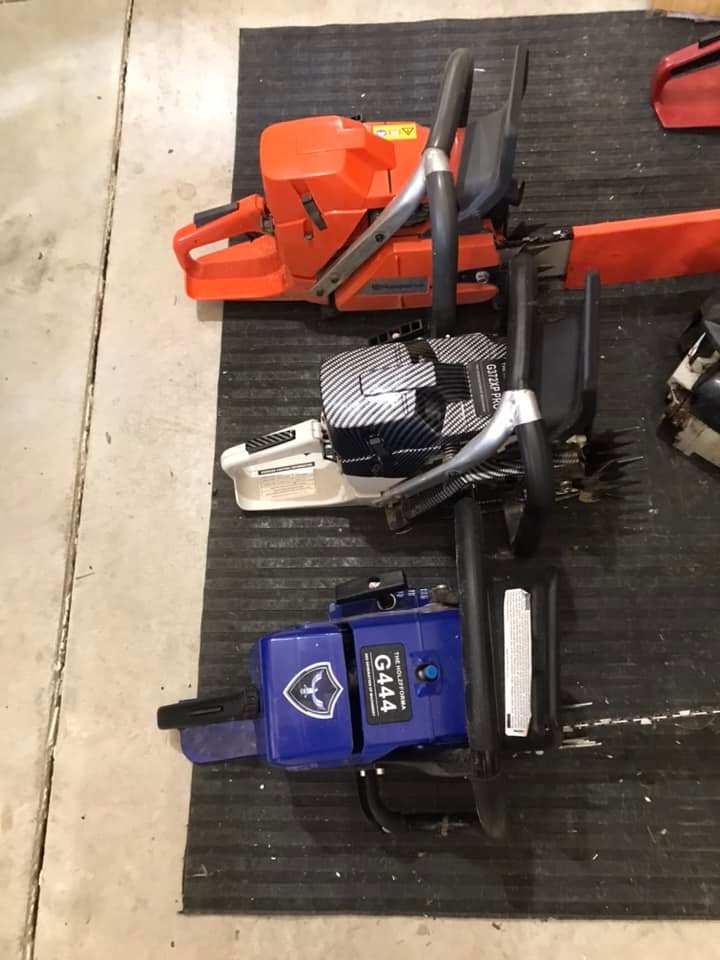

What do you think for the XP372 clones?
   / I just bought an Echo 2511t clone for $99. What was I thinking? #399
@CalG I liked the G372xp pro better then the regular ones.
Even though it comes with goofy looking carbon fiber covers.
Comes with walbro carb, meteor piston kits and better china made cylinder.
Squish etc was tighter like oem one.
Half wrap handles sorta weaklings. If running half wrap grab a oem. If full wrap your good to go. They are nice thick and sturdy.
That right there made it worth it.
Once a guy gets a regular one sorted out they are fine.
But if you buy from Scotty he should have it sorted out for ya before you get it. Nice thing about buying from a servicing seller and not just a reseller.
