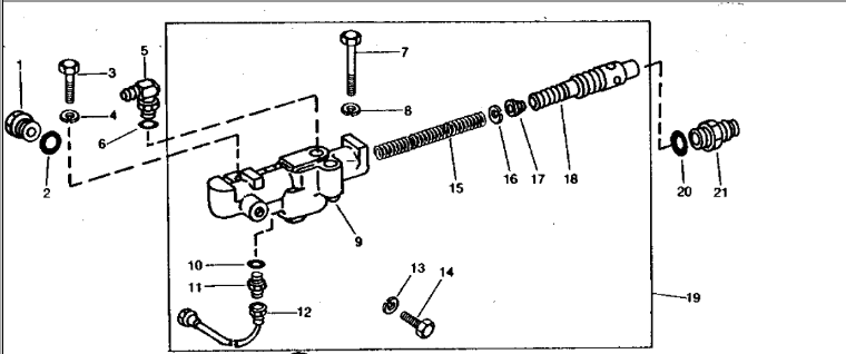

I suggest to check stand-by pressure which should be 2250 psi but can safely be set up to 2350 psi. It's possible pressure control valve could be blocking some flow to 3 pt valves.
