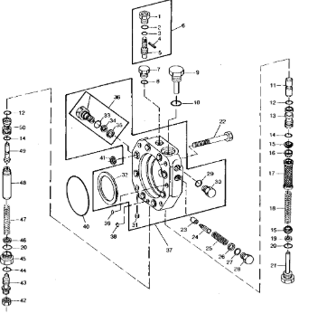

Did you try loosening lock nut then turning screw in[CW](key 43) on frt plate underside of pump to attempt to increase pressure to 2250-2350 psi. Before giving up on frt pump I'd suggest to check pressure in frt of pressure control valve because pressure control valve could possibly be blocking oil flow to rear of tractor. What is your tractors serial number??? If pump pressure can't be increased and pump is going to be replaced I'd choose pump AR94660 because it has larger pumping capacity.

Did you try loosening lock nut then turning screw in[CW](key 43) on frt plate underside of pump to attempt to increase pressure to 2250-2350 psi. Before giving up on frt pump I'd suggest to check pressure in front of pressure control valve because pressure control valve could possibly be blocking oil flow to rear of tractor. What is your tractors serial number??? If pump pressure can't be increased and pump is going to be replaced I'd choose pump AR94660 because it has larger pumping capacity.
My apologies. I hit the 1 instead of the 2. We had about 2500 PSI.
1963 4010 diesel, syncro, wide front, Serial number 4010 2 Stamped -1 T Stamped 36381

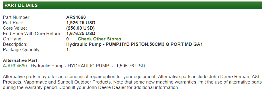

A rebuilder contacted me to rebuild my pump. Is that worth doing or should I just buy a new pump?
Some things can be better than new after being rebuilt. Other stuff you are just as well off to buy a new part.
I forgot to ask a price at John Deere when I was there yesterday.
Reliance John Deere Replacement Hydraulic Radial Piston Pump NAR9466, 9-895 | eBay
   / I JUST CHANGED THE TRANSMISSION / hYDRAULIC fluid in the 1963 John Deere 4010 #29

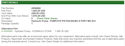

2500 is about 100-150 psi too high. Pump problem could be faulty crankcase valve. The one large problem with attempting to rebuild the piston pump is if the bores are worn I've never heard of a good way to renew the bores. I think oversize pistons are not offered. New pump on Amazon is $850. Price for JD and A&I from local JD dealer is in photo below. Your tractor is below serial number 038199 which means smaller pump is listed for the older SN so larger pump might require different hyd fittings. I'd need to do some research to know for sure.

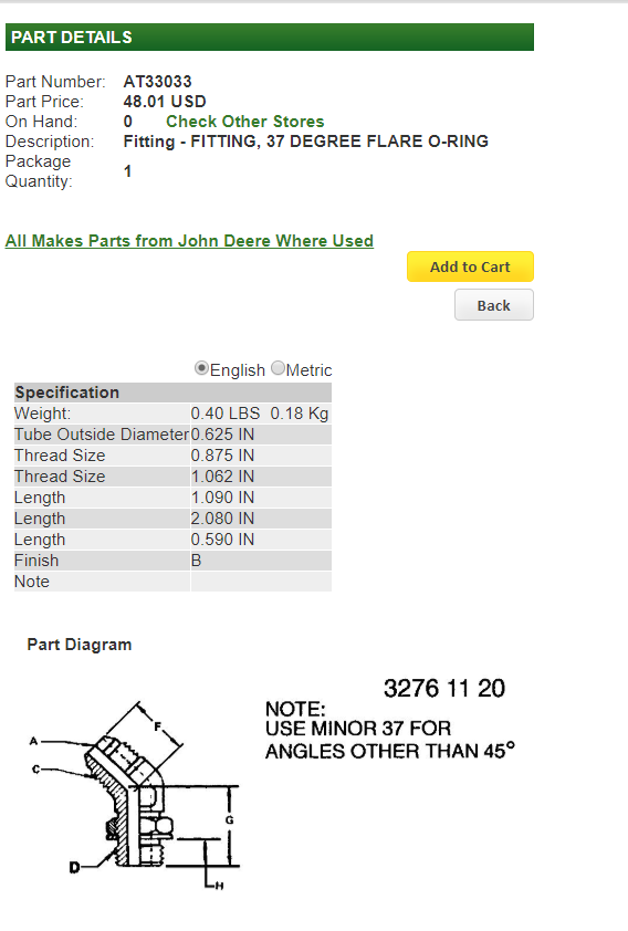

Do you know if your tractors hyd pump has a seal drain line? It would be mounted at lower rear of pump body. Larger pump requires a larger fitting on RH side(AT33033)
