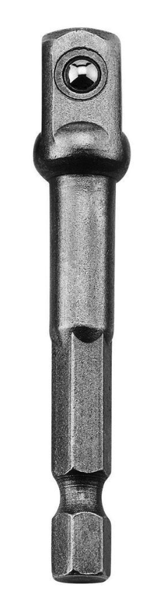

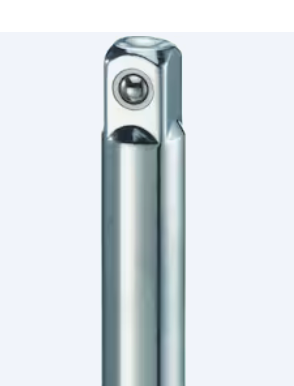

My adventure with Lug nuts:
This impact can supposedly create 1000 ft lbs of torgue, not sure how it is measured.
Facts:
GMC 6500 flat bed truck 10 lug 33MM
MIXPOWER 6-Point 3/4-Inch Drive Deep Impact Socket- 33mm (Metric)
DEWALT 20V MAX Cordless Impact Wrench Kit, 20V MAX, Using an adapter ½ to ¾ broke only 7 of them
The 3 others used a 6 foot long pipe on a breaker bar with me 200 lbs standing on the end of it bouncing up and down
   / I keep breaking 1/2 ratchets on my lug nuts. #162

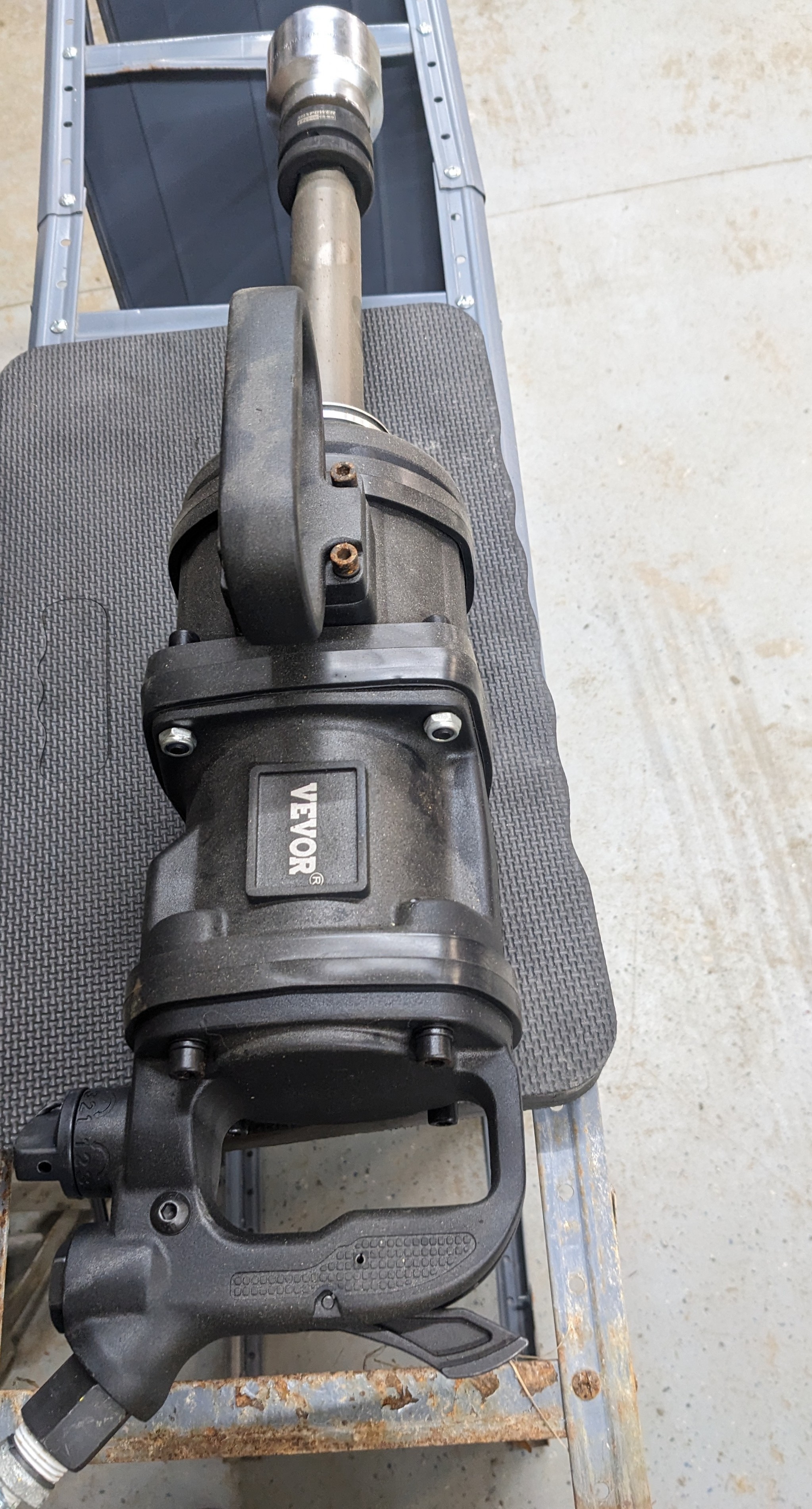

I had a busy local tire shop put new tires on my GMC dually. Miles later I decided to rotate the tires myself. I was 260+ Pounds and had a heck of a time loosening the nuts. I used a 2' breaker bar and really leaned into it. On every nut, it just popped like a gun going off when broke loose because they were so overly tight.
I was concerned about a wrench breaking beside the road in the future so I needed a fix. Every time I take the car or truck in for tire work I recheck the torque after I get home, even though I make them aware of my concern. The last time I checked when home, all the nuts were good except one whole wheel was a bit more than finger tight. I check for tighness and also to make sure they were not overlooked.
Because of this thread I bought a 3/4" 40" breaker bar and sockets. I do have a new torque multiplier I bought a couple years ago but I thought a breaker bar would be easier to figure out when changing a tire at midnight on the side of the road.

Had a tractor with 1" bolts in the drawbar so I bought a torque multiplyer 250 ft lb 1/2 drive in 1000 ft lb3/4 drive out. Just needed a good prop for the reaction bar.
