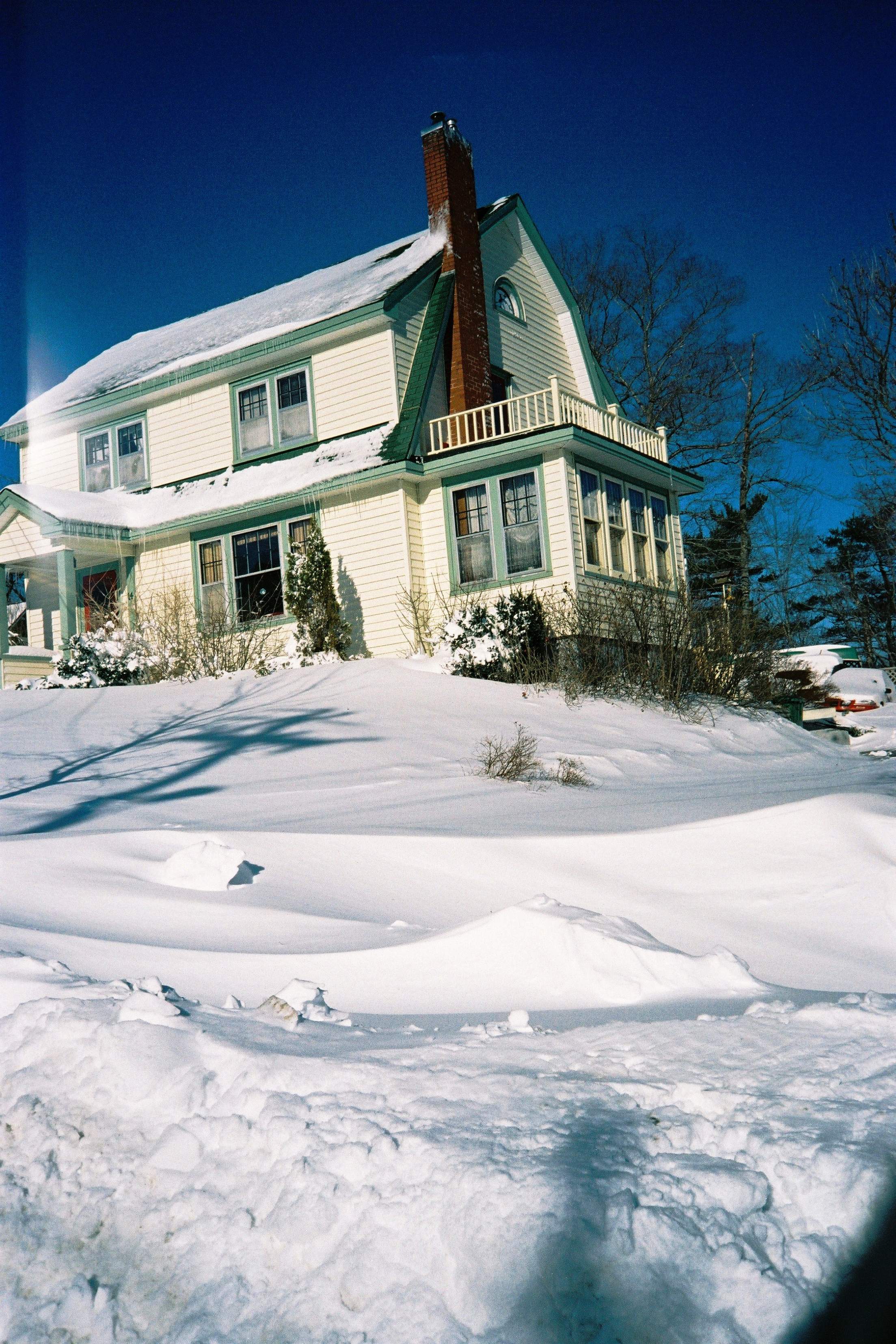

Attached picture shows one driveway. A Kubota B7100 with chains would be unable to drive through using a backblade. Neither could it push snow backwards with the backblade. And, seeing as it can't push through with the loader it would not make it with a front blade. That driveway has a 20 degree down slope to the road.:D
