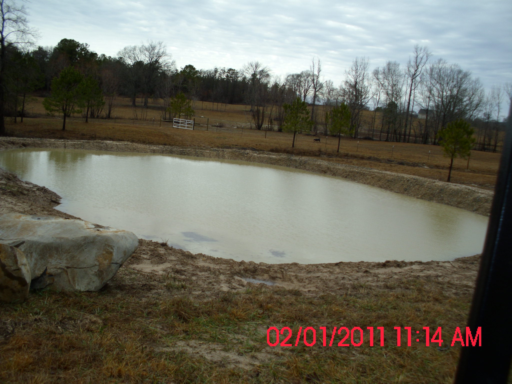

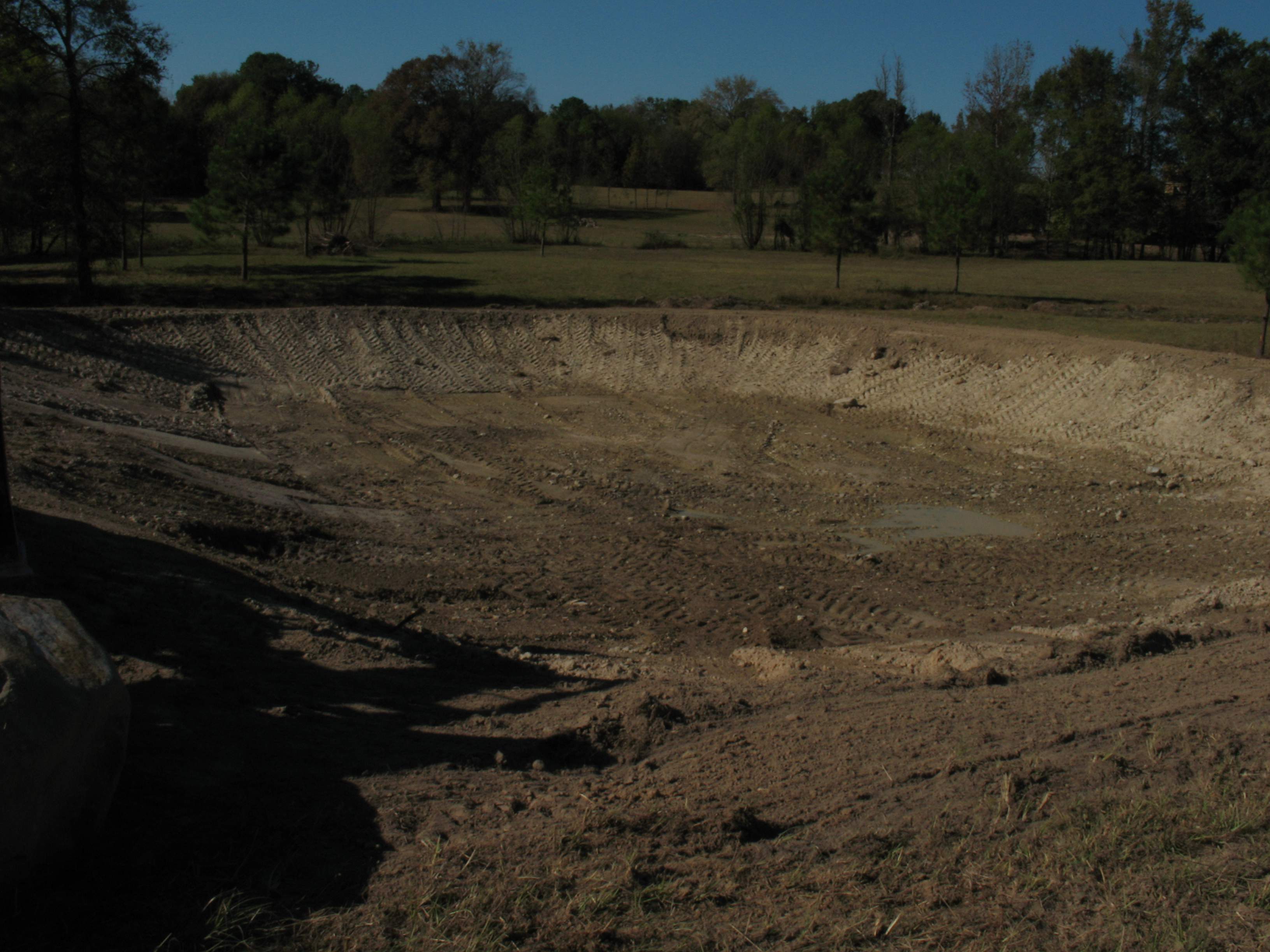

small pond 2-1-2011 003.JPGIMG_0824.jpgoctober 2010 021.JPGYou might be able to clean out the old pond if you cut the dam so all the water drains out and continues to drain. It will take a long time to dry out enough to get in with a tractor. When the muck looks dry on top it will still be a quagmire underneath. A track loader would be your best bet after letting it dry out for a couple of years.
As for your pond, a combination of box blade using scarifiers to loosen up the soil and then drag as much as you can to the dam area while at the same time filling your FEL with a full load is the most productive. It does take some coordination with the controls to work all the hydraulics. When you dump your BB load, you will have to back over it and then on your next pass, push that load up on the dam with the FEL. RINSE and REPEAT several hundred times.
If you loosen the soil with the scarifiers, you wont need a toothbar to dig since you are just gathering up the loose dirt. When you get your dam the height you want it, you will need to strike off the top so it is flat. Also the dam needs a backside (opposite the water) taper of at least 4 to 1 so it will hold the water pressure AND most importantly be able to mow it safely. The top should be flat and as wide as your tractor, then begin the taper. You may want to do the flattening and back tapering more than once before the dam gets too high. It is pretty scary trying to drive around the levee knocking down the mountain of dirt when it is 6 or more feet high and peaked up like a mountain top.
When I build my pond, I used the tractor tires to walk up and down the levee and the FEL to strike off the top several times so I could walk it down compacting the soil as I went. Then I went to the back side and did the same thing, driving to the top of the levee, lowering the FEL to flatten the top and backdragging it down the back side. When all was to the height I wanted, I walked the tractor up and down inside and out to pack down any loose dirt , then walked my smaller tractor around the top again to widen and flatten the top. It took me about 2 days and 15 engine hours to build my small pond
