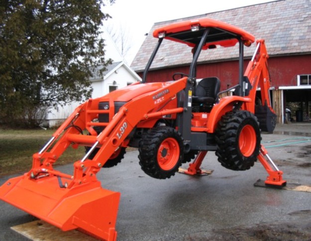

A couple of other random comparisons: L39 has a very tight turning radius, and I'm fairly certain it is tighter than the 110. It also weighs less, a full 1000lbs less so its easier to transport and less damaging to the earth (lawns). Whoodle has a huge trailer and dual axle Ram tubo diesel, so he's not concerned, but for the rest of us weight might be something to consider. The L39 has three hydraulic pumps, one is specific to the hoe swing. I'm not sure the 110 has an independent hydro swing pump. The hoe is extremely accurate. The hydraulics are enclosed in the hoe and the belly is relatively clean. The 3 cyl diesel is very efficient. Attached is a picture of the L39 on all three legs. As you can see the stabilizers give quite a bit of lift and they are massive cylinders.
