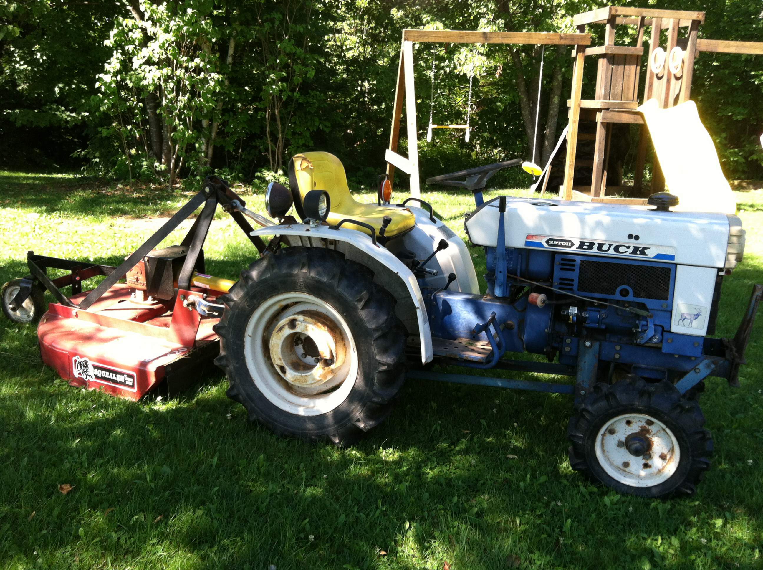

My new 42" Bush Hog

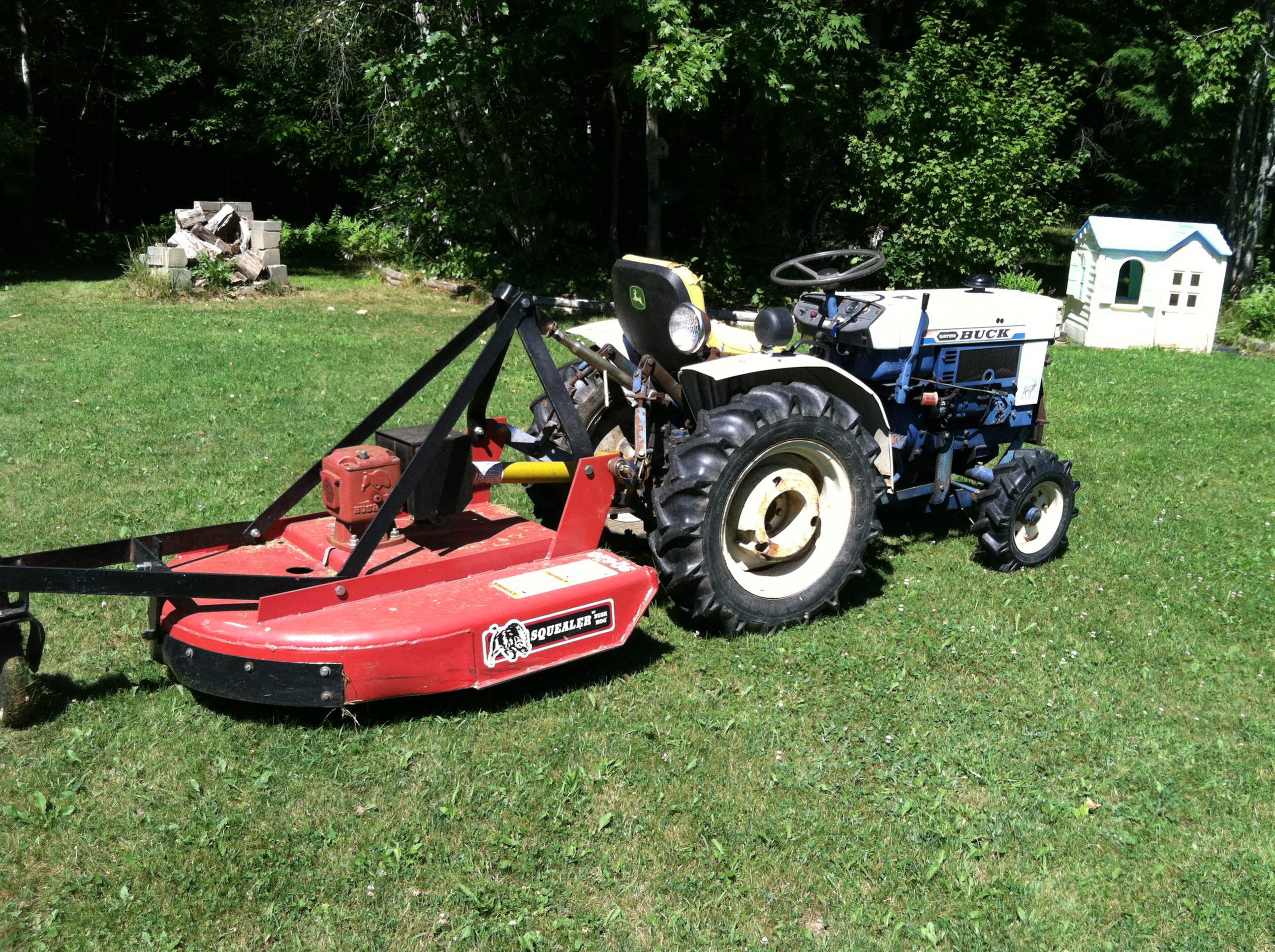

You can kind of see the Flywheel in this pic..
Thou the pic is too small

mike, Sorry I just now saw this post..
I will get the tire size.. but actually wouldn't recommend that size front. Mine rubs on a bracket under the frontend, bad enough to actually stop the tire from turning. I'd go smaller..
4.50 x 10
Cheng Seng Or something like that.
Actually, My tractor has a bracket under it, that I don't see in you guys pics.. I'm not sure why its there or what it does.
If you double click on my pic 2 posts up, and make it larger you can see some of the bracket, its also has 2 arms that go from front to back.. the whole length of the
tractor. Anyone.??

DSavage, That bracket is not on my Buck, it could be for a snow plow or loader. I don't have either. My Buck is 4WD.

Ya I do have a 54" snow plow. Seems a bit of overkill for that. As you can see here, the brackets that hang down, then 2 more brackets run all the way to the back.

It is a dozer blade, meant for dirt or snow and was built by Blackhawk. You could get it with or without springs (snow use). It had the thick subframe just like yours does. I've seen a couple on beaver 3's that looked the same
