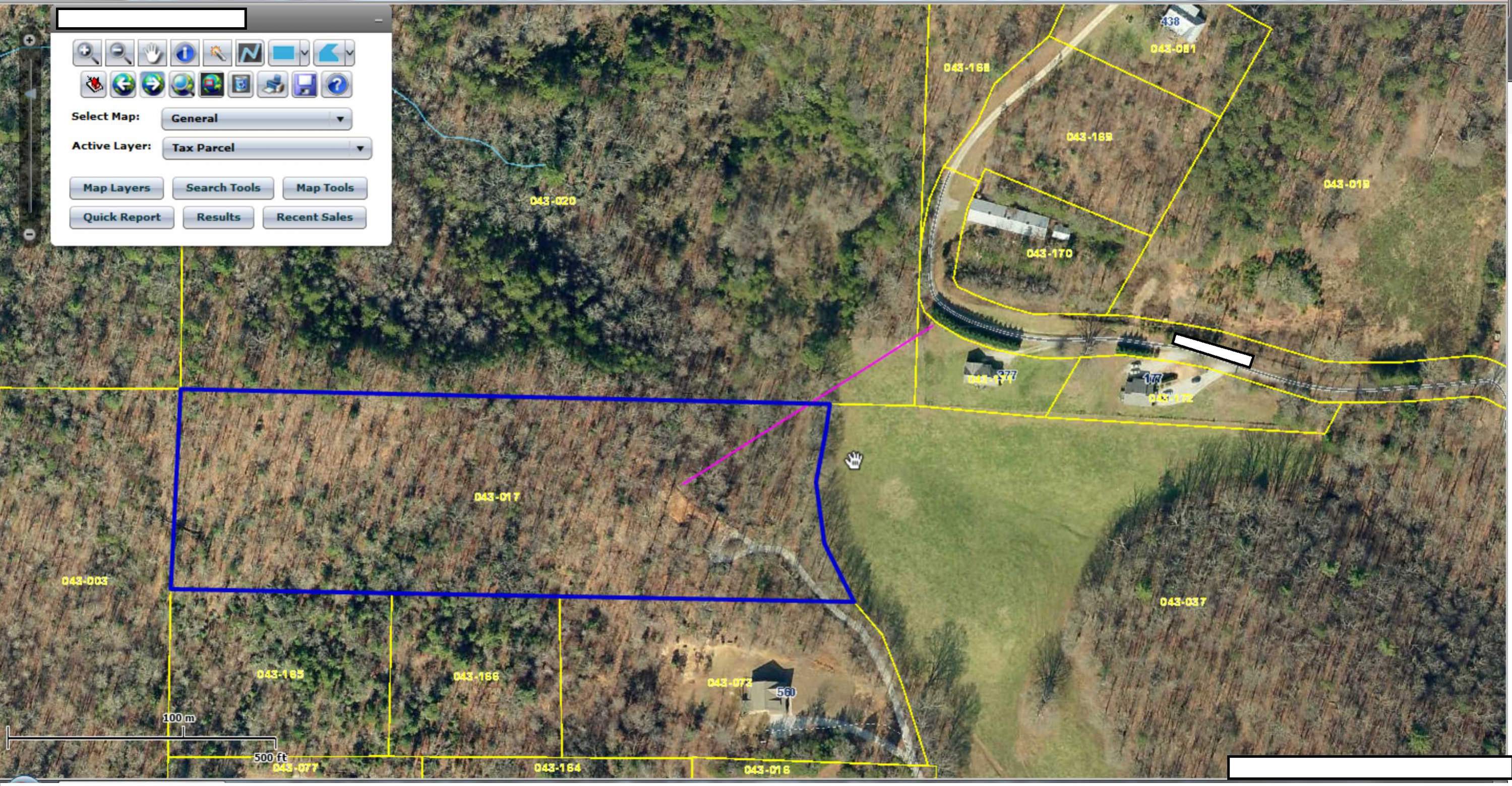

I have a property in northern Georgia that I need to have the local utility company get power to .Right now I only visit it with a camper for a week at a time.
I met with the local guy and he says it is my job to get permission to run across my neighbors property. Has any one here had to do this ? I live 650 miles away from this property and I don't know where to start. How do I start? What is the procedure to do this? Is there a form the I can download for property owner to agree for me to do this?

I assume you mistakenly put this in the tractor forum instead of some other forum. Anyway this sounds backwards, I think the electric company is responsible for getting power to your property and then they use the easement on your property to get it to your house. Talk to a lawyer from that area.

Well surely the guy below you (043-073) has power.....why wouldn't you simply come along the driveway off the line that feeds his house ?
Beat me to it. Peering around on Google Maps, it looks like everyone has underground power, so it should be doable...

Looks like you have a driveway with easement through other properties. I'd just trench in the power along that existing easement. You will have to give the power company permission to use that.
Around here, land that was developed with access easements usually also has a utility easement drawn into the plat. It should run parallel to the driveway. If it's a shared driveway or private road, the everyone's easement will run down along the roadway and then "peel off" onto each lot. If you're at the end of the line, you have the longest easement.
Also check to see where the nearest transformer is servicing your neighbor's house on the same driveway easement. That shows how far the power company has run high voltage lines. Should be able to tie into them, run down your driveway easement, and then put up another transformer for you.

Yes, I have a driveway across the neighbors lot (deeded access) and I could get access that way. The picture in the original post is before the drive was finished around the loop. I was hoping not to have to tear up the new gravel driveway to trench a line in. This neighbor has said it is doable if trenched not overhead. This maybe the best option.
I was hoping there is a form I could take with me to get a signature of approval from him. I would not just send the form as I know if I received this in the mail I would put it in the circular file also. The distance for each run is about the same 500 feet. And the cost is $7.25 a foot for direct burial, installed. I tried to get a form that would suit for the county to record this but, no luck yet.

Where does the neighbor that you drive by to get to your property get his power? Could you not extend from his service pole along side your driveway until you reach the area you want a service tap set? The thumbnail looks like a GIS or Data Explorer image. Obtain the neighbors names and call them by phone to determine how receptive they would be to you obtaining an easement. If the line you have drawn on the thumbnail is your preferred line for the service line, I have questions about the two property owners you will have to cross granting one. This may be the shortest and cheapest route for you, but the other property owners would receive no gain by granting the easement.

Our utility in PA charges from the point of closest service. In this case, your neighbour along the driveway seems to be about the same distance as the line you indicated. Trenching along the driveway easement would seem like the way to go.
When we built, we were looking at a couple of grand for the service, due to the length of closest service. You get 300' free, and pay after that. The local engineer assigned to my job saw that there was a "building lot" below us in the woods. He coordinated with the owner to put a service drop on that lot (free since under 300'), and he then went from the corner of that lot closest to our site. This shaved hundreds of feet off of our line, and in the end I paid for the trenching, but only $ 360 to the utility. The utility dropped a service cable in the trench to the empty lot, and a HV cable through there to our lot, with a transformer near our house.
