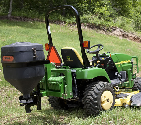

Does anyone have experience with this one? Northern Industrial 3-Pt. PTO Spreader, Model# 1104S095 | Ag Spreaders | Northern Tool + Equipment I can't tell if there is an agitator in it.
I hate to revive older threads but this particular one has merit. Significant history and experience of folks using their sand/salt spreaders.
A few questions I have:
1) I also have a very steep hill on my driveway and would like to use a 3 pt. hitch spreader but many of the previous links (especially to TSC) are no longer available (all I found was this =<CLICK HERE>=). Has anyone had good/bad experience with their hopper?
2) Any good tried and true set ups or ideas on how you fill your hoppers?
3) Controlling the spread ~ I also want to just throw about 8 - 12 foot and imagine just lowering the hopper closer to the ground would do just that...or am I mislead?
Thanks everyone~

I have a drive that's 450' long and some places over 20% grade and use a Beyer salt and sand spreader that works in a standard 2" receiver.

The red metal version looks identical to what I have, but I bought mine local at "Big R", a typical farm and feed store. It works well with dry sand- at the slowest RPM and nearly dragging on the ground it spreads far wider than my road. I need to make some plates to redirect the sand on the road better.
I used it for fertilizer this summer, and it was great- very fast, and boy did I fertilize... I'm pretty sure the neighbors three doors down got some, it was throwing so far.
