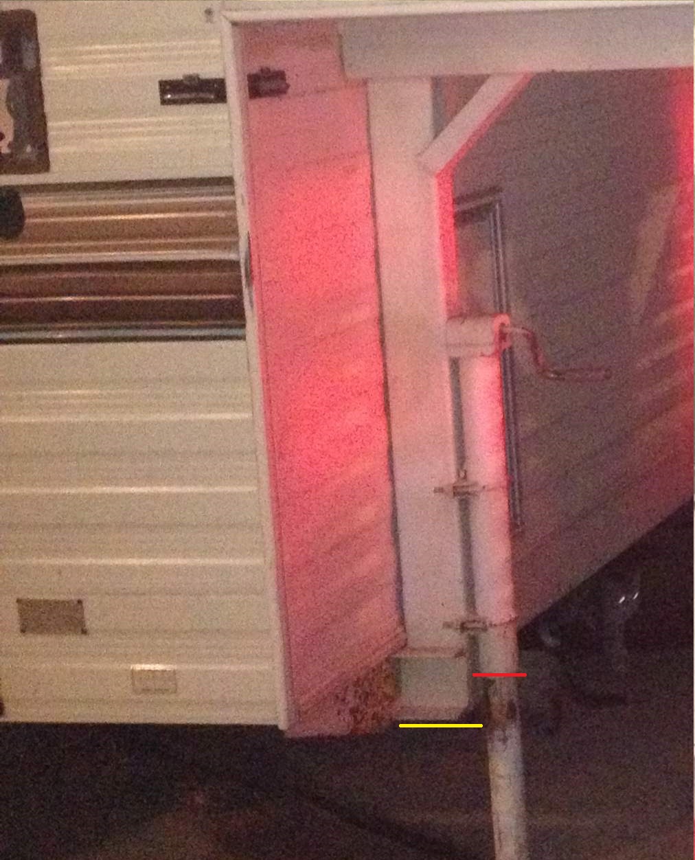

The problem is that with the camper jacks maxed out even with 8" blocks under them I have less than an inch of clearance with the ball.
Looks like the jacks are held on with U bolts, Why not loosen them and slide the jacks down 4-5" so the fixed tube of the jack is even with the bottom of the frame ibeam (ie: so that in the attached picture, the red and yellow lines line up)?
Aaron Z

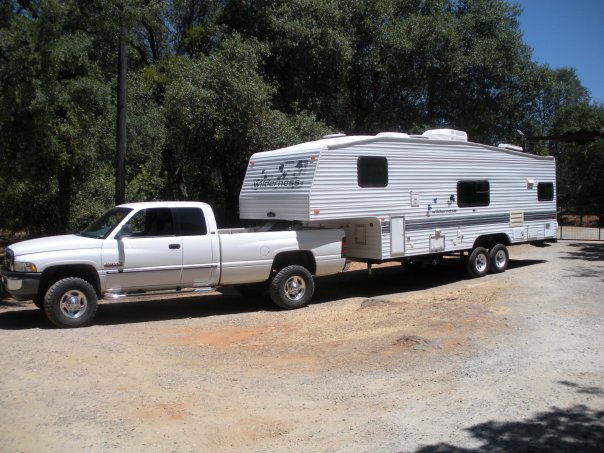

Flip the 5th wheel axles. The truck is too tall, and you can't adjust your pinbox to make up that much(on the compact 5th wheel, do you have adjustable pinbox?).
My stock Ram 2500 is tall enough, that my '98 Wilderness 5th wheel needs the flipped axles. Otherwise the back of the bed would be hitting the underside of the RV. My 5th wheel effectively has about 4" of "lift kit". It matches my truck great, but I carry 4" blocks to put under the jacks. And, the bottom step at the door is at an odd height. And, there is a large space in the wheelwells.

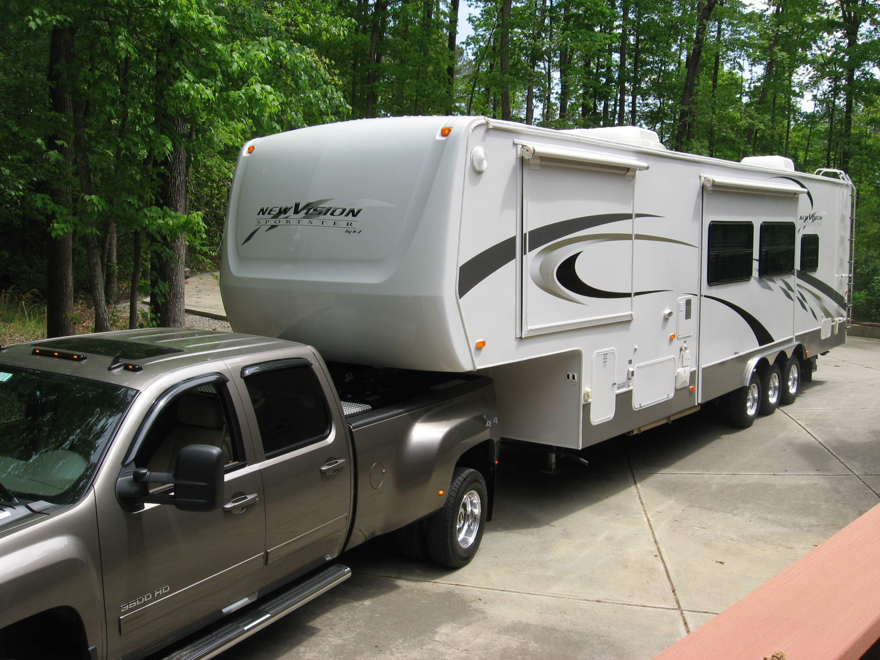

I had to do the same thing when I bought a 2013. All 3 axles on my Toy Hauler. Also had to modify front and rear steps splitting the difference between first and last step into RV. Works OK once you get used to it.camper 012.jpgcamper 001.jpgcamper 011.jpg

The jacks are tack welded in addition to the U-bolts. Taller blocks under the jacks would also meet the need.
