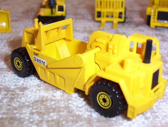

I have a lot of deep topsoil to move from a large area, and my FEL or a box blade would take forever. I don't have access to a dump truck either. Since I need to move the dirt several hundred feet, I would like to move at least a couple of yards per trip to avoid wearing me and my tractor out.
Attached is what I need, only in full scale. Unfortunately, the model is closer to what I can afford. /forums/images/graemlins/smile.gif
Has anyone built a pull-behind earth mover (or scraper, or whatever one would call them)? It seems very simple to design and build, but I don't want to re-invent the wheel.
I can envision something that is pulled with the draw bar, and the 3 Pt hitch would manipulate the blade and the dumping action. I could plow the topsoil and wait until it dries real fluffy because I have way more time than money. A long wheelbase should help prevent gouging, and result in nice level land on both the new area and the donor area. I hope I could pull it pretty fast and skim 2-3" at a time, and dump it in layers. Does this sound possible?
After the dirt project is finished, the implement would still be great for landscaping and road work. Any examples or ideas of such an implement?
Thanks!
