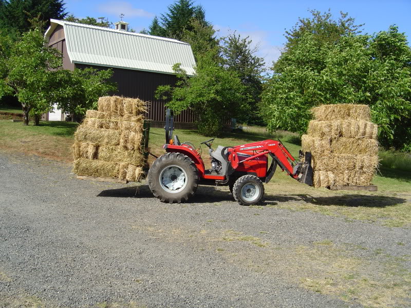

If I were you I would buy a set of 3pt forks.
They are cheap and you can pick up a pallet with any amount of things that weigh your desired counter weight amount.
Later on you will be surprised how much you can carry with forks on the front and back. :D

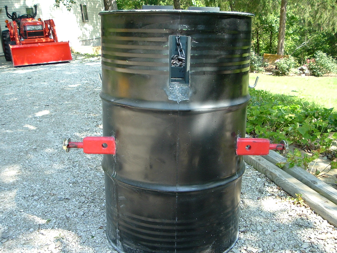

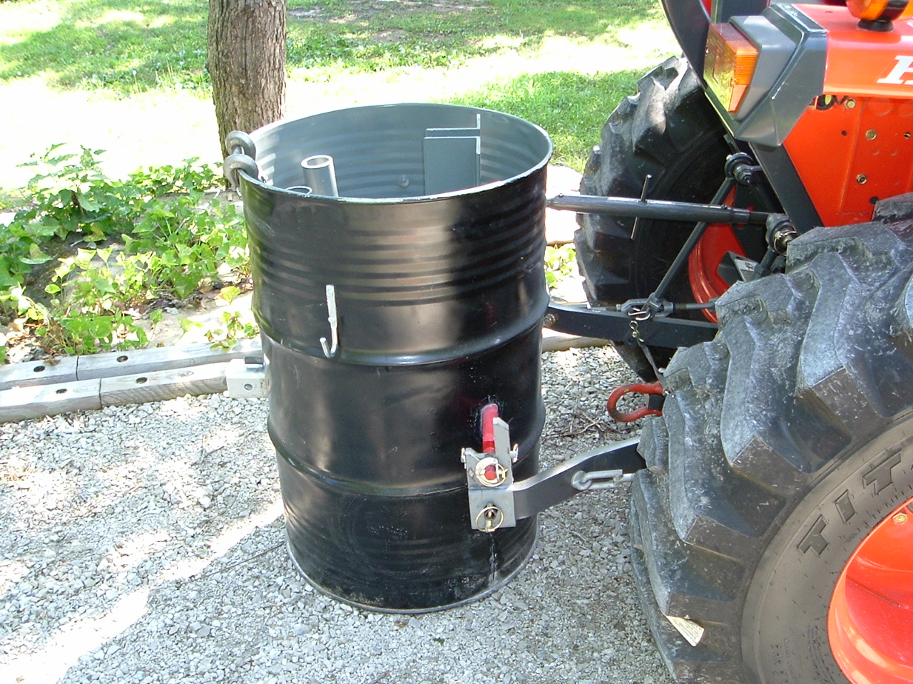

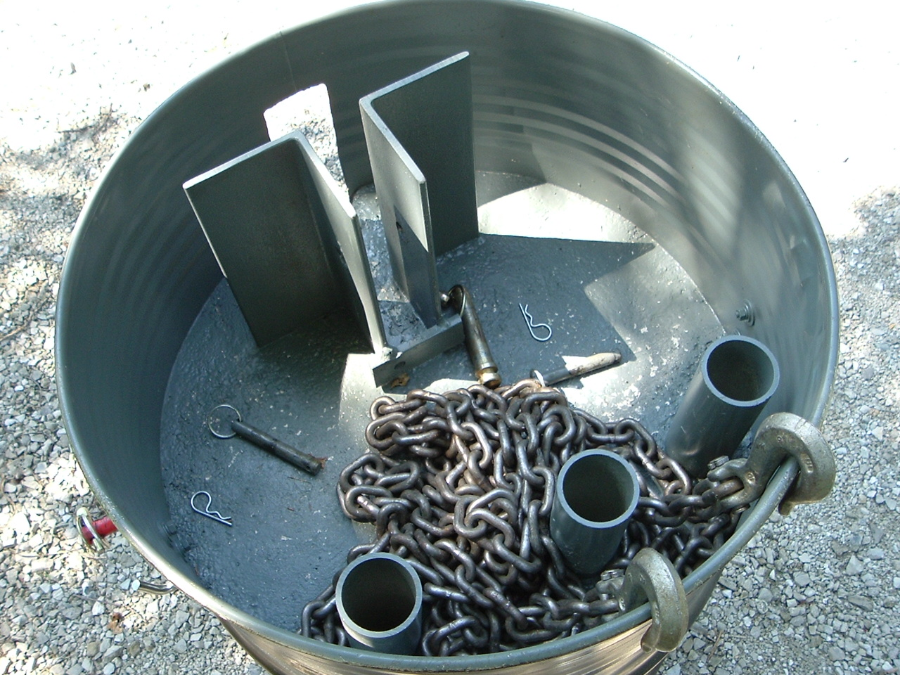

You could build a simple temporary counterweight from a barrel and a drawbar using basic hand /power tools. transport it empty then Fill it with rocks, gravel, dirt whatever at the new location. Once you get the tools unloaded you could make a more permanent counterweight from the same parts and a little bit of steel.

I got a 55 gallon barrel; I'll get the Cat 1 drawbar from tractor supply, my friend has a welder and we can cut steel with my air cutoff saw, slow, but it will get it done.

Use a hole saw.. cheap from lowes or home depot. for the 3/4 hole. much easier and safer than a 3/4 bit anyway. you can use two pieces of angle steel. bolt those to the drawbar turned vertical inside of your 55 gallon barrel. By the way your front end loader connection system is called SSQA (Skid Steer Quick Attach)
