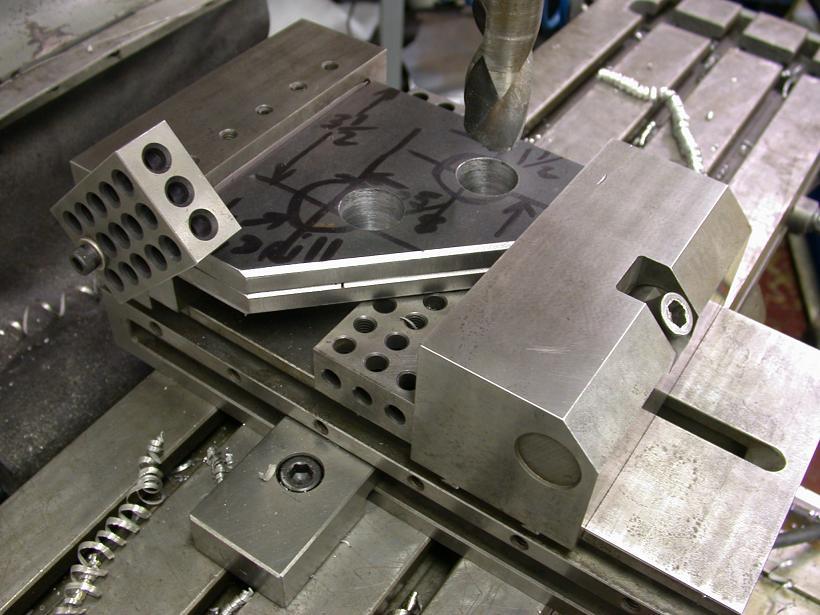

Hi Alan,
I just finished drilling 4 holes on 2 brackets stacked together.
Drilled thru 1" thick.
-center drill
-Ø1/2" drill thru
-Ø1-1/8" drill thru
Less than 5 minutes including set-up and indicated.
2 HP Bridgeport mill, DRO, collets, clamp kit....$10,000 (then)
Interapid Indicator, Indicol, 1-2-3 blocks..........$250
Drills ............................................................$150
14" Custom made milling/grinding vise & clamps....150hrs+
2 beers...............................................................$2.50
Chance to share pics with TBN buddies....PRICELESS
Ha...and the holes are for clearance!!! /forums/images/graemlins/confused.gif

Gee Rob,
I could have sworn that I used those same 1-2-3- blocks yesterday /forums/images/graemlins/grin.gif /forums/images/graemlins/grin.gif /forums/images/graemlins/grin.gif
By the way, I like your blue print /forums/images/graemlins/grin.gif

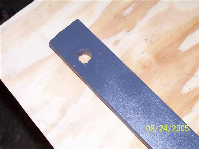

Ok second post on this but here is another poor mans way. I needed some 14mm holes in 3/4" bar for a spacer behind my bumper. Nothing seen when complete. I drilled a 1/4" pilot hole then used the oxy/acet to do the rest. This one was freehand and you can see where I moved on one side. I could have taken a little more time to make a wooden guide from wood. But this'll do. Only about 5 minutes for 4 holes. Not pretty but it'll work and I didn't have to buy an expensive bit. The pilot hole helps the torch to get started with a clean cut all the way through the material. And yes the hole is supposed to be off center. The upper bumper holes on the L2500 are closer to the sheet metal than the center of this 2" bar. /forums/images/graemlins/grin.gif
