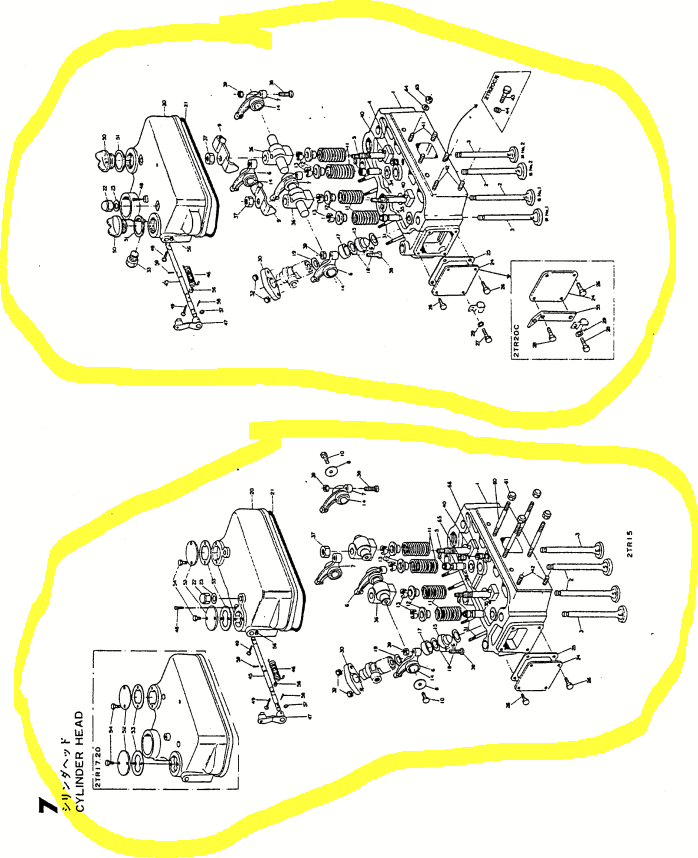

I need help finding Yanmar 1600 parts. Valve cover and exaust

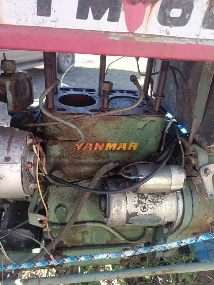

I've looked everywhere, but I cant find parts for this tractor. It's a Yanmar 1600 a friend sold me, but he lost some parts to it. I would be grateful if anyone could direct me to someone who might sell them.

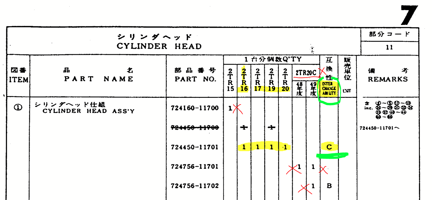

YM1500 is the same Eng. as the YM1600 2Cyl. @ 15HP. Air filter AF-6022M

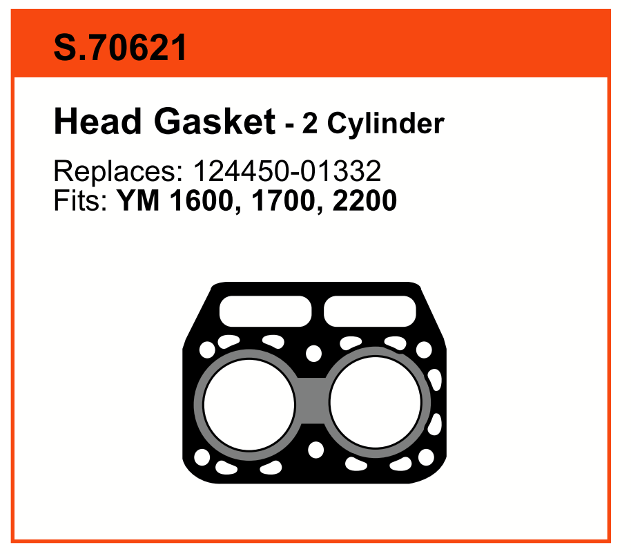

The YM1600 isn't listed very much even for me. Same Clutch Disc. # CD-4115 Fredricks. I think your going to need a Head Gasket from the looks of the Pic..

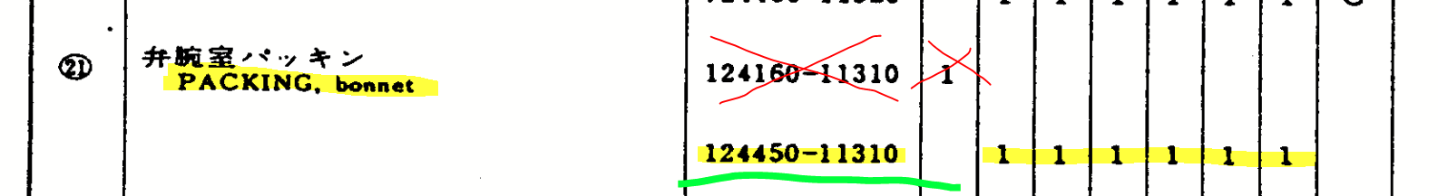

The Valve cover Gasket for the YM-1500 "ONLY" VCG-4160.
The # VCG-1310 YM1502,1510, 1601,1602,1610 Which is a 3cyl.
Be careful on the H. Gasket It's a # HG-160 for the YM1500 "But" the YM-1600 is listed HG-1700
It's also showing to be the same and for the YM-1700 also.

NOTE: There are 2 Head designs.
YM1600 only interchanges the head with the YM1700, YM1900 and early YM2000 engines. The YM2000 came in 3 generations, so it is risky getting a head off of one.

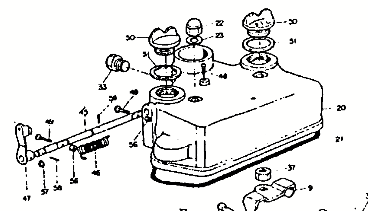

Luckily, I have the head. It's just not in the image. All I'm missing is the valve cover and the exhaust.

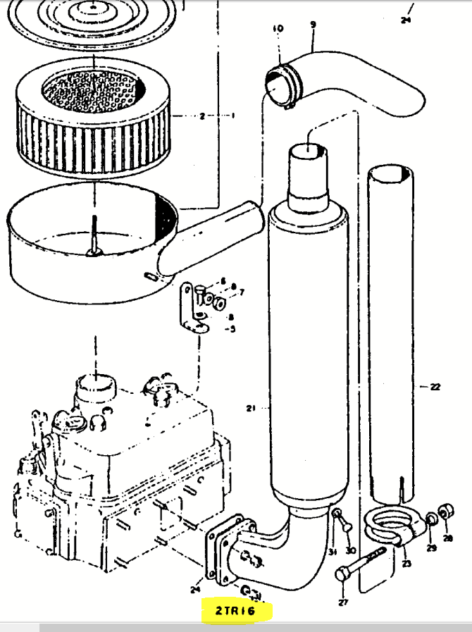

item-21
And possibly all the items that attach.
The rod-link is the DECOMPRESSION lever.

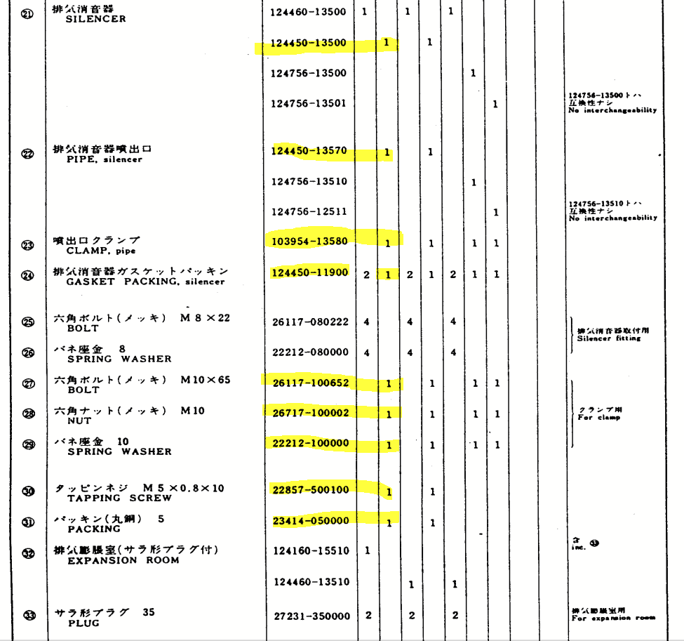

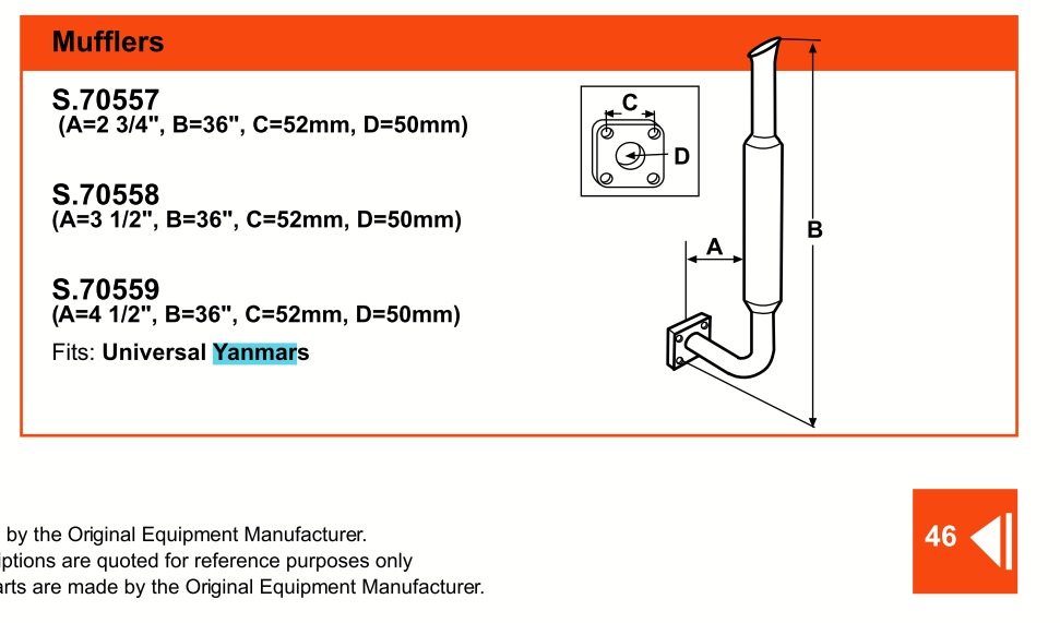

The exhaust setup,
   / I need help finding Yanmar 1600 parts. Valve cover and exaust #9
shhh, I think it will post here,
  • YANMAR ENGINE 2TR15 2TR16 2TR17 2TR19 2TR20 2TR20C 2ND.pdf
   / I need help finding Yanmar 1600 parts. Valve cover and exaust #10
Most all of the parts places get the SAME exhaust to sell from SpareX.
The A dimension is the CRITICAL part on how to mount and then move away from the tractor and hood.
