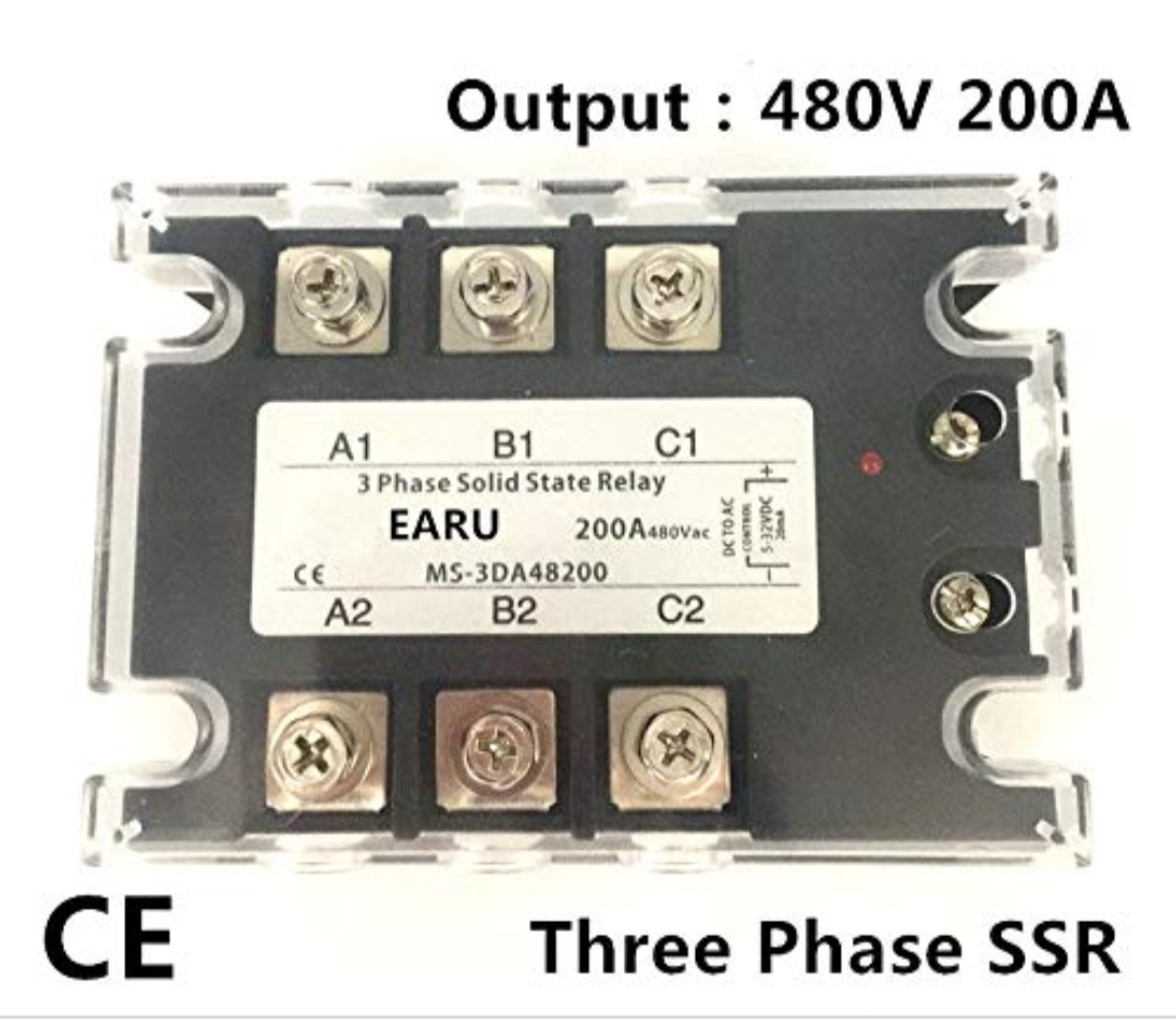

Have you ever seen a #phase solid state relay? Not likely, 'cause they would never unlatch! ;-)
I have several. They're just 3 triacs in a case with a single input.
Internet example:
