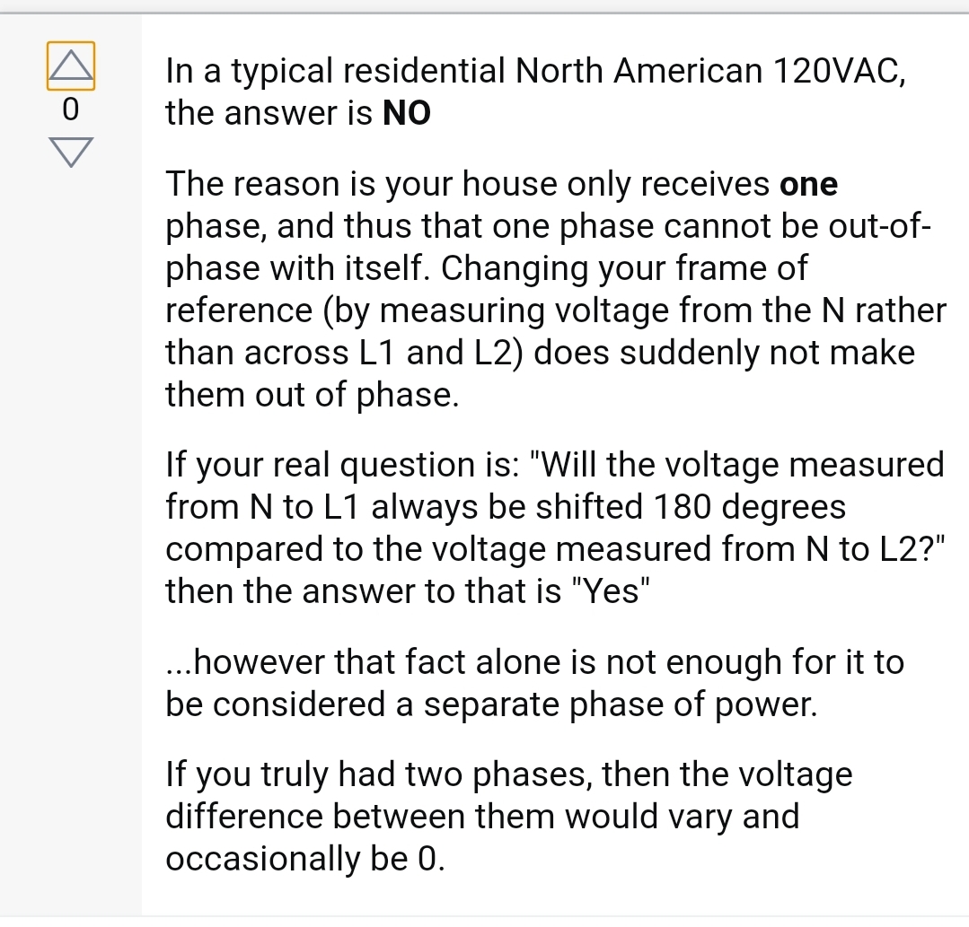

All of these examples are not describing the output from a center tap transformer. The key to understanding this is to study how it operates and the waveforms produced. It's single phase and L1 and L2 in relationship ONLY to each other are 180 degrees apart as measured to the center tap.
Well as I said transformers don't break the laws of physics. For some reason when we talk about transformers, all the sudden it's ok to insist that waves adding up to double amplitude are polar opposites of each other. But deciding the words we to use to describe its outputs is the extent of the transformer's magic. It is bound by the cosmos to keep outputting two waves in phase with each other, no matter what we say or where we connect our ground clips (that is, until one of us blows a fuse).

I can't believe that the answer with the most upvotes was a toddler's crayon drawing, yet again someone with no concept of RMS voltage showing peaks and valleys of +/- 120V. There were so many better answers. This one was my favorite.
The interaction of water and sound waves in the same plane is not the same as a direct comparison to the output of a center tap transformer. You can generate electric sine waves on same wire (plane) and the waves will interact but this is not what's happening here. It's sine waves being generated on the separate sides of the center tap on the secondary coil of a transformer.
You are correct about one thing. Connect L1 and L2 directly together they will definitely cancel each other out. It's a good thing they are connected through a load.
Did you watch my video? I connected two (separate) transformer secondaries in the same configuration as a single split phase secondary, out of phase with each other and result was (N-L1: 120V, N-L2: 120V, L1-L2: 0V). I then connected them in phase, and L1-L2 went to 240V.

They are related. On a house split phase L1 and L2 120v are 180 degrees opposite and 240v difference. Substitute 2 of 3 phases of 120v generator that's 120 degrees apart the the voltage differential between L1 and L2 goes to 208 because the waves are shifted.
