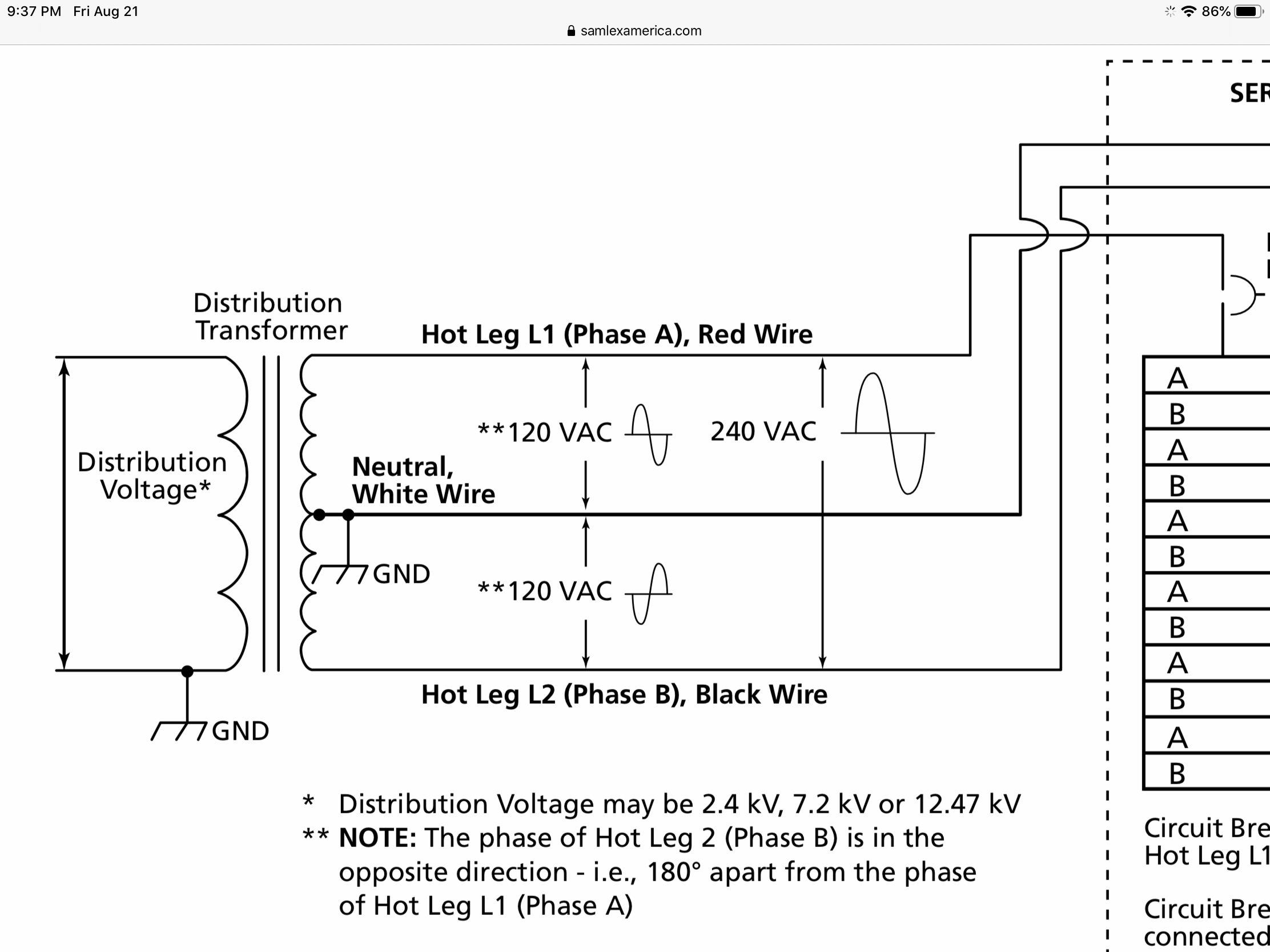

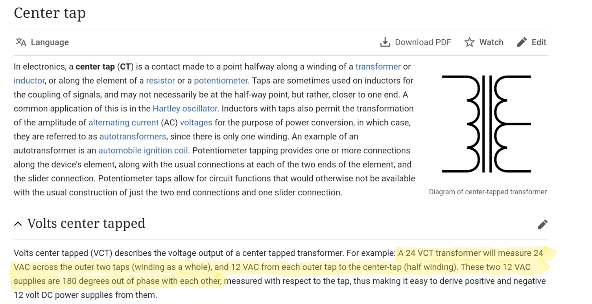

Center tap transformer example

I beg to differ on the 120/240 being out of phase. AGAIN, someone confuses the issue. If they were 180 degrees out of phase, they would cancel each other out. They are simply different taps, or windings, on a single phase.
Or am I totally misinformed? I'm not an electrical engineer and this stuff, the math, has never been my strong point.
Single phase IS single phase. Not suddently two phases! Not on a generator and not in your house panel.
Look at the sine wave coming out of the top of the center transformer. It's rising.
Look at the sine wave coming out of the bottom of the center transformer. It's falling.
They rise and fall towards and away from each other at the same speed.
So when the top one peaks at +120, the bottom one valleys at -120.
That's how you get your 240V difference.
If the 120v legs were in phase, they'd be rising and falling at the same time. They'd never be 240v apart. They'd be overlapping legs.
They are 180 degrees out of phase to each other. ;)

Out of phase:
If L1 is going up while L2 is going down. When they reach +120 and -120, they are 240 apart.
In phase:
If L1 is going up while L2 is going up, L1 would reach +120 when L2 hit 0 and L2 would hit -120 when L1 hit 0. They could never get 240 apart if they were in phase.
Make sense?
