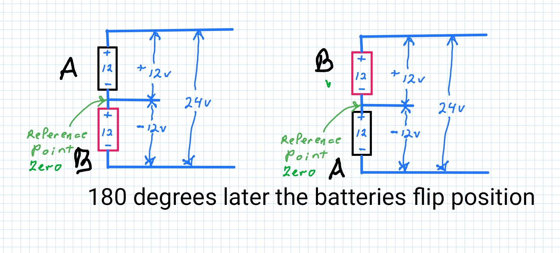

Here is a DC model. Voltage inversion of the outputs is a known characteristic of center tap transformers and one can't rewrite the laws of physics. Better to look up how they operate than for me to explain.
   / I need help understanding AC electricity and generators (1/3 phase) #53
DC 180 degrees later
For your DC examples I would question the assertion that the batteries flip position, and instead suggest that they flip polarity (in unison) - for an AC equivalent.
   / I need help understanding AC electricity and generators (1/3 phase) #56
You are correct. The polarity flipped and the sources remain constant.

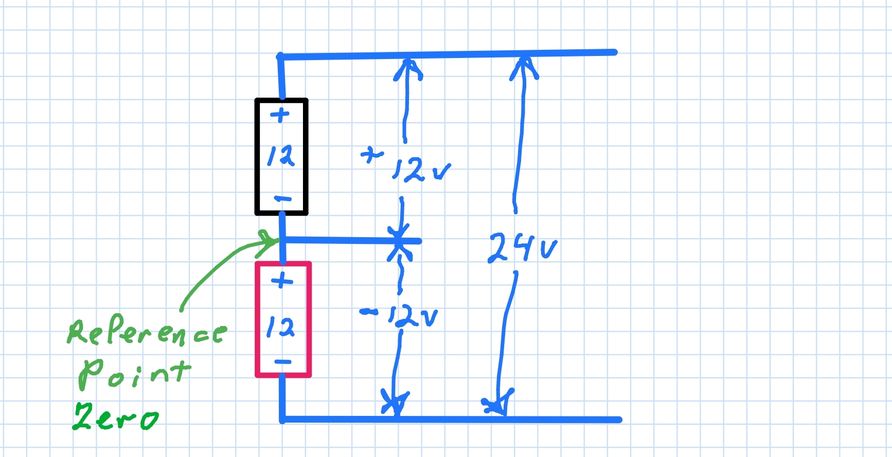

So any measurement referenced from a point other than ground, is invalid? If that's the case then any measurement of 240V is invalid. It is not possible to measure 240V from ground.
Your battery analogy is incorrect because both batteries are always positive on their positive terminal. L1 is negative when L2 is positive. L1 and L2 always have N in the middle. You can not parallel L1 and L2, they are hard wired in series.
I thought I did a pretty good job of proving that the battery analogy is correct, by actually performing the DC experiments (on video), followed up by performing all the exact same experiments with AC (on video) and demonstrating that the results are precisely equivalent.
As you said, they are hard wired in series. The same current is flowing from one end to the other. The only thing that's reversed is your measurement, because you are measuring from the center tap of the transformer. you're measuring forward from center tap to L2, and you're measuring backward from center tap to L1. Your backward measurement yields an apparent phase reversal.

Try this thought experiment:
If the residential mains were grounded at L1 instead of at the center tap, what would that look like?
(disregard the topic of neutral for a minute and assume no connected loads)
Gnd (L1) to center tap would be 120V
Gnd (L1) to L2 would be 240V.
Gnd (L1) to center tap would be in phase with Gnd (L1) to L2
Center tap to L2 would be in phase with Gnd (L1) to L2
All would be in phase.
Because all ARE in phase.
Changing the grounding point does not reverse polarity of the half the transformer.
In a center-tap-grounded circuit, the only reason that measurements of GND to L1 appear to be reversed polarity with respect to GND to L2, is because the measurement device is connected in reversed polarity with respect to the measurement taken from GND to L2. It is a measurement error, not an actual phase reversal. If it were an actual phase reversal (which is impossible because as you said "L1 and L2, they are hard wired in series"), then L1 - L2 would equal 0V, as I proved in my video.
